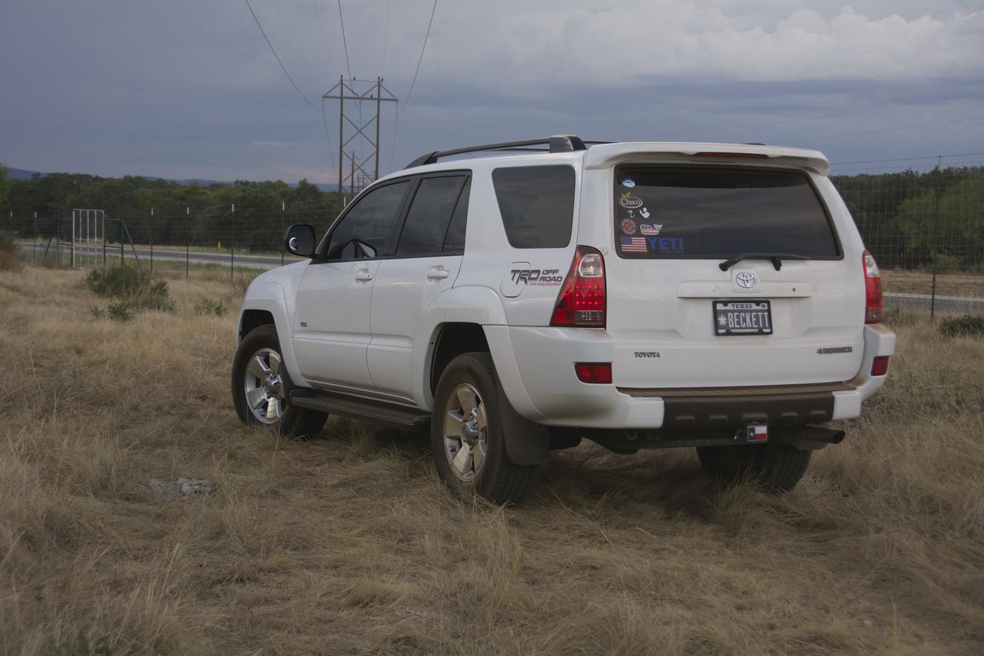

9/6/14

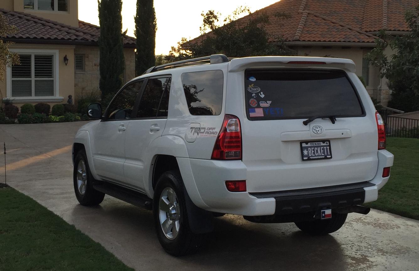

11/1/14 (Current)
Was rushed out of the house so I wasn't able to fully finish. As it sits now, suspension is to stock, engine is stock (exception of HCF delete), LED interior lighting, custom FJ shift knob by [MENTION=64685]TOY2G[/MENTION] , wheatear tech mats (life saver), and a few small things.

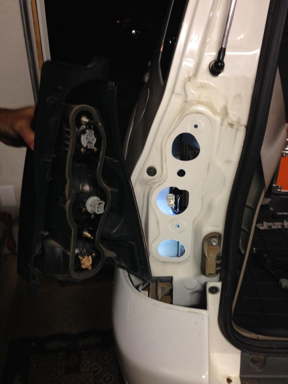

Last night my dad and I attempted to replace the tail lights with LED tail lights and well... it didn't turn out the way as planned.
First off it took us a good while to get the top nut loosened and off so that we could remove the old tail light. When we hooked the new LED tail light (NOT OEM may I add), everything worked fine... except the reverse light. We made sure the wiring was correct, the light fixture had a good connection, and a few more things and we figured the reverse lights were out.
This was on the left light we tried. We hooked up the LED right tail light using the lefts cable and same result. Everything worked fine except the reverse lights.
We finally decided that the best bet was to put the old tail light back in so that I could drive it to school legally today, well... the brake light on the original tail light went out. We have no clue how, but the bulb was burnt on the inside.
I am trying to get a hold of goparts.com to see if I can return them, I'm predicting that won't turn out very well.

You have to twist the coupler into place to get the reverse lights to work.
I see you're in Austin, I'm not too far from you. If you guys ever get into a jam, look me up. I have a 1st and 4th gen, and done quite a bit of work to both. Happy to help you out or share my experiences.
We tried the coupler and that also didn't work. We are figuring out what to do, probably have a plan of action by the weekend. I'm hoping we can try it again but if they don't work, they don't work.

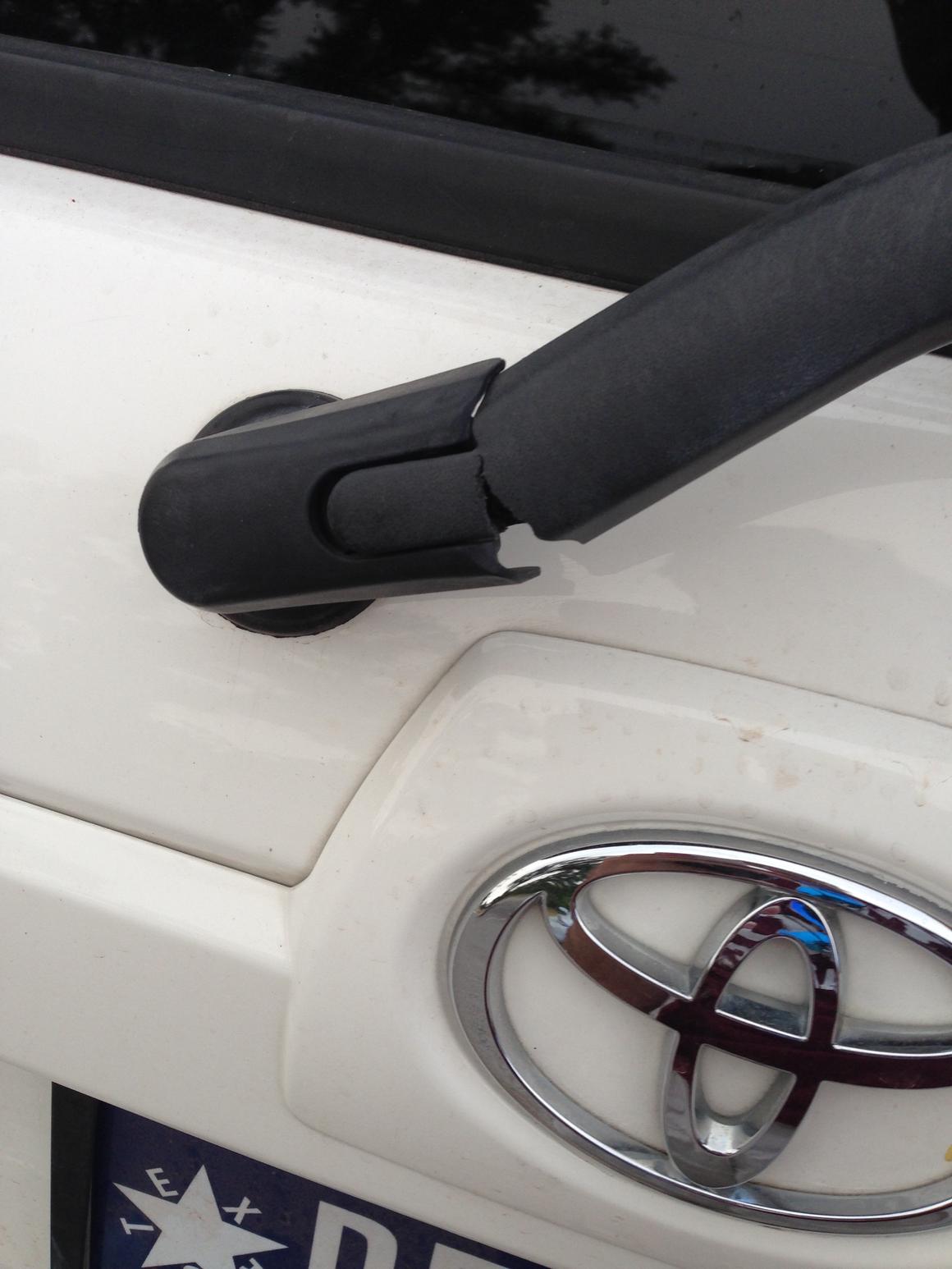

Also, when I put my bag into my trunk, the back window was rolled down and it caught into the rear wiper. Not knowing this, I rolled up the window. I heard a thud but though nothing of it. This is what happened.
I ordered a replacement, should be here by Tuesday.

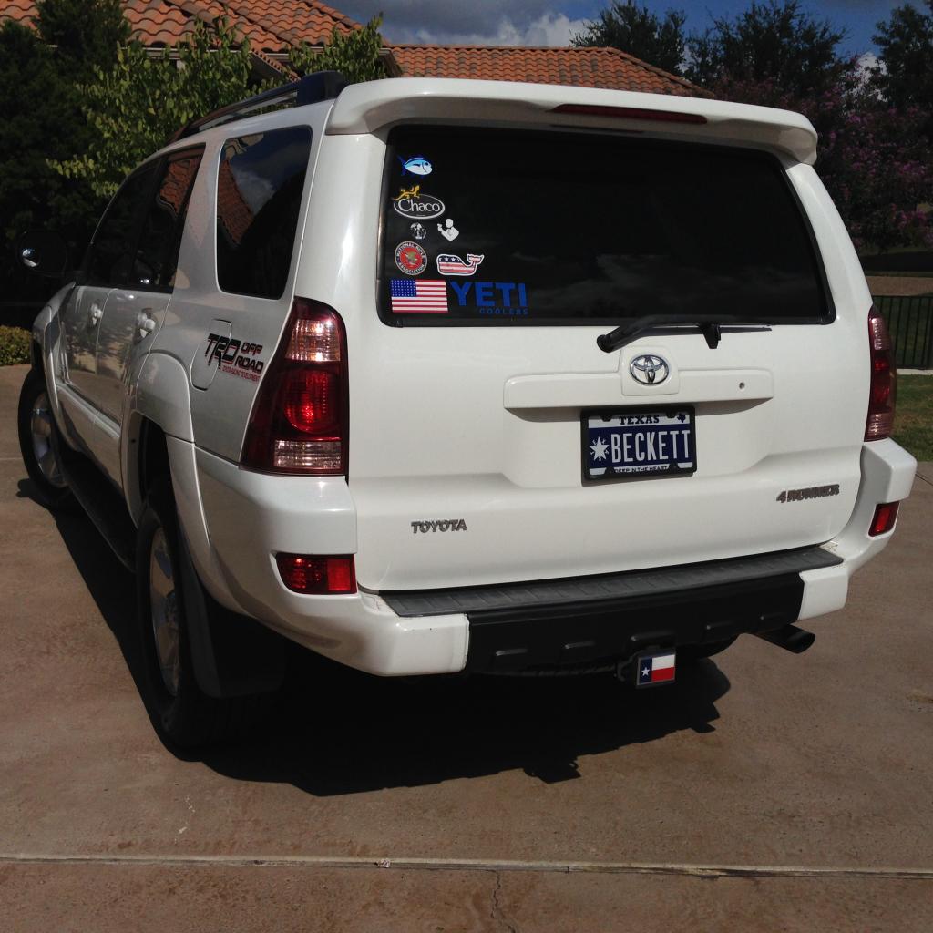

Worked on it for about 4 hours this morning and well, I kinda feel like and idiot, but at the same time great.

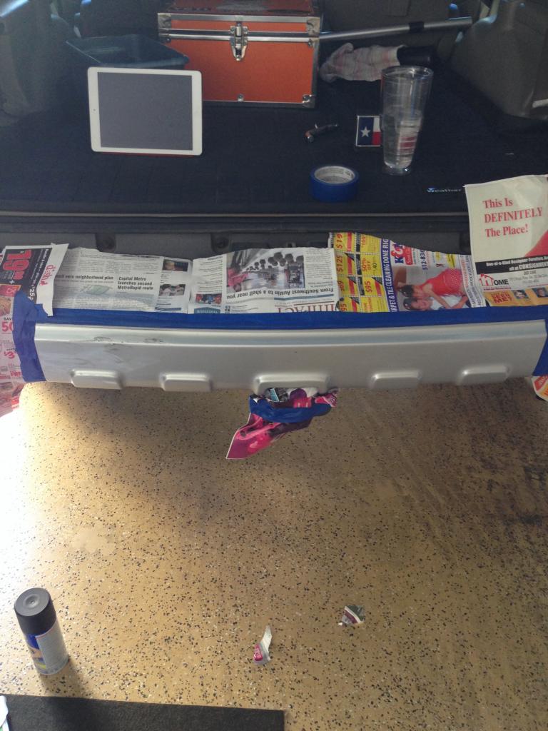

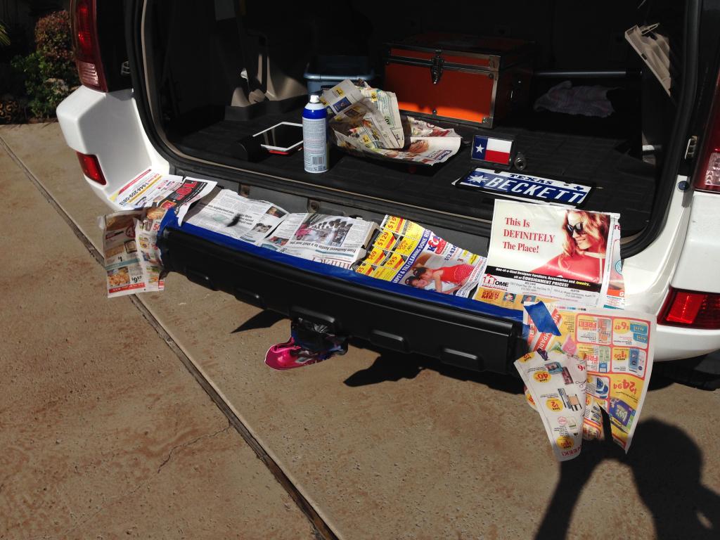

First I plasti-dipped the front and rear bumpers that are silver accented. The silver was driving me crazy! I love the look of the black bumpers instead of the out of place silver.
Also I worked to see if I could get my aftermarket 06-09 LED tail lights I got a week ago. I discovered that the bracket for the reverse lights (which were the lights giving me trouble) would not connect to the power if I turned them all the way to the right and locked them. I had to fudge it a bit and sure enough I got them to work.
The other problem was that I didn't have a deep socket 10mm wrench nut to get to the top bolt to take off the old tails. After about 45 minutes of failed attempts by making make-shift wrenches, I went out to Home Depot and bought one for $1.98. UGH

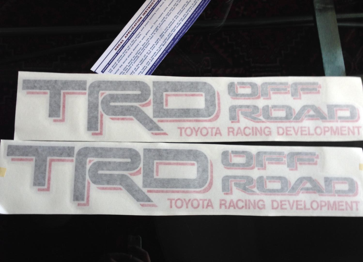

I also installed TRD off-road decals yesterday and they came out pretty well.

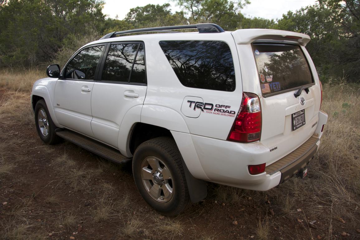

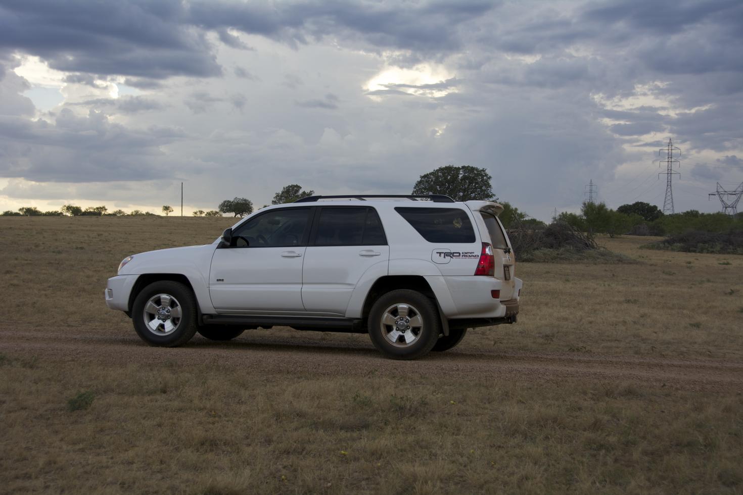

Did some off-roading on the ranch. Wished it rain so I could go around in mud.

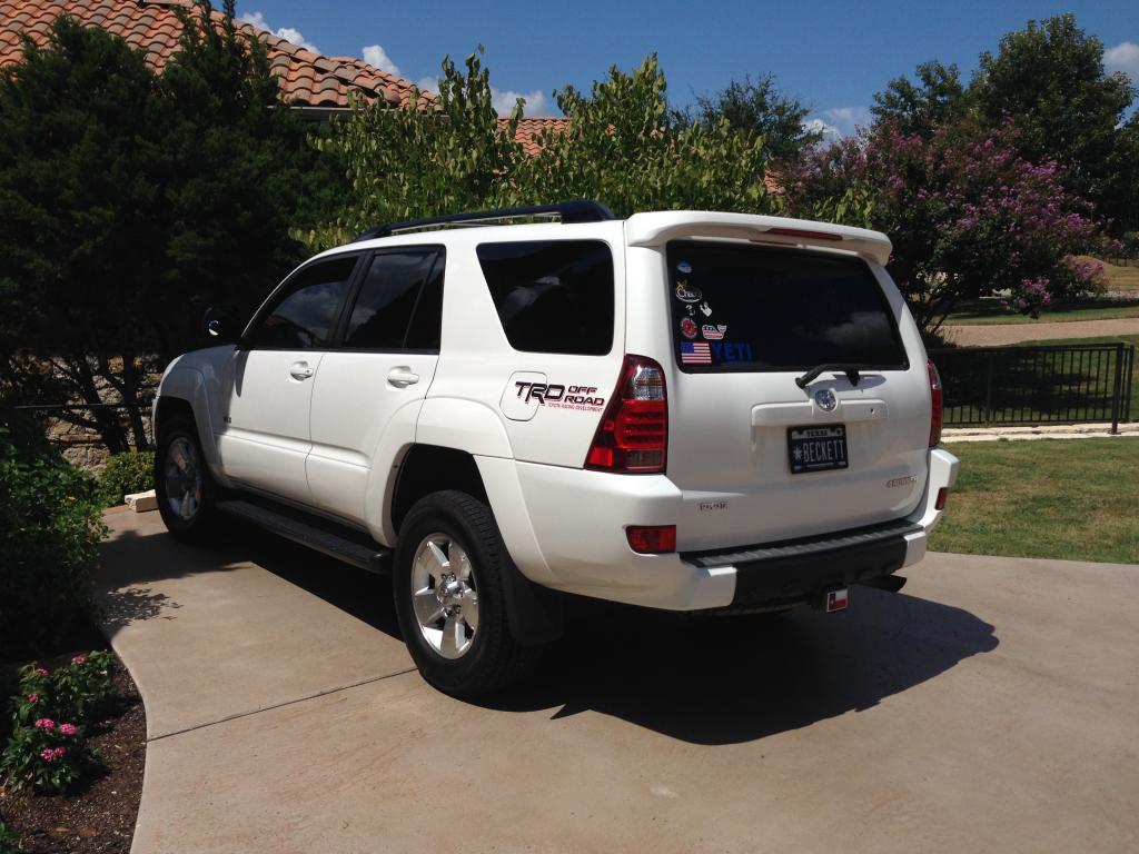

Finally found some time to update the build.
De-badged the runner this past weekend and it turned out great, took about 45 minutes to do all the badges and being careful about it.

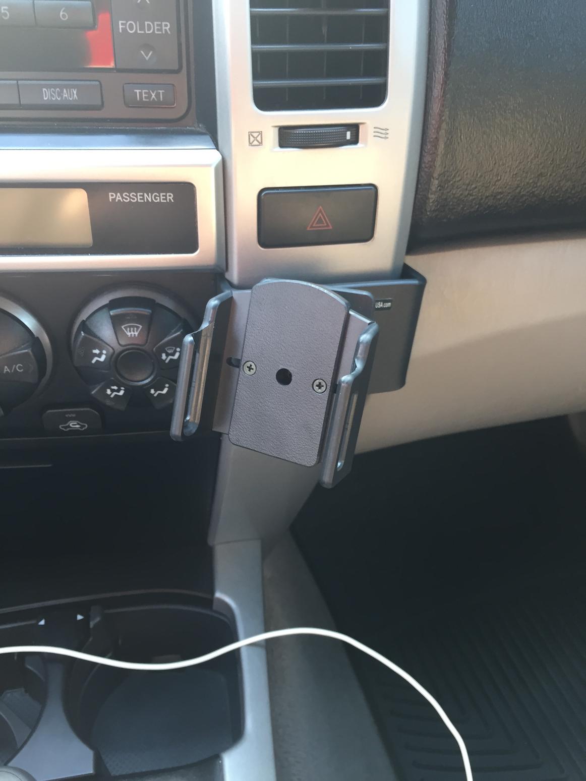

I never came around to posting a pic of the ProClip mount I got in my 4runner, I will definitely post it. It is a great product! I have the iPhone 6 mount on pre-order so any day now.

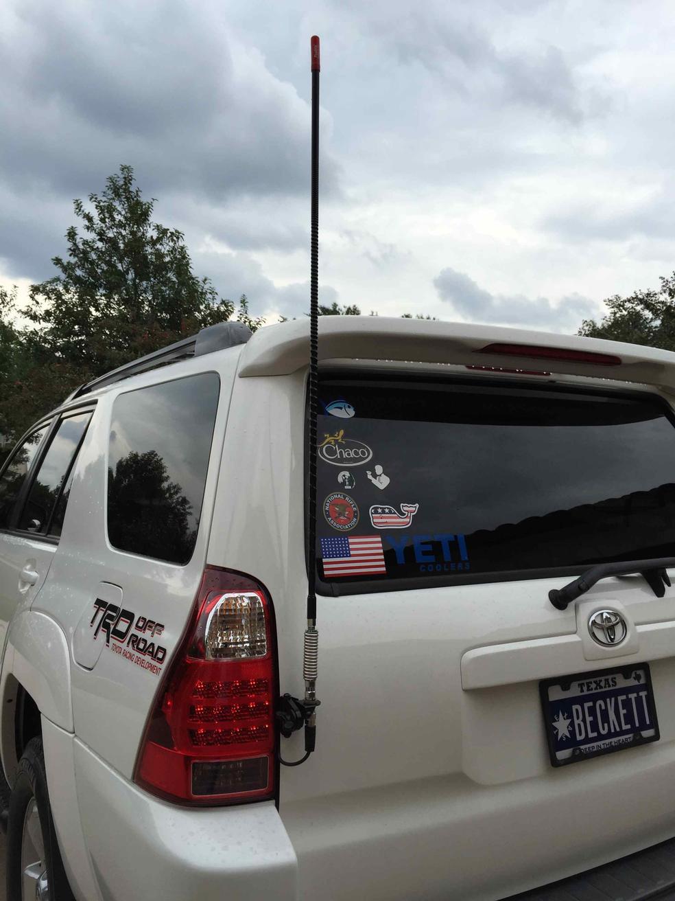

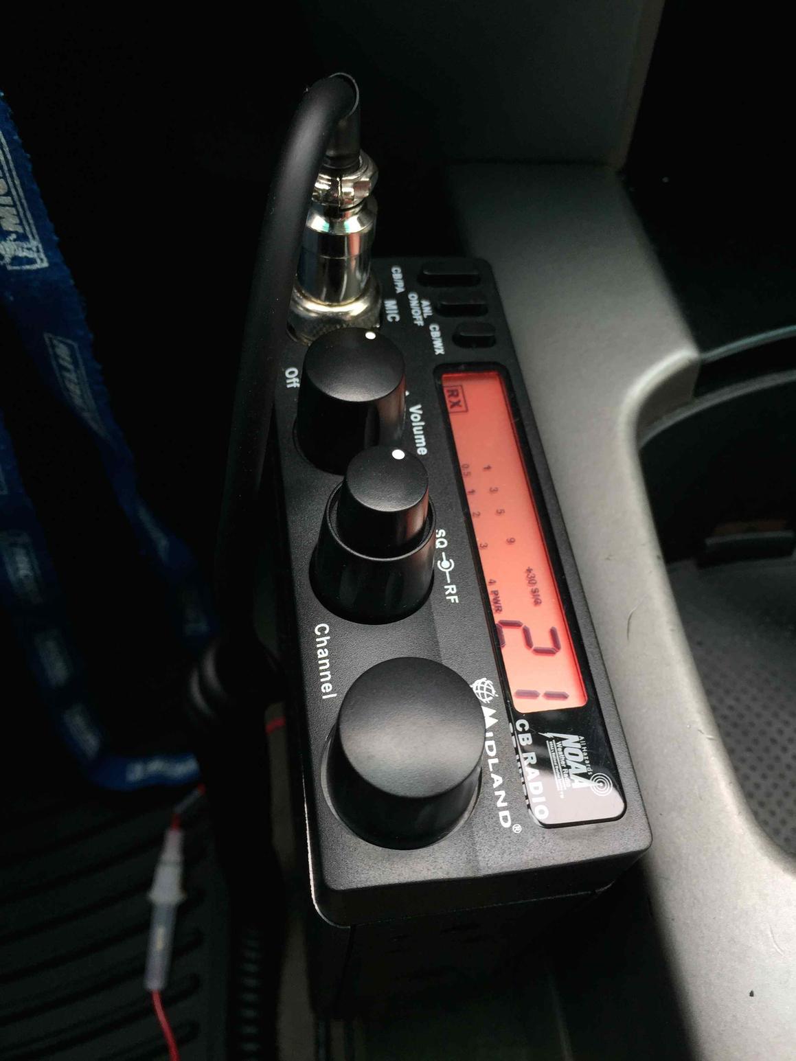

I FINALLY got the CB setup all settled and working and I couldn't be happier!
Got the right RS-720 mount from American Radio Supply today and I'm really happy with their customer service!
The CB itself is mounted to the side of my center console by velcro. Used a fuse tap for power and grounded it by loosening the bolt that holds down the drivers seat, putting it underneath, and tightened it down again.
The Midland 1001WLX sounds good for a built in speaker and the weather band is going to come in so handy when I can't look at my phone for weather updates when I drive.
I will probably do a write up on the entire install, just got to put the car back together.
