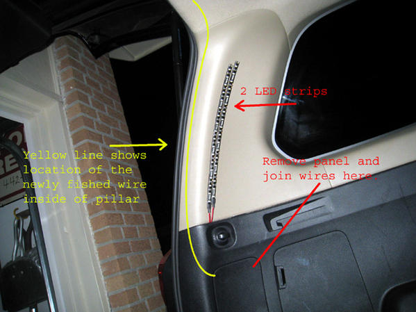

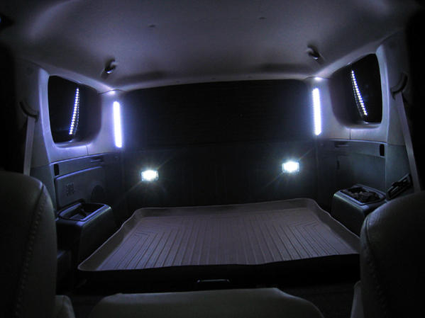

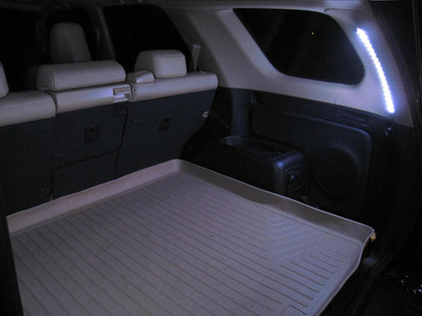

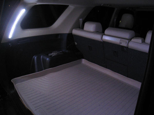

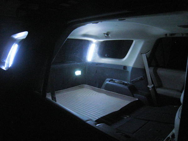

OK, I finally did this mod the right way. The LED strips are on the rear pillars and they now come on when I open the rear lift gate. They do not come on when I open any other doors to the vehicle. Here are some pics of it, but it looks SO much better in real life. After these pics I am going to break it down, so wait before commenting until you see my next post. Thanks and enjoy!

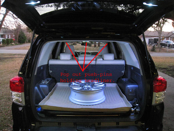

2--Remove three clips on rear of headliner and remove panels that cover access to tail lights on inside of cargo area.

4--Stick two LED strips on each rear pillar as pictured, leaving just a tiny bit of wire exposed, with the rest of it fished into the tail light access area.
5--Conjoin the wires with the one you fished down the pillar and tie them off somewhere in there using plastic ties.
6--Do the same on the right side.

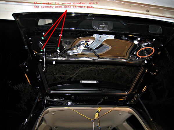

7--Pop out each of the two rear lift gate interior lights using a small putty knife on the LEFT side of each one of them. Then, unplug them and set them aside.

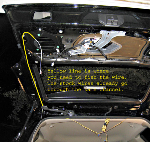

8--Make sure your rear lift gate window is DOWN. Remove the rear lift gate paneling. This pops off just like most plastic door panels. It has about 6 or 8 plastic pins that will pop right out if you can get a putty knife in there, or use a panel remover. The top of the panel hangs on the edge of the window opening. FYI, the speakers ARE NOT connected in any way to the panel itself or the speaker grates.
9--Unplug the left speaker connector. Remove the left speaker using a 10mm socket. Just undo the three nuts that are right around the edge. You don’t need to remove the whole plate that holds the speaker. The first time your remove it, it feels like it is glued, but it is actually not—it is just a piece of padding that is between the metal and the speaker rim.

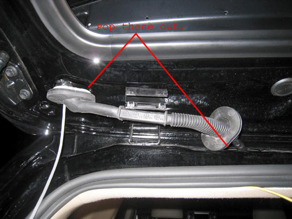

10--Pop out the rubber tubes that protect the wires coming from the gate door to the roof of the car. See image.
11--Fish a wire from the speaker hole opening down to the hole where the rubber tube was connected at the lift gate. This is tricky! Do not use a regular household wire fish that you buy at the hardware. It is too big and too stiff. Instead, try using a ground wire from your household-type wiring. It is rigid enough to fish through, but bendable enough to get it pointed in the right direction.
12--Once you have that wire fished through, tape on your dual wire on the lower end, and then carefully pull the wires back through.

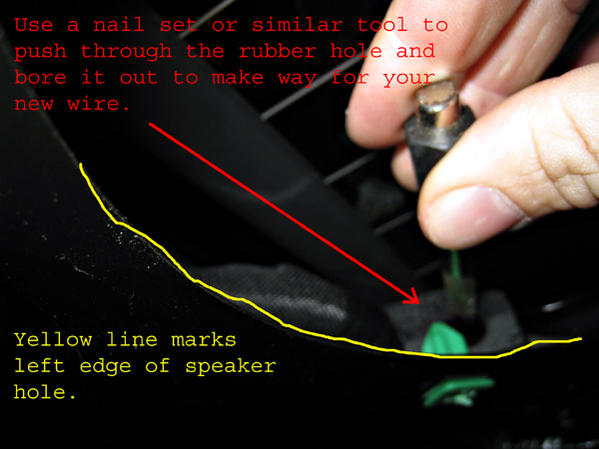

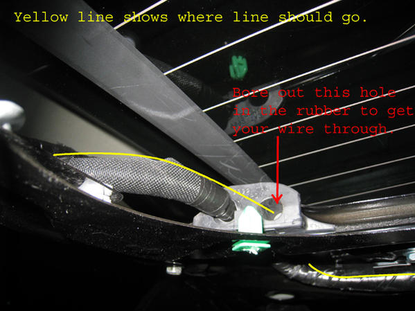

13--To get the wire from the speaker hole to the left interior light location, you can use a blank spot in the rubber connector, but you have to bore it out. I used a nail set tool to bore it out.

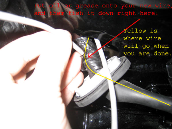

14--Once it is bored out, put some oil onto your LED wire and push it through.

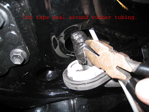

15--Now you need to fish the dual wire down the rubber tubing to get it into the headliner area of the vehicle. It is buttoned up pretty good on the lift gate side, so I had to use a pair of wire snips to cut a tiny hole in it to get the new wire in. You will need to lube up this part of the wire as well. Then, fish it through, tape back over where you put the hole in the lift gate side. See pics.
16--Push the rubber tube connectors back into their oval shaped holes.

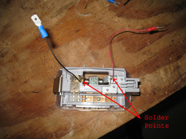

17--Take the left lift gate interior light assembly and solder two wires onto the back of it, and put connectors on them, as shown.

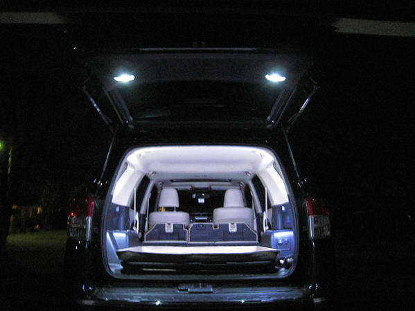

21--Now, when you open the lift gate, there is TONS of light, and you can turn if off by turning off the left light assembly on the rear lift gate panel.

Ha! I probably could! They used to be hooked up to my dome light over the second row, and it was damn near embarrassing when I had to open the door to get in and out. People thought I was trying to make my t4r into a limo. That is why I did this mod this way...it only comes on now when I open the lift gate. Even though it is quite bright, it is frekin' AWESOME to be able to see as well as I can when I am loading things back there.

There is room in the middle all of the way towards the rear of the vehicle where the headliner goes diagonally downwards toward the weatherstripping.
I would estimate about 2" between the roof and the headliner. There IS NOT room forward of that location. I had a hell of a time fishing a wire through that part.
The best way to see how much room is to pop out those three little fasteners on the back, pull it down a little bit carefully, and see for yourself. I bought a panel remover tool from Advance Auto Parts, which has been a very valuable tool for me for stuff like this.
