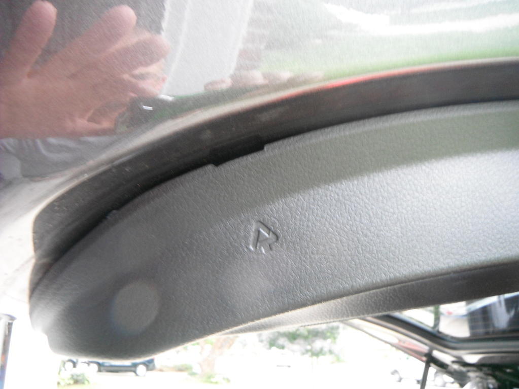

So dumb question, how hard do you have to pry the rear light plastic pieces off? I tried today but it felt like I would break it if any harder. Let me know if you have any advice or another link that would help better. Thanks

Which rear light plastic pieces? The lights in the rear hatch? You have to insert an object (like a flathead screwdriver) that can pry a small plastic latch/catch on either the inside or outside of the light (can't remember which side right now, but my gut is telling me inside) and simply apply some pressure in and down to get the light to come loose. They are in there pretty well, and I do remember having to use a bit more muscle than most other pieces, but the key is the hitting it from the correct side as they lock into place from only one side. If you hit it from the wrong side and really muscle into it you will definitely break the entire light housing.
Thanks. It's definitely from the left since that's where the indention is and what it says earlier in the post. I just really need to put some muscle into it. The other ones came out so easily I thought I was going to break the rear hatch ones. Appreciate the help and I'll see what I can break back there tomorrow.

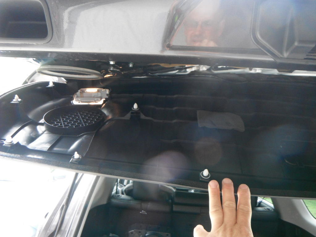

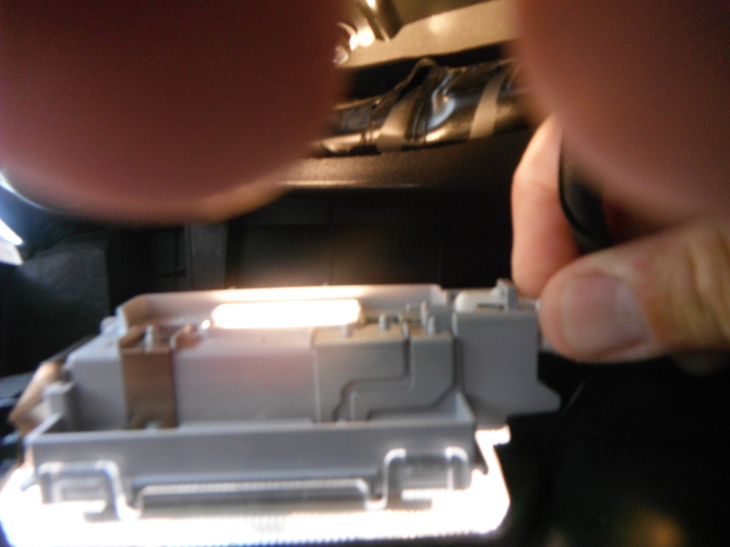

Honestly, it's way easier to just pull off the entire hatch plastic trim since you need it off anyway. Pull it out from the passenger side (you will see the slot where you start prying) and yank all the plastic pins loose. Then you can reach in there and unplug both hatch lights. Push the panel off the window channel and you have everything off.
Easy to get to those lights now.

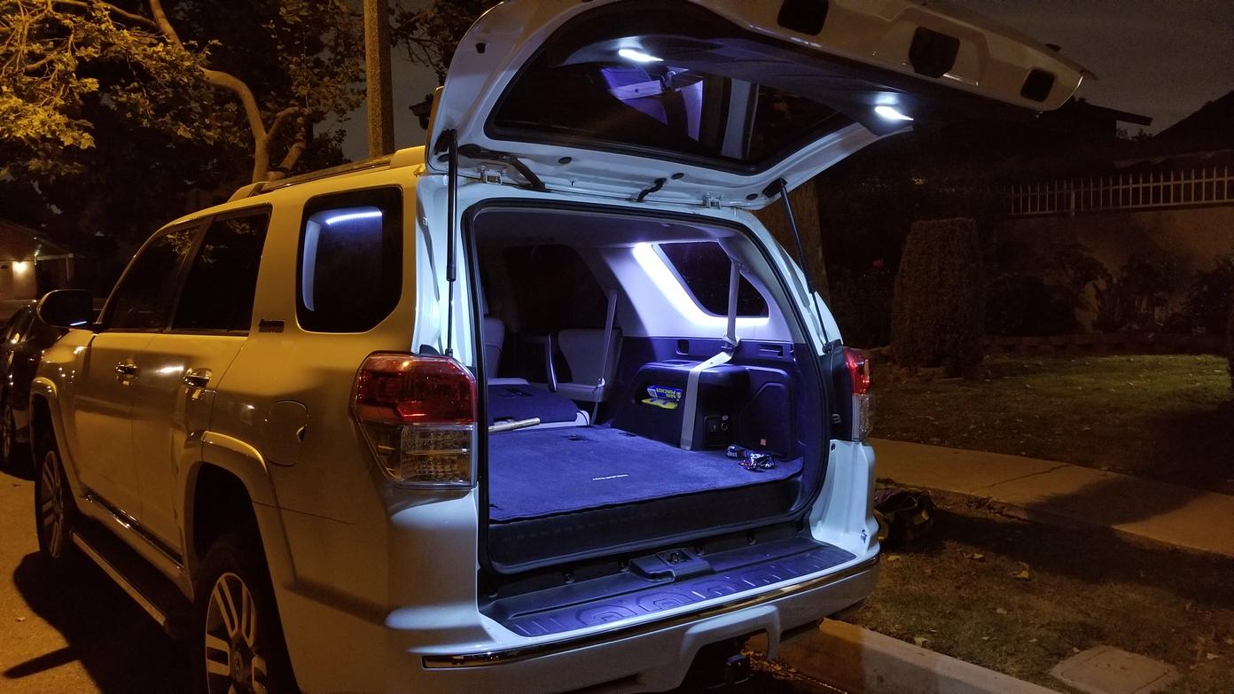

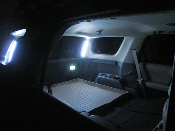

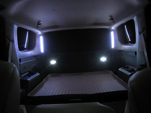

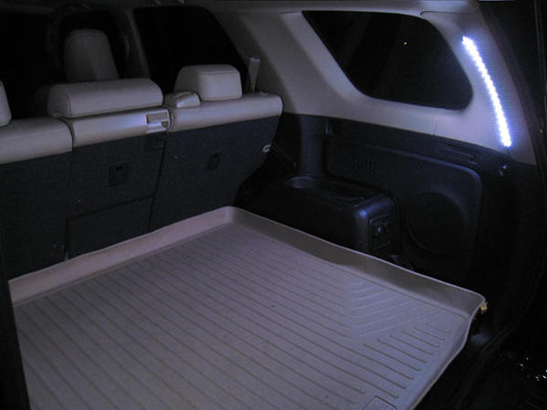

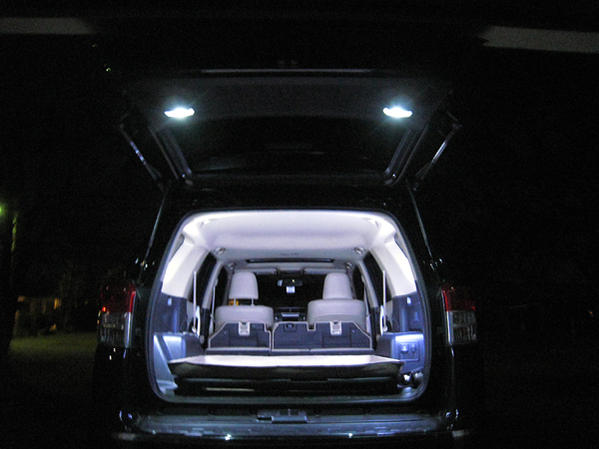

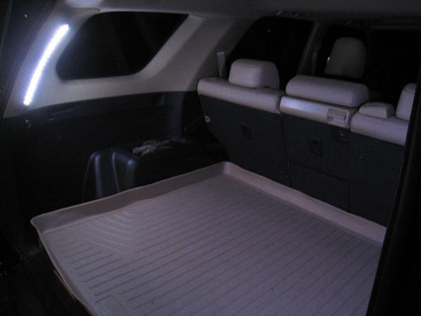

OK, I finally did this mod the right way. The LED strips are on the rear pillars and they now come on when I open the rear lift gate. They do not come on when I open any other doors to the vehicle. Here are some pics of it, but it looks SO much better in real life. After these pics I am going to break it down, so wait before commenting until you see my next post. Thanks and enjoy!
Did you purchase the hatch LEDs at Autozone too? I want some brighter lights than the factory.
Great mod. IMpressed how much light you get in there, but I"m sure you aren't surprised as it looks like you did more than your homework to make it happen. Well done!

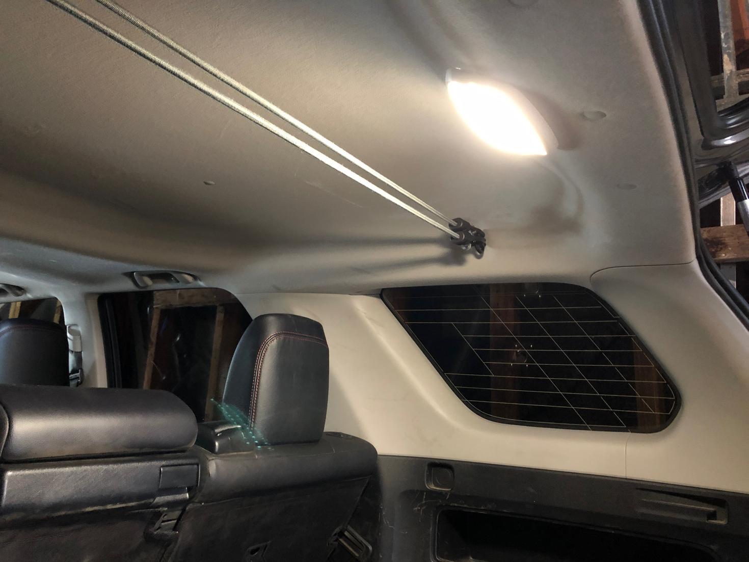

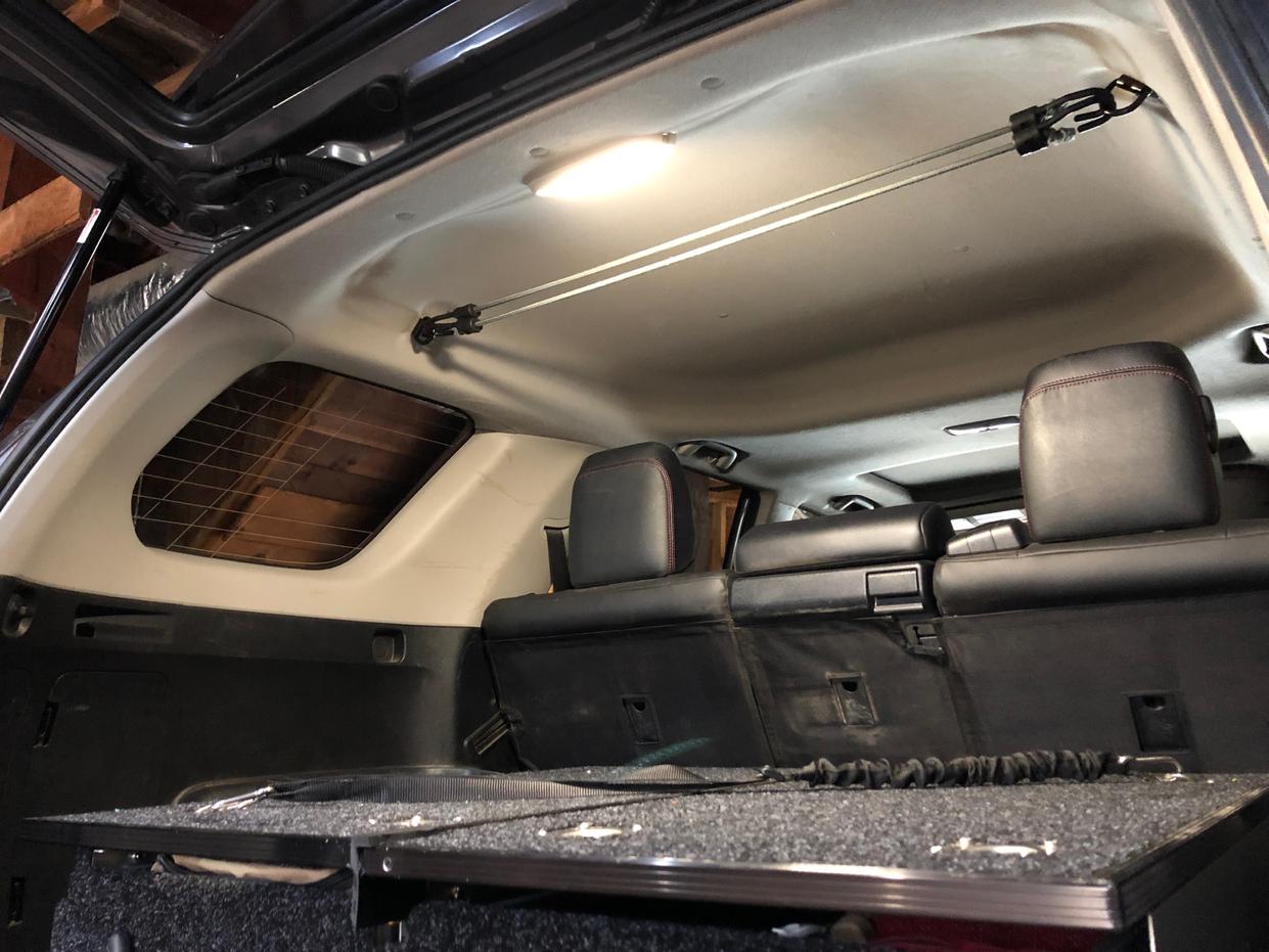

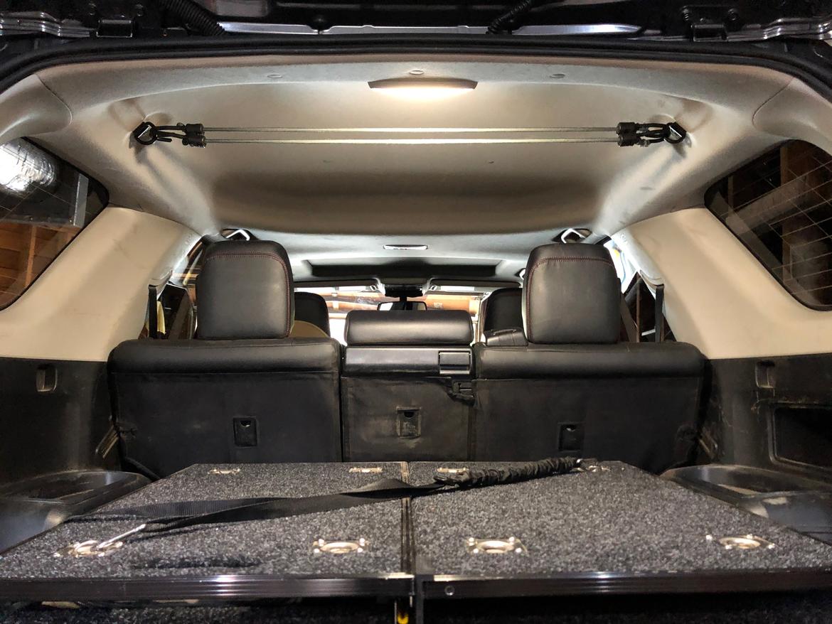

I installed a 6" dome light from Superbrightleds.com.
TDLS-NW36-G: Natural White - Gray Finish
125 lumens, not crazy but draws very little and lights up the whole cargo area.
Fits really nicely on the slanted part of the headliner. Attached it with two m4 16mm bolts. No cutting, just 3 small holes.

You did a really good, professional job. Kudos for wiring it into the module. My problem with stuff like this is popping off modling and tracking down where to hook up...
