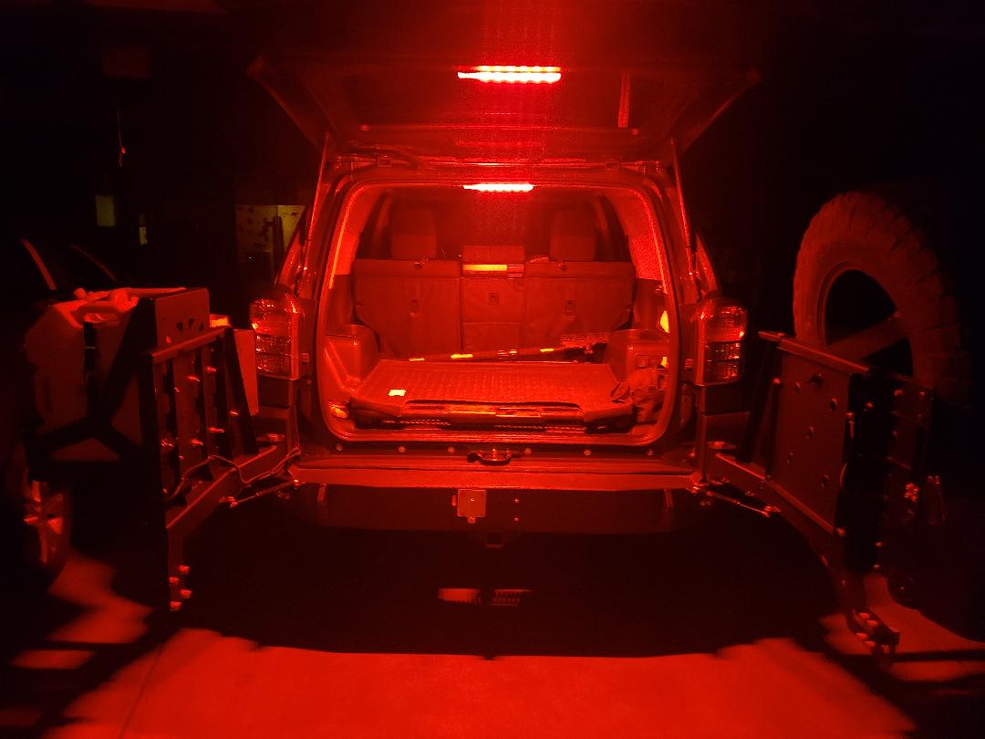

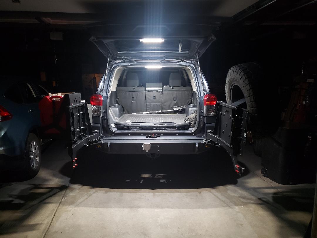

Very Nice write up! I did something similar but I used two National Luna dimming white/red touch lights. One in the cargo area and one on the hatch door to illuminate outside. The pictures are with both lights on the highest setting
