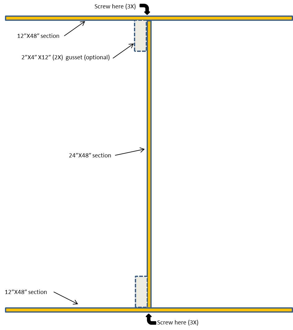

I did this for a similar reason a few years ago. It was a one time deal so I used it and then took it apart. Go to Lowes or Home Depot and get you 1/2 sheet of 3/4" plywood. Cut it down on one side to 40". That will be your length side. Cut it (or get it cut) into three sections that will have 2 sections 12" wide and the third section will be 24" wide. I used the "optional" 2X4 gussets for strength but for your use you would not have to do that. I think I spent maybe $10.00 and it worked perfectly. Here is a quick diagram and where I have "48" that would be "40" for you.:
Ya starting to think this might have to be how i go.
Dont really want to crate the guy, especially since his cage is 40"x30"
