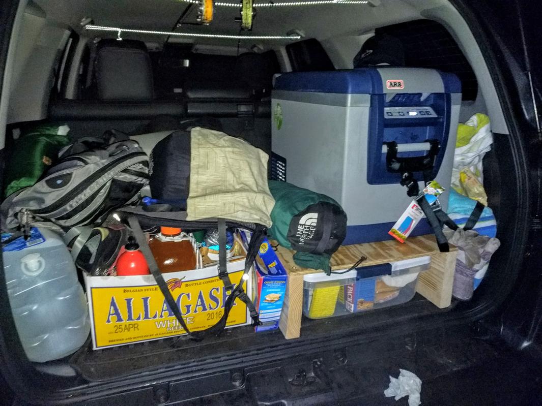

  4. Add additional storage – A fridge plus four adults with a week’s worth of gear takes practically all available space in the cabin so I needed to add a rack in phase 1 – as a bonus, the rack doubles as a sleeping platform in bear/rattlesnake country

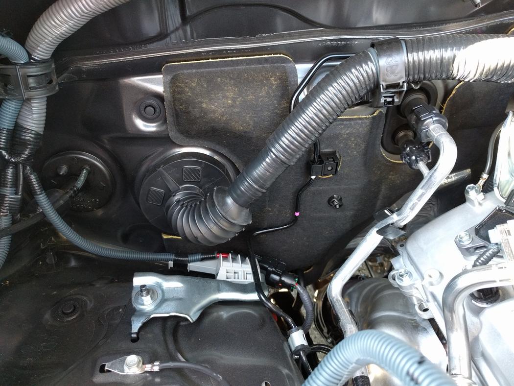

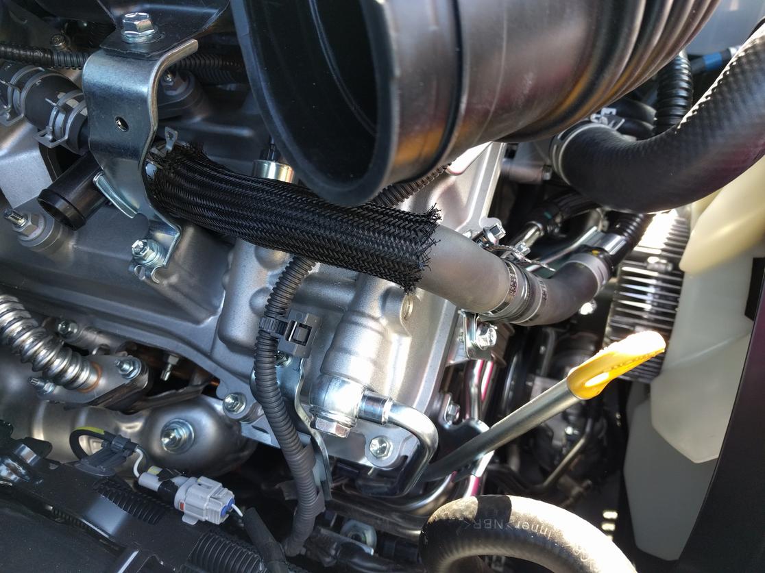

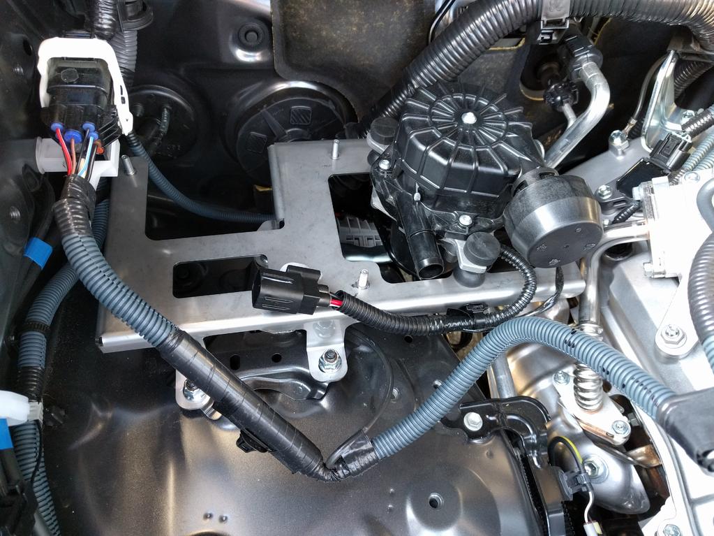

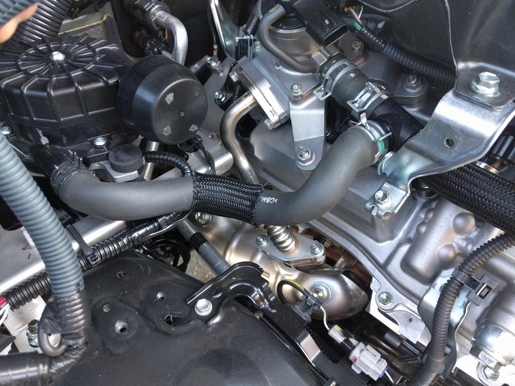

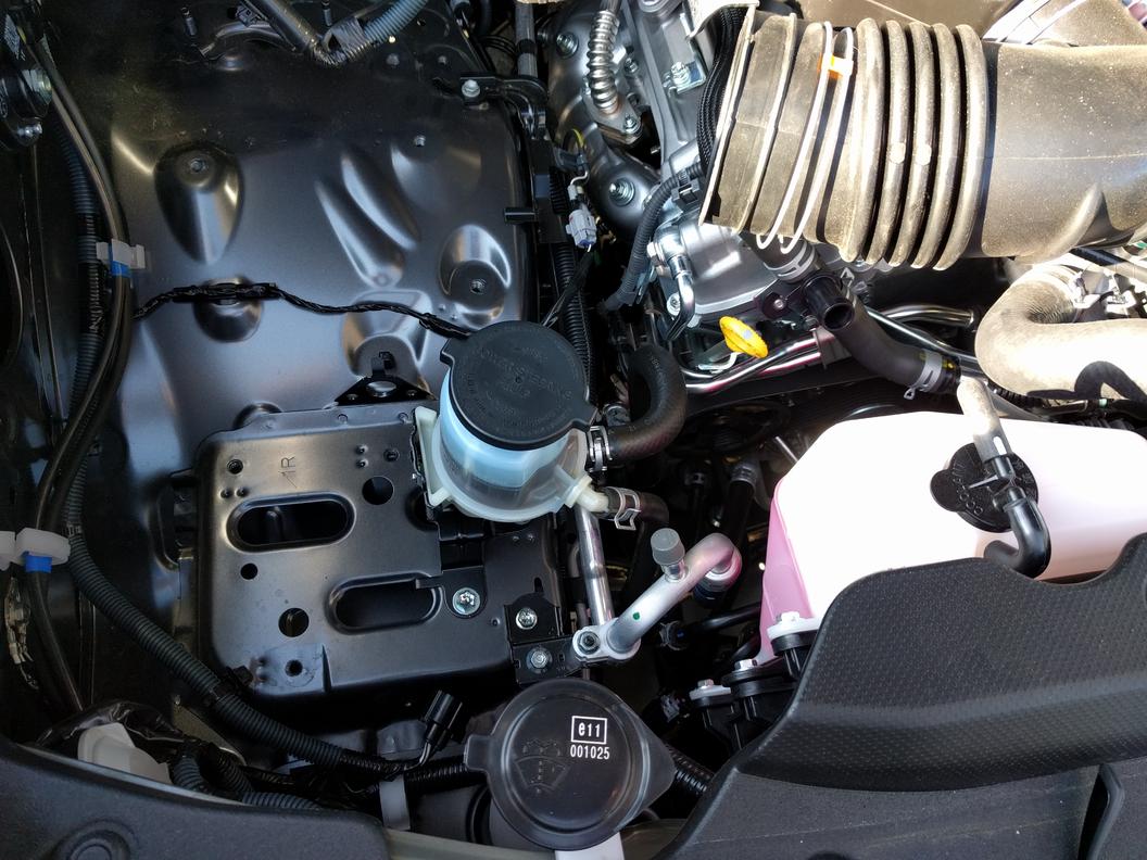

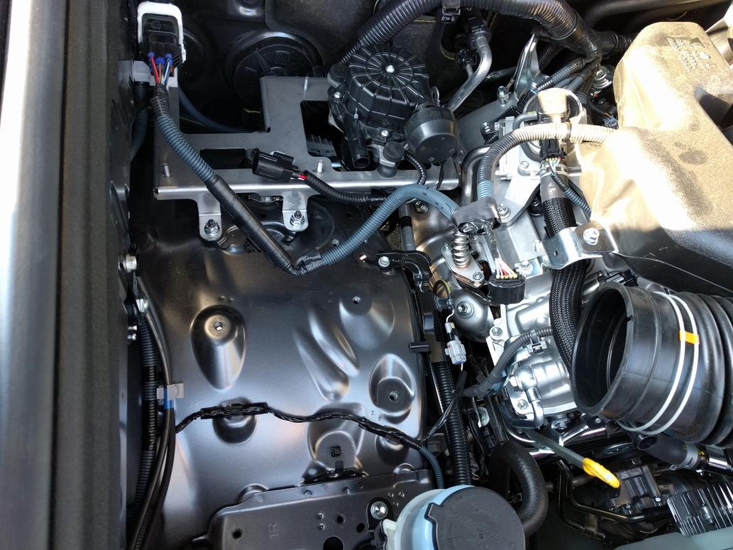

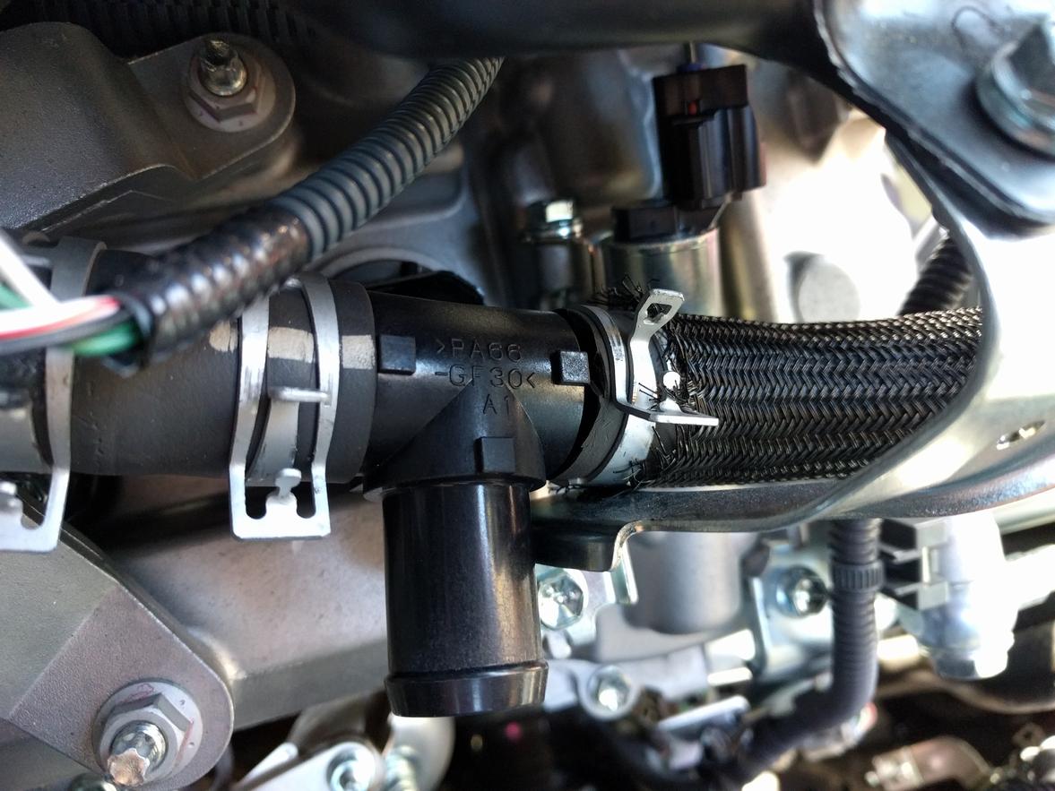

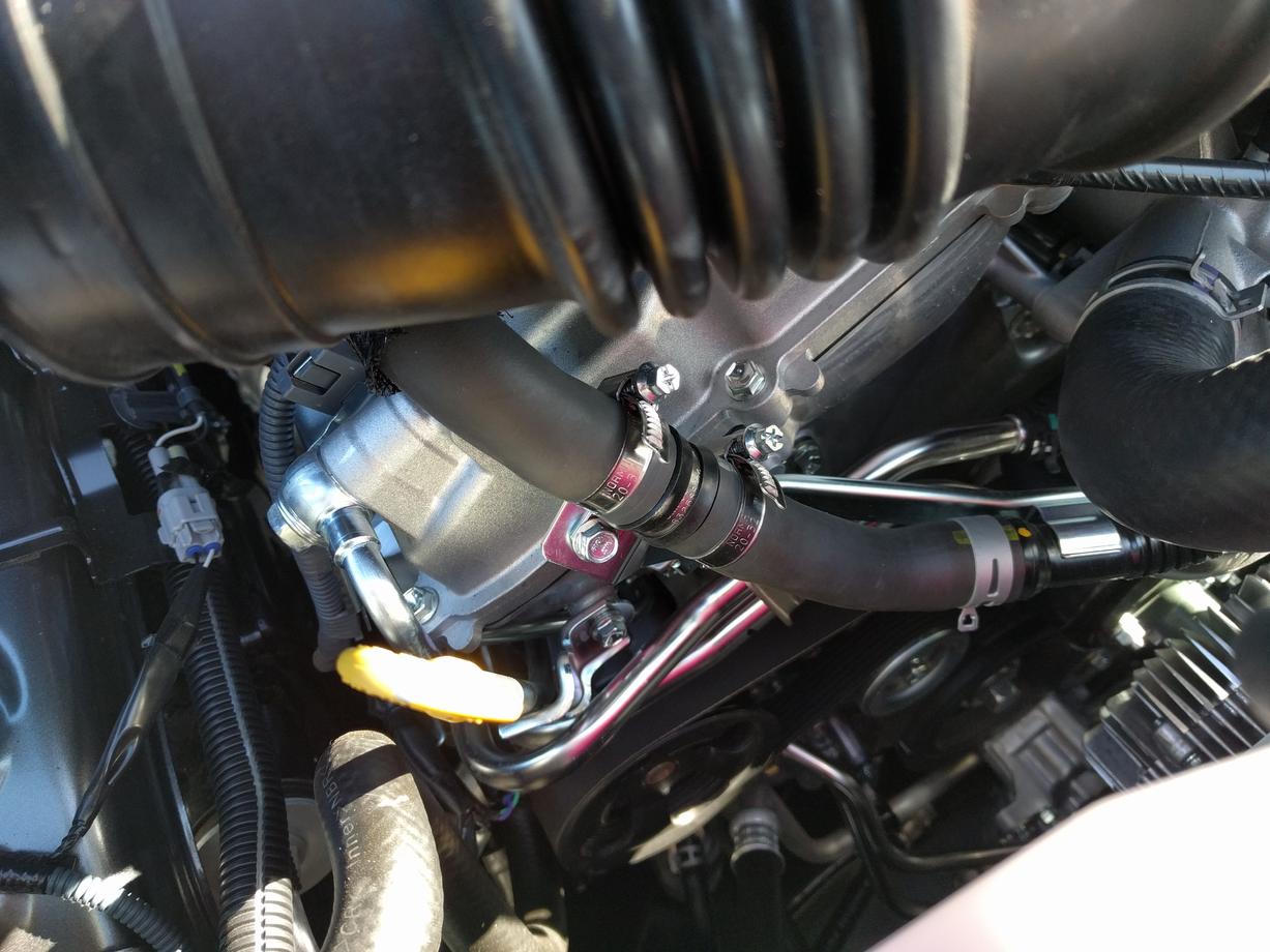

As a first step enabler for secondary power, the poorly-located factory air injection pump (AIP) had to be relocated to the rear of the engine bay by the passenger side firewall. Shrockworks offers a well-made platform with good instructions that made it easy to relocate the AIP and house an optima yellow-top behind the passenger side headlight.
These pics show the relocation of the factory air injection pump, the retrofit of the black Tee. The third pic shows the Shrockworks tray that receives the AIP in its new location. Note the threaded studs on the tray. These are (I believe) used in the FJ Cruiser application to relocate the washer fluid reservoir. I should've cut the studs off, but didn't. You may want to do so for your application if you don't plan on using them.

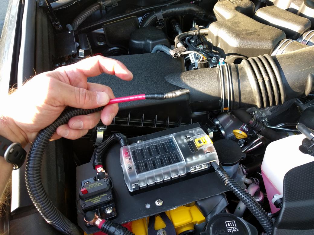

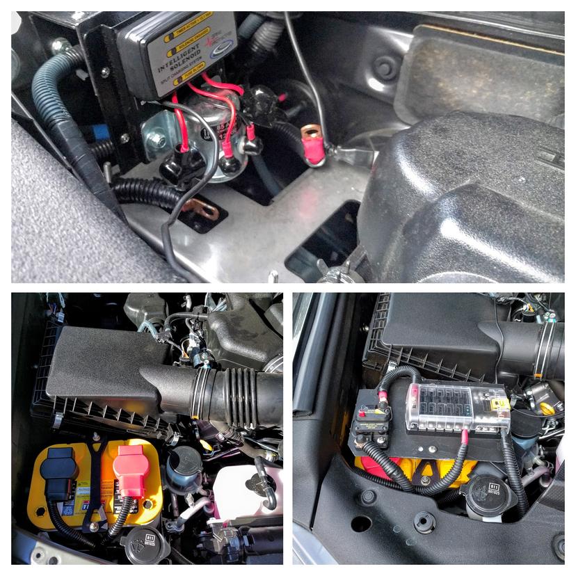

With the air injection pump out of the way it was time to drop in the battery tray and battery, fab up a bracket and wire the National Luna automatic charging relay (ACR) and fab up a secondary fuse block.
Notice that the ACR is on the passenger side near the air injection pump. I had initially put in on the driver's side right behind the factory fuse box, which is a good place, but the (excellent) Slee air compressor bracket needed to go there so I had to move the ACR over to the PS.

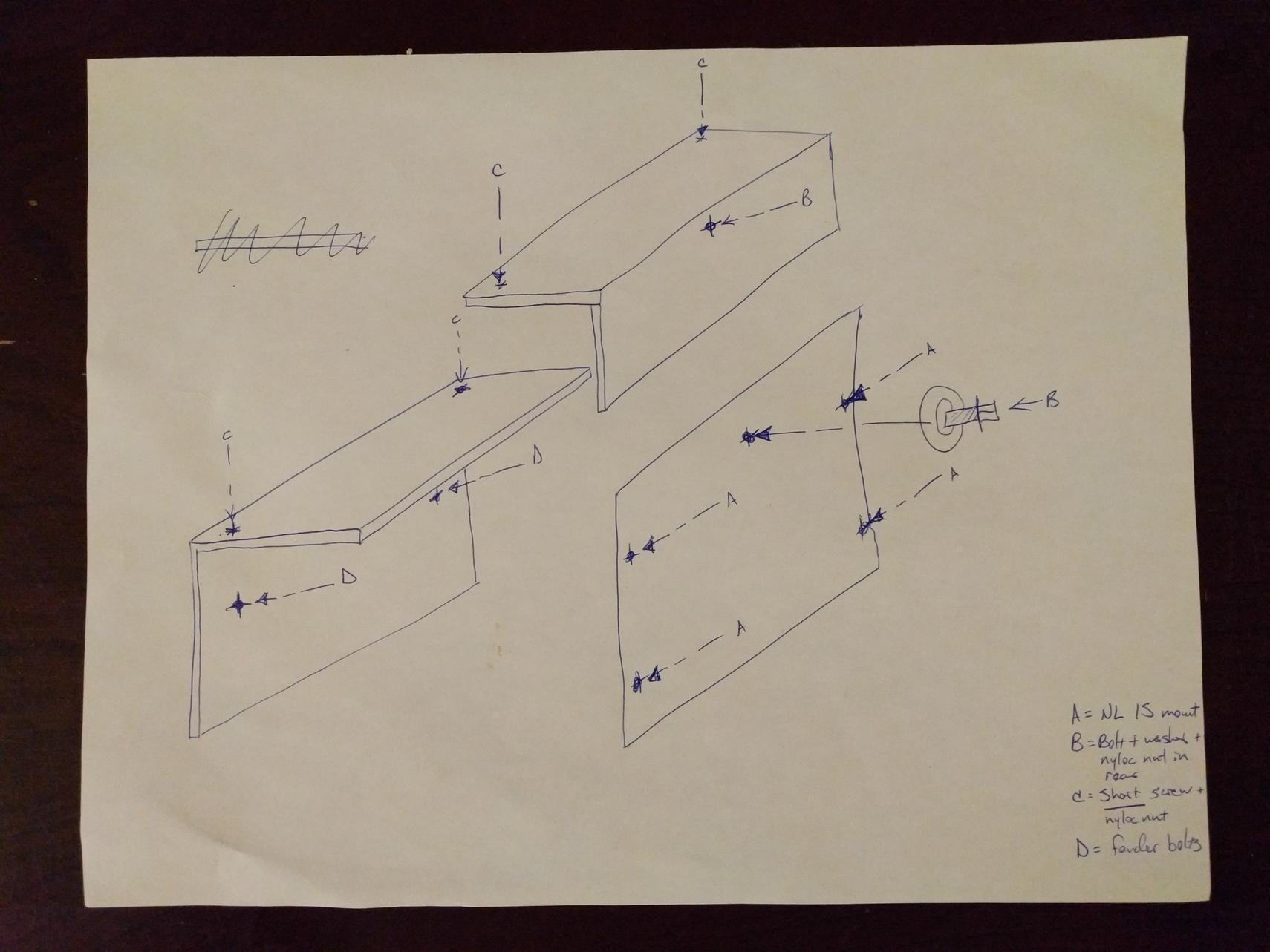

Here's a rough diagram of the bracket for the ACR. I posted detailed instructions here if you'll be building your own.

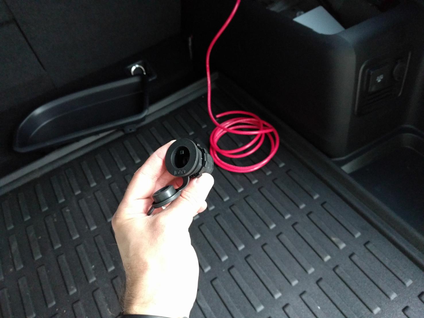

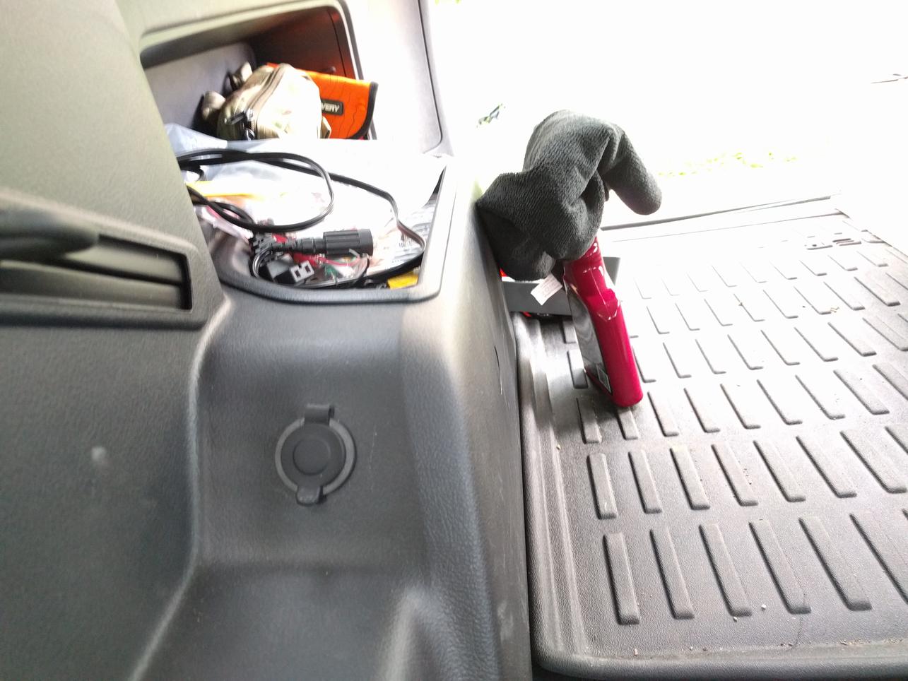

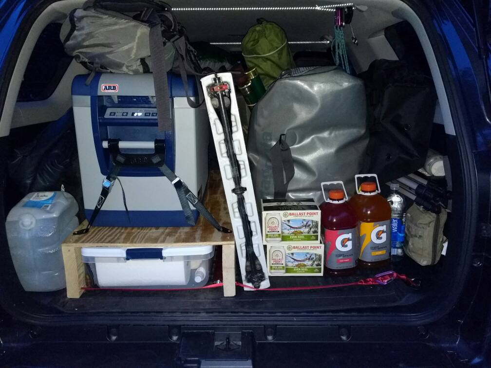

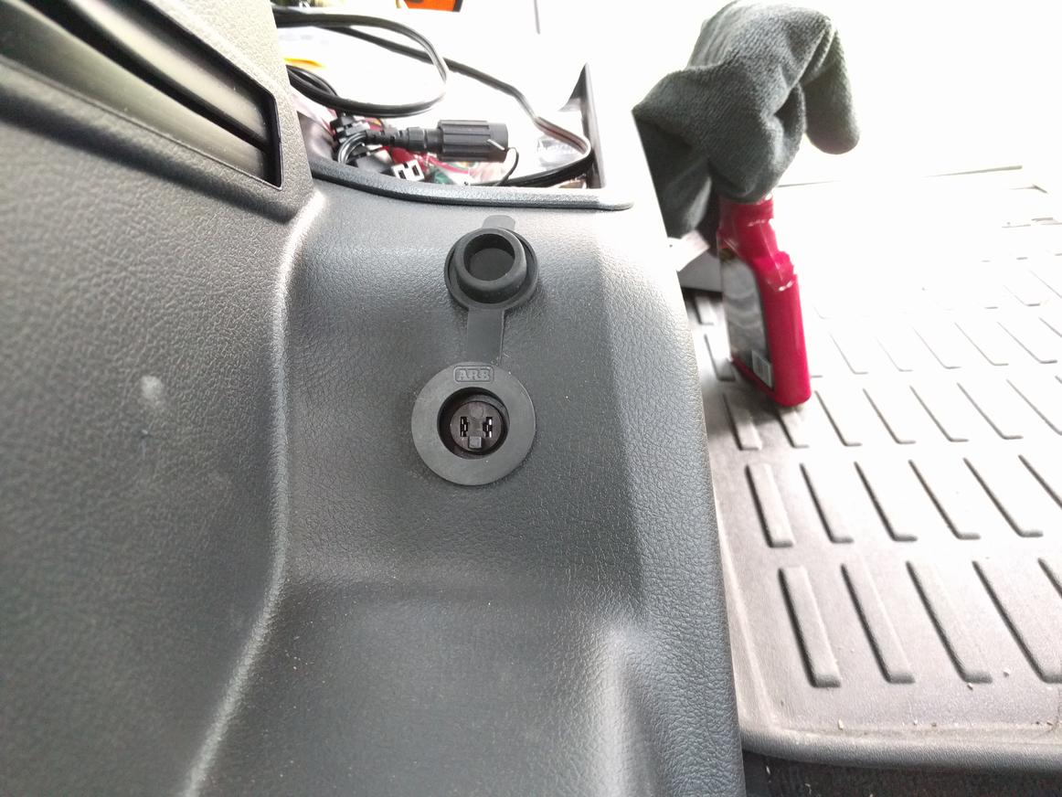

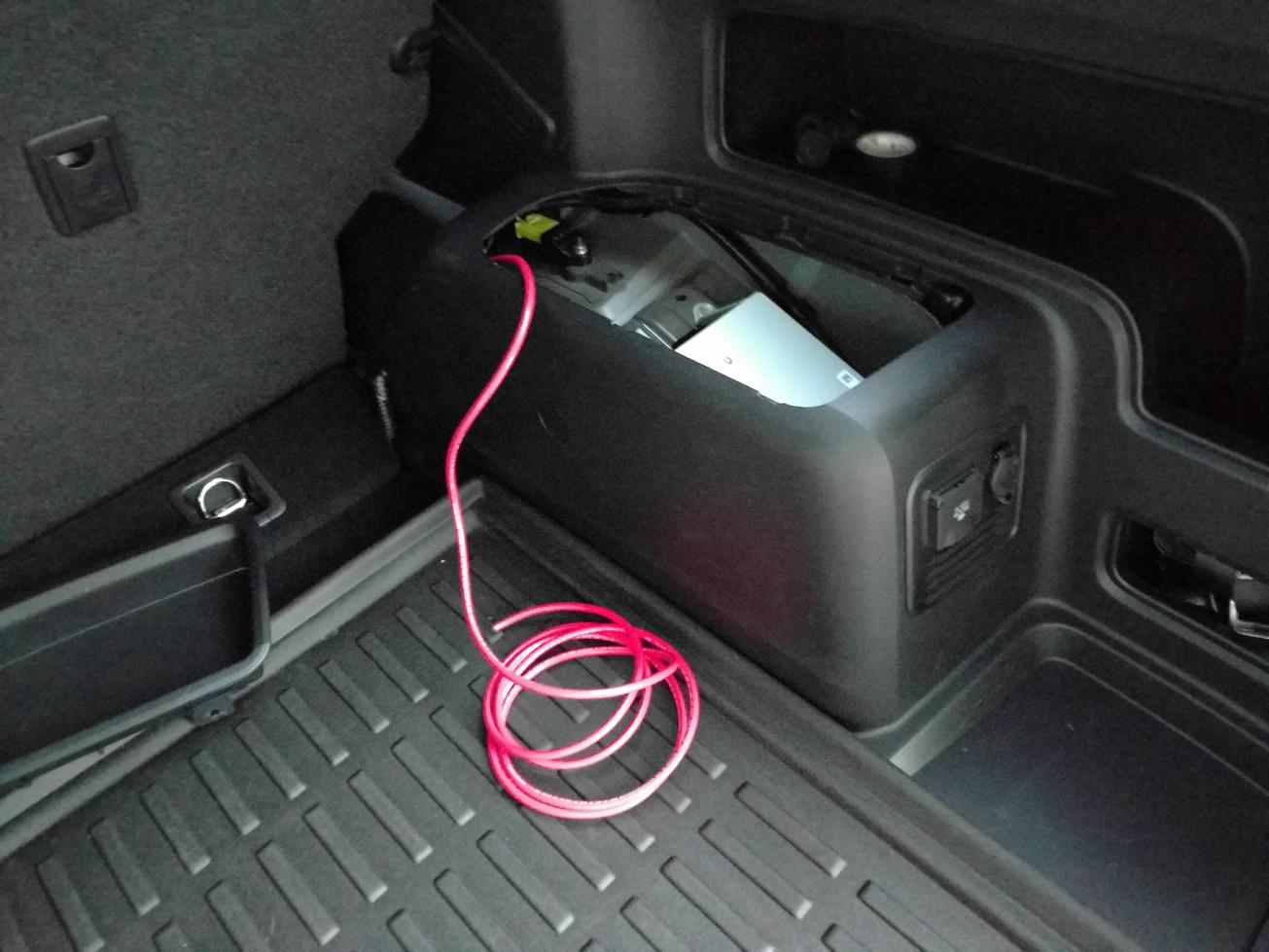

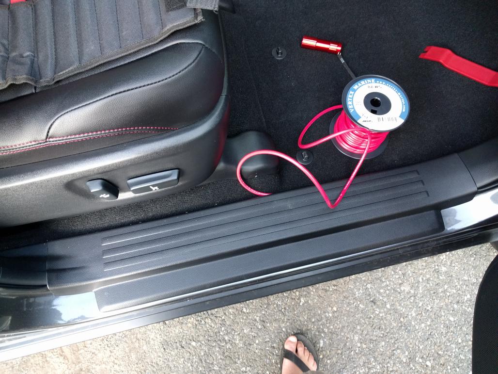

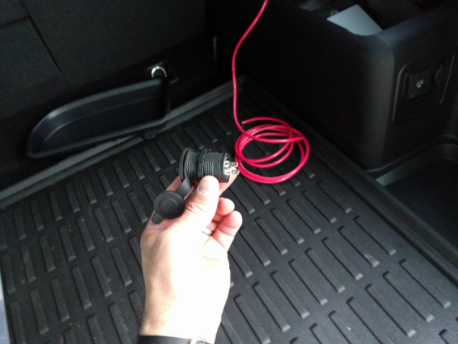

I couldn't find very many pics of the fridge wiring process, but I essentially followed [MENTION=65614]Antman[/MENTION] and [MENTION=68685]Ducmonsta[/MENTION] on the rear wheel storage space and ran an 8 gauge lead from my house-battery fuse block through the PS firewall grommet to the rear ARB socket Here's a good example that I used as a reference.
Looking back at it, I should've run the 8ga power lead to a small fuseblock in the wheel well storage compartment then powered the fridge from that block. Future mod...

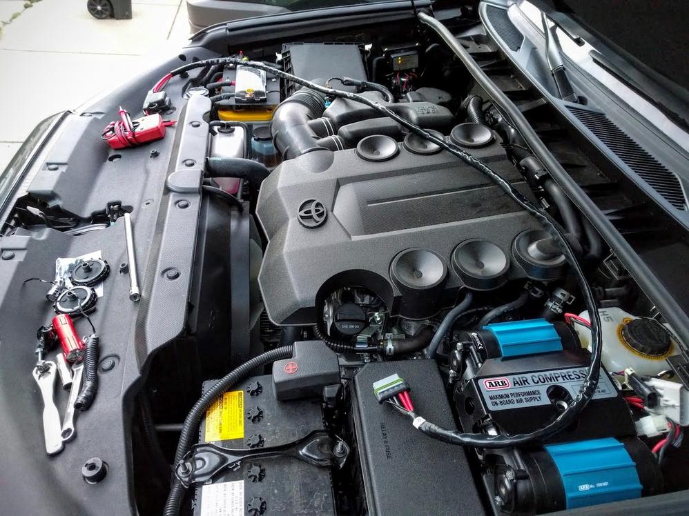

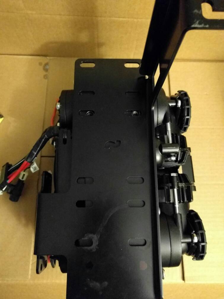

The next step was figuring out where and how to mount my ARB twin (CKMTA12) air compressor. I knew that I wanted it under my hood, but things were starting to get really tight under there. Initially I had hoped to fab up a bracket with some angle aluminum and drop the compressor next to the relocated air injection pump since the Shrockworks platform would provide a nice stable base. Unfortunately the remaining space in the PS firewall was just too tight to make it work, so I started looking for an off-the-shelf solution.
At the time, Slee off-road's website listed a CKMTA12 bracket for "2010-Current" 4runners, but after calling them to double check it didn't fit the 2016's yet. Fortunately after a few weeks (and considerable nagging from me and likely others) Slee cranked out a very high quality bracket for 5th gens that fits like a glove. The only critique I have is that I had to drill two additional holes in the bracket to position the larger CKMTA12 closer to the DS fender, as it was rubbing on a couple of factory hoses. A very minor mod to the bracket and I was ready to install. You can see the sharpie marks where I drilled my additional mounting holes at the bottom of the first pic below.

It seems like the AIP bracket wastes a lot of space. Its hard to tell from the pictures but it seems like you could have a vertical bracket that would allow something next to it as well.

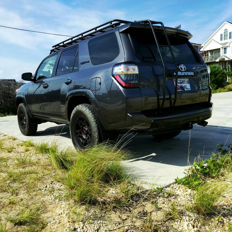

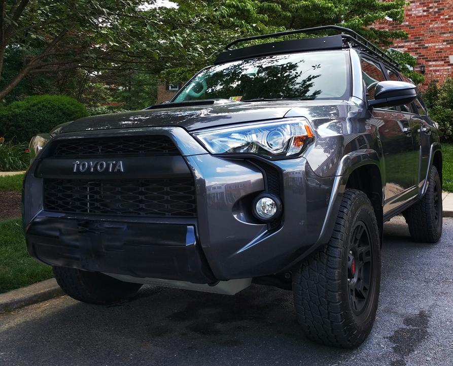

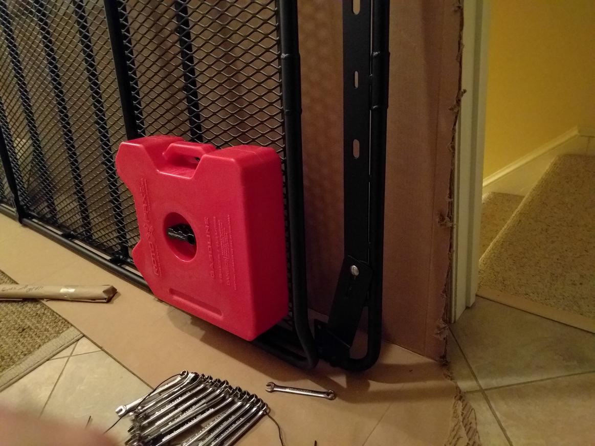

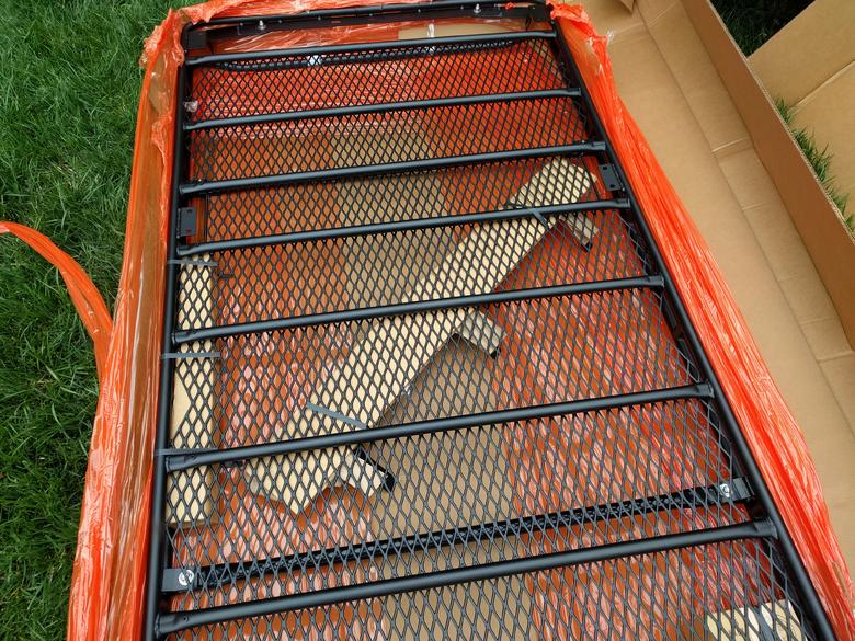

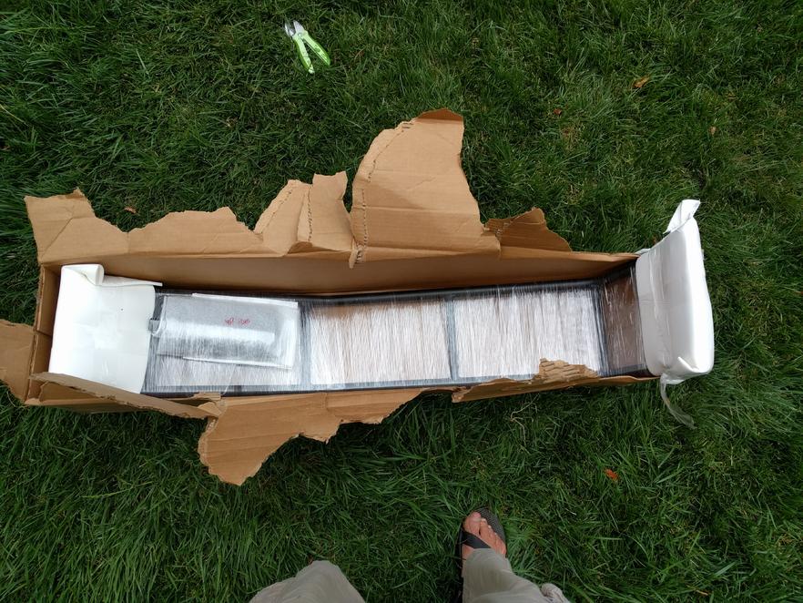

Closing out the end of phase 1 was receipt and installation of my Gobi Stealth rack. I had ordered it in late May, knowing that I had a cross-country road trip scheduled for mid-July. Given the sometimes long waits associated with their builds, plus freight shipping, plus their summer sale (free ladder and fairing) I was a little nervous about receiving the rack in time to install it ahead of my trip. As soon as I had an order number from Trail Duty, I called Alex at Gobi to check in on the actual build time and when I should expect to receive it. The news was not initially good and I was told that the rack would take 8-12 weeks to arrive (despite the 6-8 weeks listed on Trail Duty's website at the time).
Fortunately, Alex at Gobi is an f'ing saint and when I explained my situation w/ the upcoming road trip and the need for the rack, she connected with the guys in the shop and somehow got me my build in time to install and hit the road.
I won't re-tread the already numerous unboxing and installation pics, but I feel compelled to call out [MENTION=59081]W8kbrder[/MENTION]'s thread here and @Okki's heads-up on rotopax mount/install here -- you guys saved me a bunch of time -- awesome threads. I also took a cue from (yet another) [MENTION=65614]Antman[/MENTION] post and added some paint protection film under the fairing and between the ladder and the rear door. Going up and down the ladder to tweak the fairing, I noticed that my shoes were leaving marks on the door. Not a big deal in front of the house, but in muddy boots I could see myself grinding through the paint pretty quickly. Maybe I'm just overly sensitive to a rusty rear hatch because of my fj60...

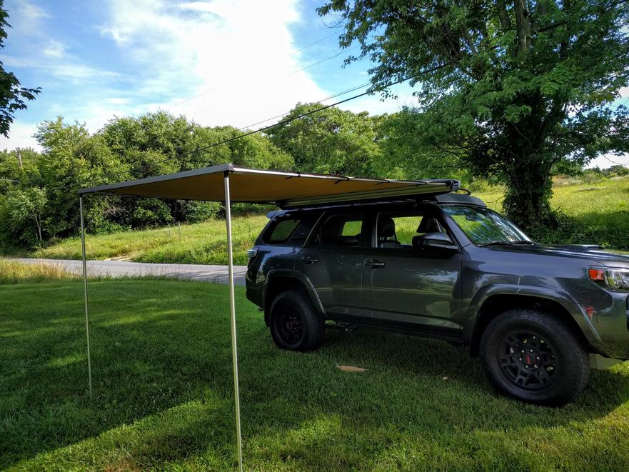

Obligatory awning pic because I put a 2500 on too.

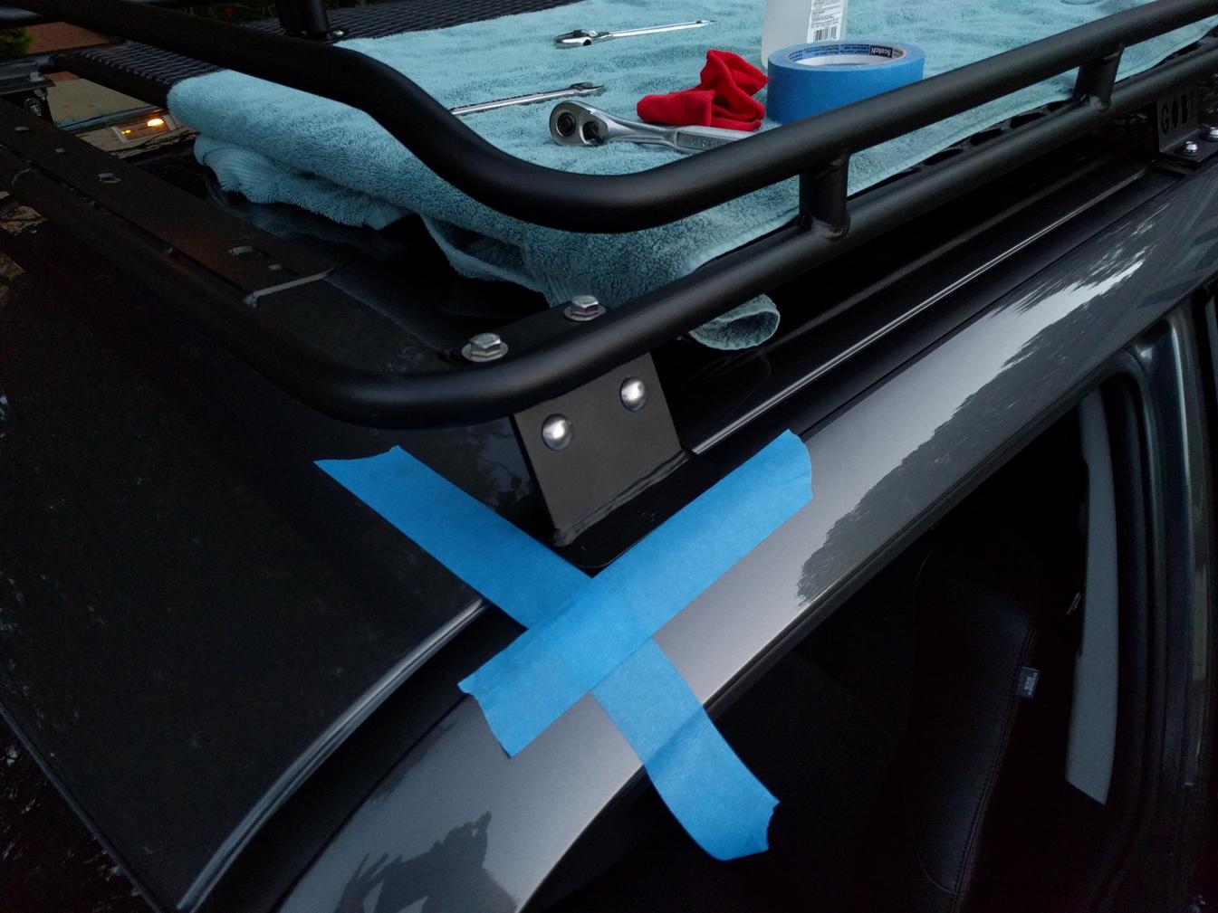

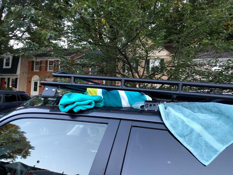

Lessons-learned on the rack install:
  1. You'll almost definitely need a second person (or a pulley) to get the rack on the roof - it's not that the rack is too heavy, the dimensions are just awkward
  2. Rolling up a few towels and placing them on either side of the shark fin (just forward of the spoiler), then sliding the rack forward over the feet was the method I used to orient the rack without damaging the roof. Worked well for me.
  3. The most time consuming part was getting the fairing adjusted to where I wanted it from a wind-noise perspective -- I'm admittedly picky, but it's damn near silent now unless there's a cross breeze
Yeah. It's well built, but does take up a little space in that back corner. I'm guessing, but suspect that Shrockworks wanted to used existing holes for the mount (vs drilling new ones) and wanted to make one part versus two. (i.e. AIP+washer reservoir relo).

I was initially on the fence about the ARB fridge due to the cost, but there's nothing like pulling an ice cold beer out of the fridge at the end of a 400+ mile day without dealing with a cooler sloshing around.
It's completely a "nice to have," but man is it convenient.
