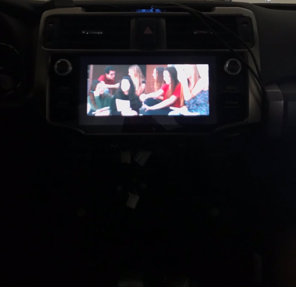

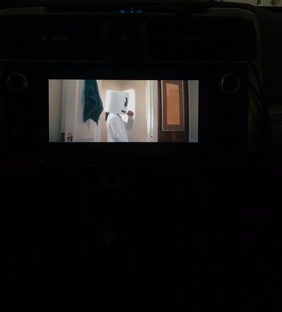

Thanks [MENTION=296608]Smerdinian[/MENTION]. Can you advise how to address the poor brightness? Is there an update I have to do somewhere?
I assume you found and adjusted the brightness slider? I've never used Android either but I saw in [MENTION=296608]Smerdinian[/MENTION] video he showed a brightness slider.
Hey [MENTION=48772]Jesse1983[/MENTION]. Unfortunately, my brightness slider is maxed out at 100 and it’s still terrible - the pics from earlier are with the unit at 100.
I’m trying to get my hands on the fix that you have to load to the unit.
He's stated a couple of times that there is a file that needs to be loaded to correct the issue with the brightness, so clearly it's a software issue..he mentions in the video to reach out to him directly and he'll provide it..
Wasn’t sure what avenue to reach out to him since I don’t do Facebook. Regardless, I was able to get the file from the manufacturer and got it loaded successfully. We are back in business!
