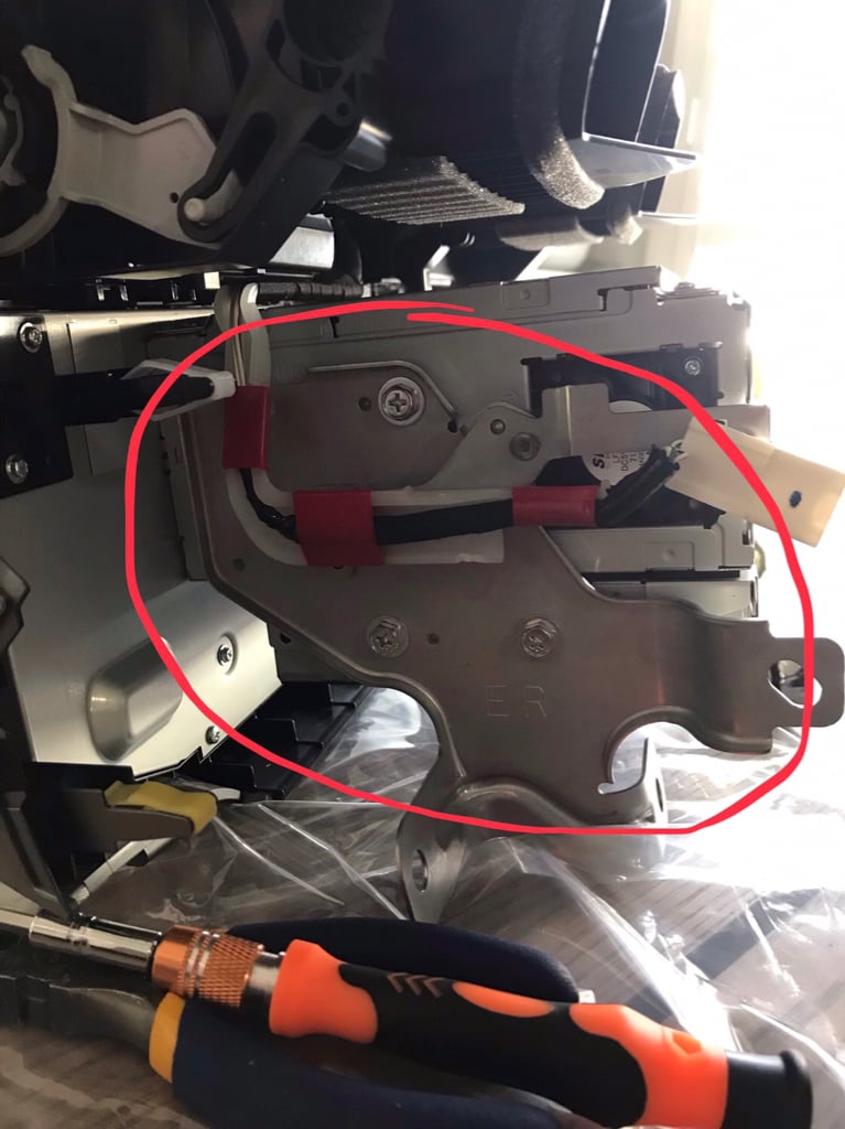

[MENTION=296608]Smerdinian[/MENTION] - any advice on what you transferred over from the OEM hardware to the new unit? 2 AC vents and the hazard light switch - is that it? Did you also move over the two brackets from the side of the OEM unit (2nd picture)? Appreciate any guidance you can offer on the actual install process.
Congrats my man, at last, you the amazing Unit! The 2 brackets won’t fit and not needed. So don’t move them. What you said above , the vents , hazard switch and the 2 black plastics of the knobs for the vent. Also remember to not install the XM OEM, although I did, but there is no way, yet, to make it work. I’m working on it...

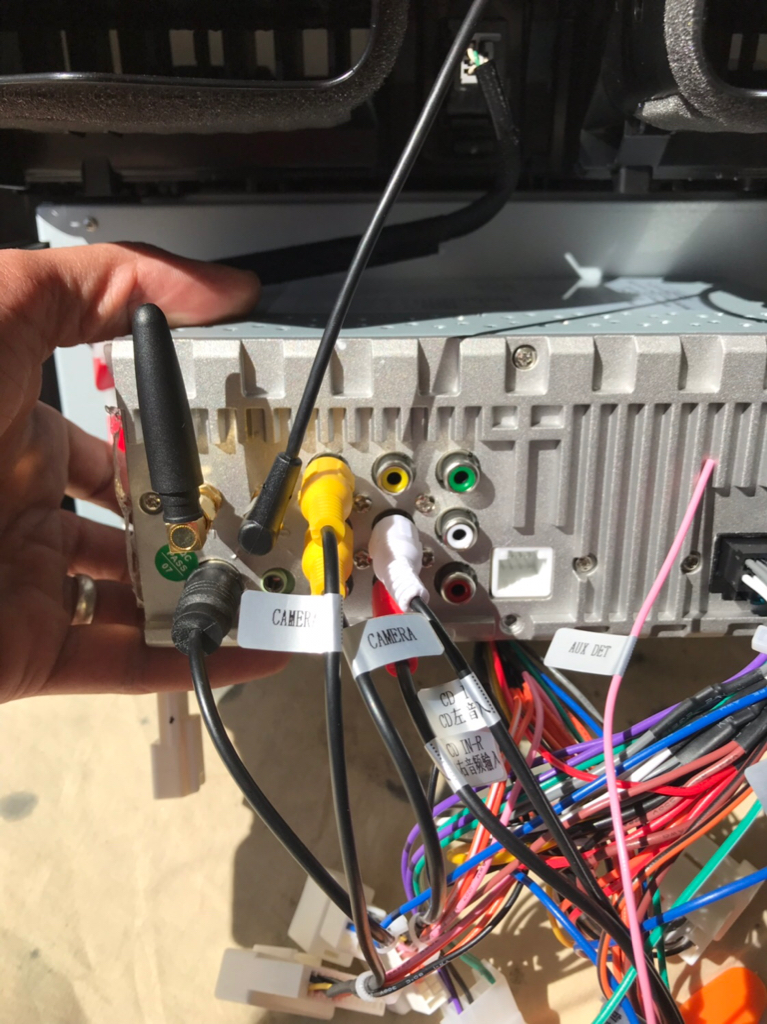

Here is what I have:
Two yellow lines for Camera going to 7 and 8 for video output
One red and one white going to 4 and 5 for right line and left line
Radio antenna, GPS, and WiFi in their respective spots on the back of the unit. I just have the GPS resting on the top of the unit - didn’t use the 3M tape.
I didn’t connect anything to 1,2,3,6 or 9 on the back of the unit.

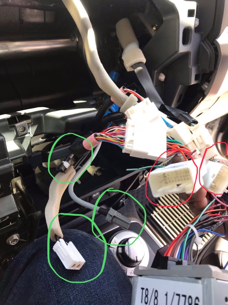

Now, I have everything from the 4R connected to the new unit, almost. Not sure what these are? I have three connections coming from the 4R (green circles) and two connections coming from the new unit (red circles). They are not the same size connections. Everything else connected up just fine from what I can tell. Any ideas? Are these not needed?
