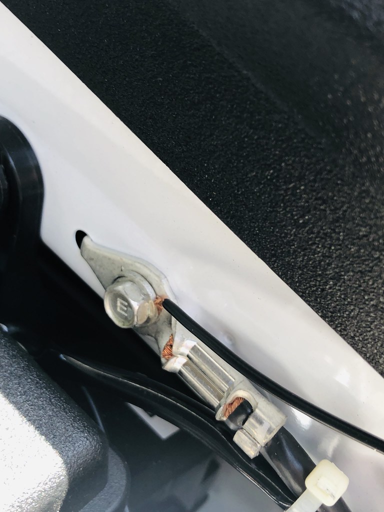

Ok, you've peeled back the cover. Now, there is a bolt that holds in the ground wire on the driver side wheel well, you need to loosen that. Here is a little piece of information that is very important. On the bolt, there is a washer and then behind that washer there is the round piece of metal (the ground). You need to strip your negative (black wire) back about half an inch. The now stripped wire goes BEHIND the washer so it makes contact with the ground metal itself. Whew, that was a lot to process, hopefully this pic will help you out.

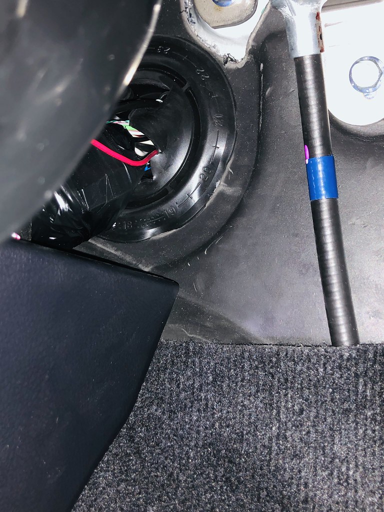

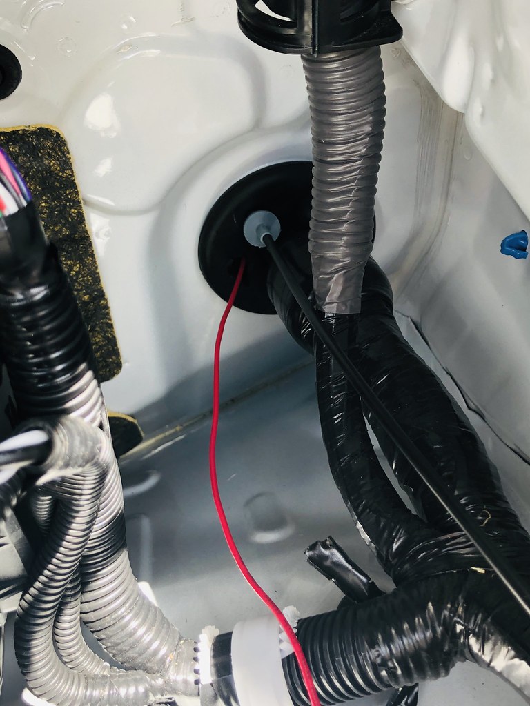

Here is the most annoying part: the firewall seal. Ugh it gives me shivers just thinking about it. So that fuse holder, the oddly shaped black box has to go through two layers of incredibly strong rubber. Just poke a hole in it and really squeeze it through, you might have to go back and forth between inside the car and outside in the engine bay.

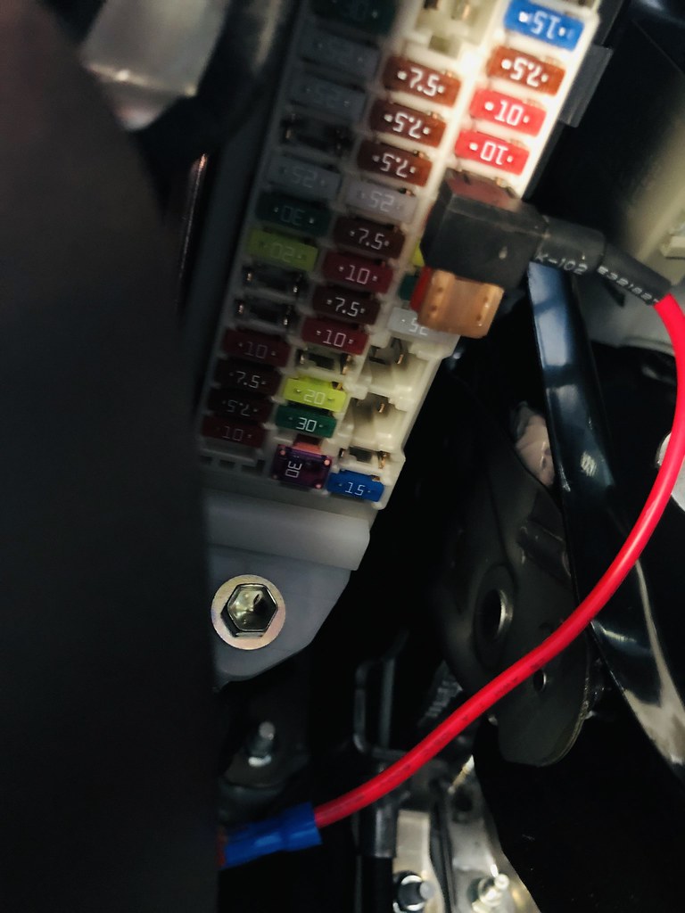

And here is the final and possibly the most important part of this whole process. The black box that you now have hanging in the foot well (the fuse box) has two slots on it. In the kit you will receive a 5 and 15 fuse I believe (someone correct me if I am wrong) but for simplicity I am going to use the colors they have. So bear with me on this description: The fuse holder has two slots, and one slot is closer to the silver fuse connector that sticks out. Place the RED fuse in the slot closes to the connector, and place the brown fuse in the remaining slot. Word of warning, I placed mine like this as a complete guess, there were no marking for which went where. I am only instructing you to place your like this because it worked for me and no fuses blew out.
Ok, now you have the extra fuses installed. Now you may ask, where do I plug the entire thing in. Well I saw a couple diagrams from similar kits. Once you take the cover off of the fuse box, there is a diagram that shows a number (or type) of fuse that is plugged in. On the diagram there are two slots labeled "10A" and directly above those slots, there are two empty slots. I placed my fuse holder in the empty slot right above 10A and it works fine for me, but please correct me if I am wrong.

lol did you just wedge a stripped wire under a washer for the ground? take the 5 seconds and at least crimp a ring terminal on that
for the fuses- if it was an empty slot on the fuse block then you only need the 1 fuse for your tap, you don't need the second fuse (the second fuse won't hurt anything though)
