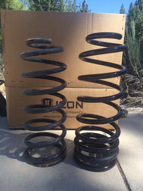

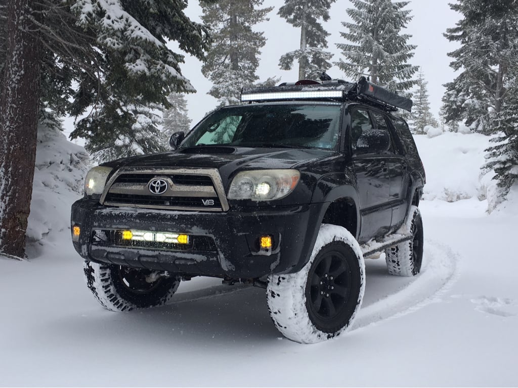

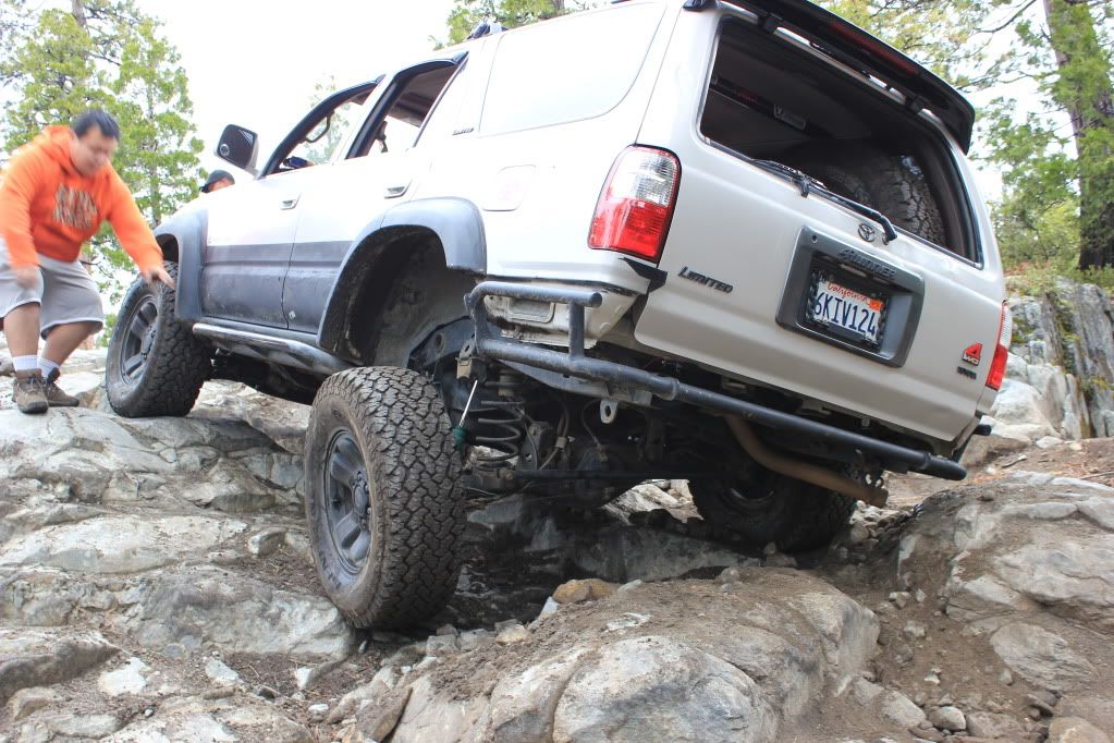

Replaced superflex with icon overland coils. No more rear sag, at least till I get my 4x4 labs bumper.
I'd say I still maintained 3" lift in the rear with them springs and 4x4lab bumper on mine.
With you having them draws, will tone them down, and throwing your bikes on the rear, will make them feel like riding more of a Caddy.
Question, rear 2.0" or 2.5" ICON resi's with all the added weight plus the 4x4labs rear bumper coming? Please give me your thoughts.
Maybe try your 2.0's for a while then see if you want to upgrade? It's quite a large jump in cost for the 2.5" w/ Resi. Although with your rear bumper, bike rack, and cargo drawers you could probably benefit from the 2.5" shock.
The cost is the biggest factor. I asked ICON and they said 2.5's. I wish they made them in a non RR. I jumped the gun and bought 2.0RR's. I have a 3 week road trip coming up and can't get my 2.0's rebuilt in time. Oh well, this trip will give me a reason to keep the 2.0's or upgrade to 2.5's.
Radflo 2.5s come nonresi and are the same price as the Metal tech 2.0s
Considering the shocks don't support the weight of the vehicle and only dampen the speed in which the suspension travels you'll likely never notice a difference between 2.0 and 2.5's The bigger question is what coil springs are you running as that is whats going to determine how well your ride will support the additional weight.
Remote reservoir's purpose is to reduce air build up in the oil of the shocks during heavy cycling such as higher speeds running over washboard roads. Their only other purpose is looks.
Performance differences between 2.0 and 2.5's would be; 2.5's will have greater dampening resistance. So 2.0's cycle faster than 2.5's. your pushing a larger washer/seal surface area through a larger volume of fluid in the 2.5. Both would have the ability to be valve properly to match your spring rate. 2.0's would begin to run hotter durring heavy cycling as the lesser volume of fluid would heat up faster.
hope this helps and have a great trip!
