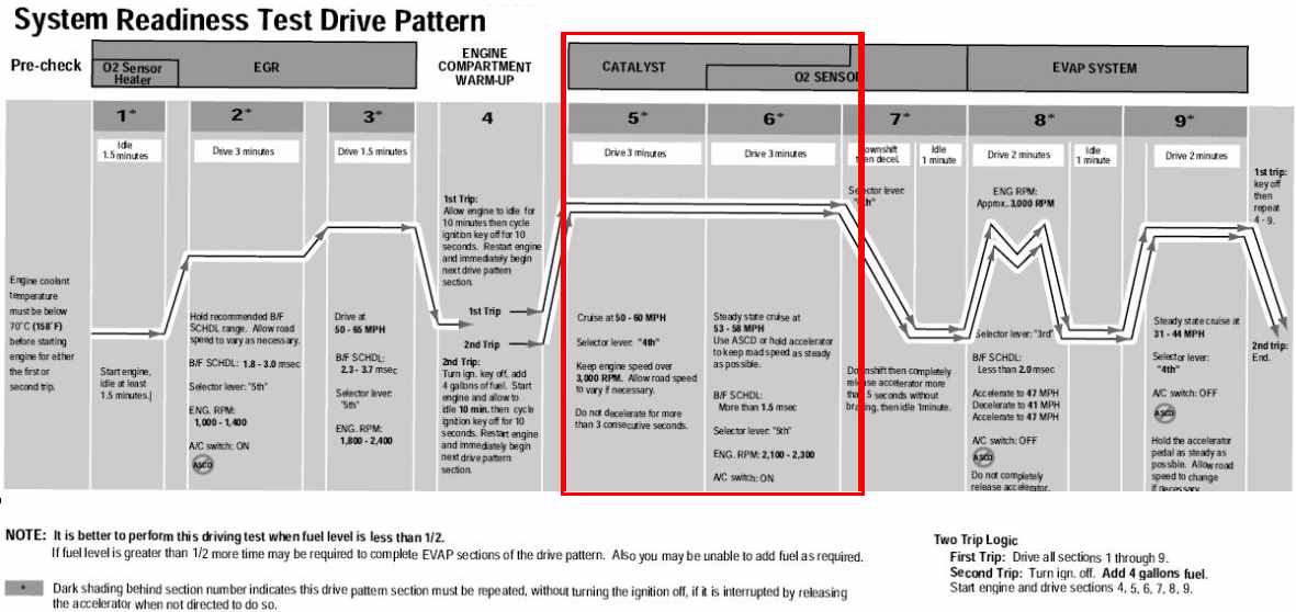

I thought I'd share my experience on this (long post, sorry). As I got close to my June inspection (every two years) this time, I found I had an I/M Catalyst = Not Ready but no code. I had last cut battery power maybe a month before. I tried my best to adhere exactly to the drive model (see link below) and it just stayed stuck on Not Ready. (Try and drive for 16 min. @ 35-45 mph in New Jersey. You will hit a light, or at least a Stop sign anywhere off the Interstate--and more than one. Try and drive 35-45 on a NJ Interstate for 16 min.! Somebody will shoot you...)
So when I was overdue back in July, I said, "eff this", and put in the URD sim. My sensors were less than 50k on the clock and I had no exhaust leaks. I reset once or twice but no help. I got into a panic as Jan. 1 approached since the stickers change color and shape each year and the last of ones like mine would expire. Still Not Ready and no code and now five months overdue.
Finally, on Dec 22, ready to order new cats without ever seeing a P0420, I checked one last time, and got a 'Ready'. Thank you for the Xmas present 4Runner! Made an appointment and passed inspection the next day. I hope I never have to cut battery power again.
It was probably a trip to Kennedy Airport I made in early December. Thank you Staten Island Expressway and Belt Parkway. Lots of steady driving at <45mph. I guess temps don't get hot enough to complete at the higher speeds we run where I live.
Here is the drive pattern spec, mine is #4 on page 13:

Meanwhile, I printed out what I thought was the drive cycle (also known as the EPA federal test procedure, or FTP), and repeatedly tried section 5 and 6 below, by setting my phone timer to 3 minutes, and then first driving in 3rd gear, always keeping the tach above 3000 RPM, without decelerating for more than 3 seconds. Then, after doing #5, I subsequently ran #6, keeping the tach between 2100 RPM and 2300 RPM with the air conditioning switch turned on, again for 3 minutes, to complete test #6. But all this was to no avail.
So, I'll download and read the TSB kindly supplied by TheDurk in order to find where my 2wd 1997 5-speed Toyota 4Runner (150K miles, original cat and o2 sensors) tests are that are supposed to set the readiness monitor for the catalytic converter.

To update that last post, thanks to the advice from TheDurk, NelsonMD, and O2SE (and especially to TheDurk's beautifully detailed drive-cycle TSB!), I was able to pass the California smog test, at a special government "referee" smog test station.
Thanks for being so wonderfully helpful to a noob!
