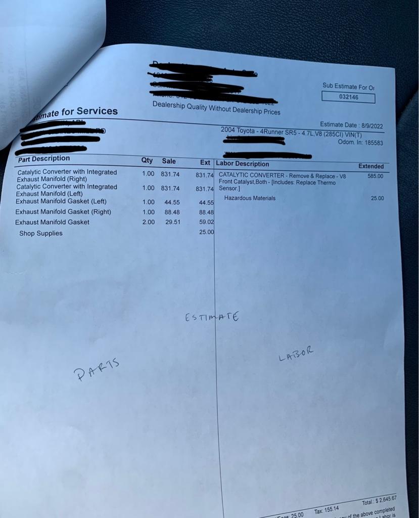

About a month ago I bought my second 4Runner. She’s a 2004 V8 SR5. I live in Texas and the protocol is that when you buy a vehicle the dealer will have it inspected prior to purchase. So I bought the car, whatever. A week ago I noticed a burning smell whenever I went up particularly bigger hills (I live in the hill country so this is kinda problematic), so I decided I needed to take it into a mechanic ASAP. I looked up the problem on some forums and i narrowed it down to transmission fluid or exhaust build up. The technician called me today and told me it was exhaust build up from my catalytic converter failing. He quoted me $2650 for labor and parts. I know I can’t replace the part myself, but this price seems a little out of a reasonable range for a catalytic converter considering the OEM part is about $750. I guess I’m just wondering if I should call around and ask other technicians for quotes because I feel like I’ll be getting robbed in a way.
It took me about 2 hours per side to change with a second person also a possibility of stripped bolts and breaking studs... so if pricing includes all the rusted headaches than worth it.:D
The cats are made/welded onto the exhaust manifolds, which are a real pain to remove and replace on the V8, labor intensive.
You can't just buy OEM cats without the exhaust manifolds and just replace the cats.

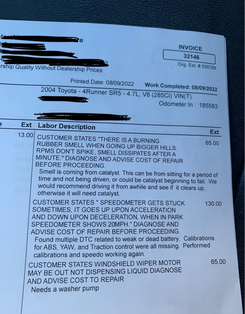

Okay, so here is what they gave me. Not really definitive so I’m not sure how to move forward.

A smell like burning rubber sounds more like brakes than catalyst, to me. A mad afternoon on the motorbike results in similar :D. In your case I wonder if it's a slightly sticking caliper.
Those prices don't seem out of line to me for a Toyota dealer, the labor seem reasonable considering what they have to do to replace the manifolds/cats assemblies.
That being said, if it were me I wouldn't replace them until I started getting codes that warrant them needing replacing, especially since it says "burning rubber smell" which I have never seen nor heard of a bad cat causing such a smell.
Maybe a bad/dry wheel bearing too? Agree I would want to check all the stuff I can check for free myself before throwing money at new cats.
OP, if you pull over without braking (just let the truck roll to a stop) you can CAREFULLY feel each brake disc to see if one is significantly hotter. Or use an IR thermometer maybe.
I possibly agree on this one I had a seized rear caliper and messed with driving and could smell it. Put a hand on all your wheels right after driving on the highway if any one is more hot than the others possibly a caliper issue. 4th gen rear calipers are notorious for seizing, I replaced mine with 5 gen calipers...

If the ECU has not reported any DTC (check engine light) associated with a bad CC, I would be hesitant to spend that kind of money on something that may or may not be the problem. The fact that you only experience the smell occasionally is something I could live with if the vehicle is otherwise running good. It's obviously running efficiently considering your reported mpg.
For OEM parts that price is not terrible. In the rustbelt getting those manifolds off can be a bear. Kicker is if an upstream cat is actually physically degrading then the debris will end up in the downstream cat which is not listed. Assuming the engine runs good and if no odd noises I would certainly hold off on the cats. Like mentioned, when you smell it do check the temps of the wheels and do a sniff test on them. I've had a bad axle seal allow gear oil to drip on the brakes which is an odd smell but very specific to the corner with the issue.
here’s an update. not that anyone cares.
Got my trusted mechanic to do a full diagnostic and found nothing wrong. After a few months the smell completely went away.
My guess it that the car had been sitting for awhile without running causing a buildup. The dealership I bought my car from originally got my car at an auction where I assume it had been for awhile before. So turns out I just needed to drive the smell away. Haven’t had a problem since.
