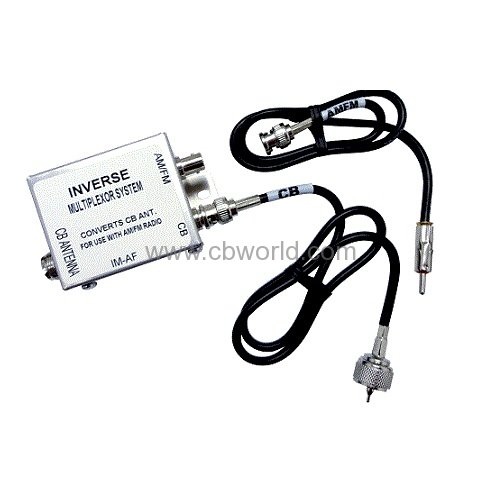

I would like to ditch the OE power antenna and use my rear mounted CB antenna for both CB and AM/FM radio. Just wondering if anyone has done this or can think of any issues with doing this with a splitter like this one. Seems like an easy enough solution if it will work. Thanks.

Reviews are good, I thought simultaneous use might cause interference, but it seems not. Let us know how it does! I wanted to go up to GV this weekend, my friends are there, but I don't see it happening, have fun.
Just ordered one - I'll update when I get it installed. Went for a great forest drive last night to test the new Rigid Dually LED's mounted to the CBI Ditch mounts and worked great.
Just finished installing it and seems to work like a charm so far - both CB & AM/FM seem to be coming in loud and clear. The power antenna was fairly easy to get to as well so finished both the install and disconnect in about 30 min - I was expecting a few curveballs so very glad it was a snap!

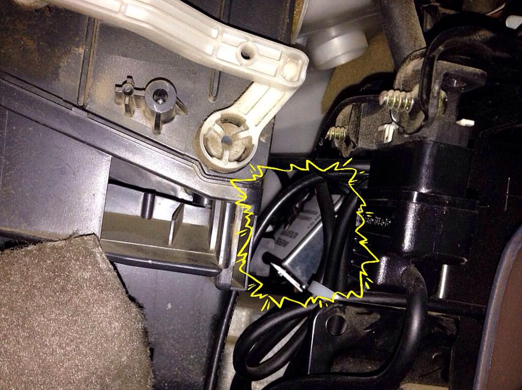

Sorry, not much to see -.probably should have snapped a pic with the stereo out. I was really surprised how easy the whole center center dash assembly pops off then it's just the 4 stereo screws to get to the antenna and swap connections.
Nothing is visible from inside the cab without getting down to the foot wells and looking behind the console. The multiswitch box is a little bigger than I expected but tucks behind (then below) the back stereo with enough room to put everything back without smashing anything.

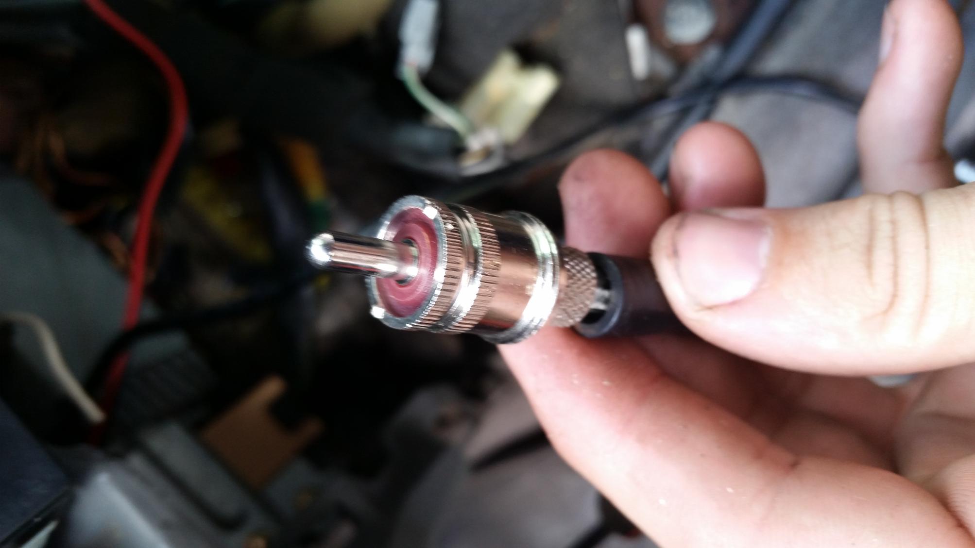

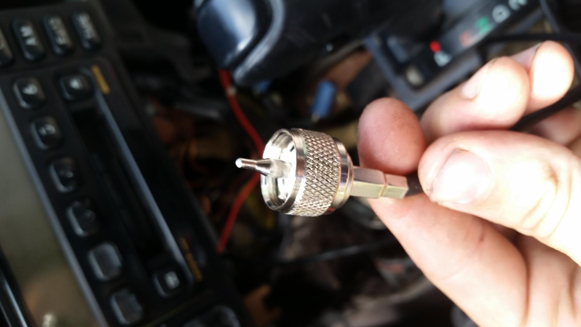

uniden pro520; played around with all the adjustments....only thing that was odd while installing, i noticed the male end coax the splitter comes with is skinnier than my original coax cable (male end); this could make for a bad connection?

It takes more than the tip to get the job done. :dance: As long as the plug fits and is tight you should be good.
