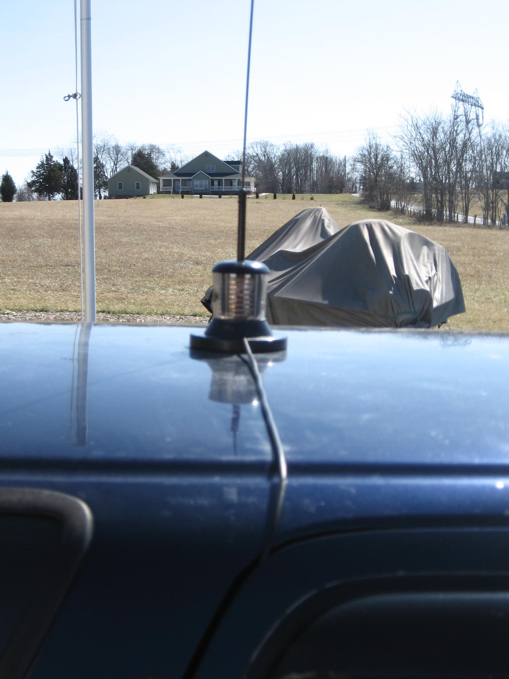

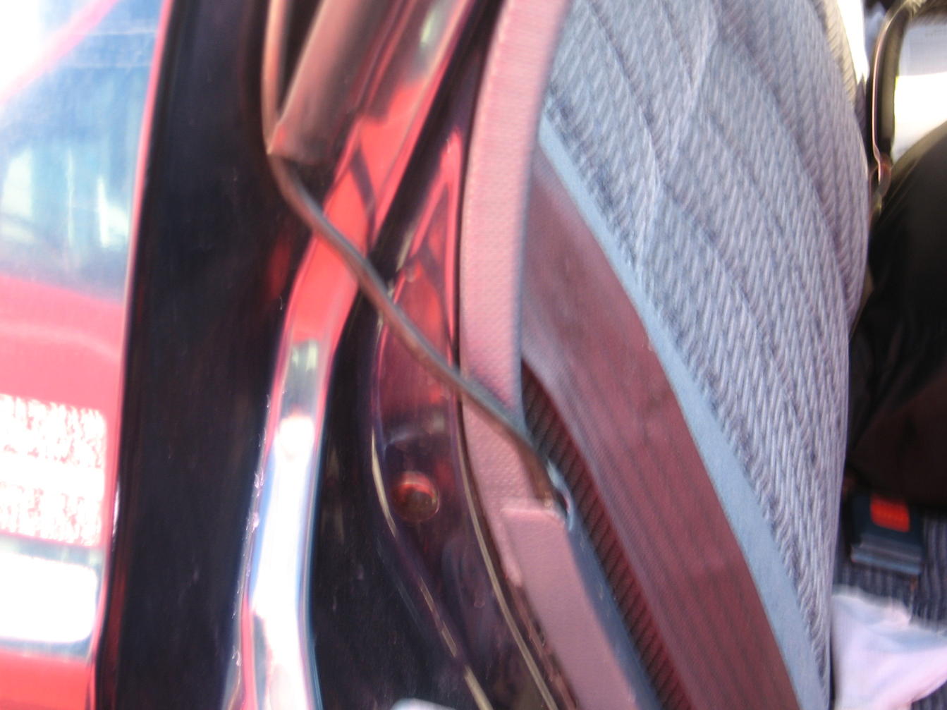

I used to have a magnet mount on top of mine and just ran it down the passenger side door through all the carpet to a cb. Buttt it was constantly hitting things and eventually got broken off by a low hanging branch. I then switched to a firestik door jamb mount with a 3 ft firestik with medium spring Mounted it in the rear right above the tail light. Slides right in between the tail gate and light. I prefer it so much more over my magnet mount. But its your rig and you know whats best for you. Best of luck to ya!
-Jhacker
p.s. here is the previous pictures of how i ran my antenna. (sorry for the big pics)

thanks for your input! I may just have to do that to mine. did you have any problems with water leaking into the cab at the point where the antenna cable went through the door weatherstripping?
nope no leaking what so ever. Just tucked it right in behind the strip. just made sure the door was shut good.
