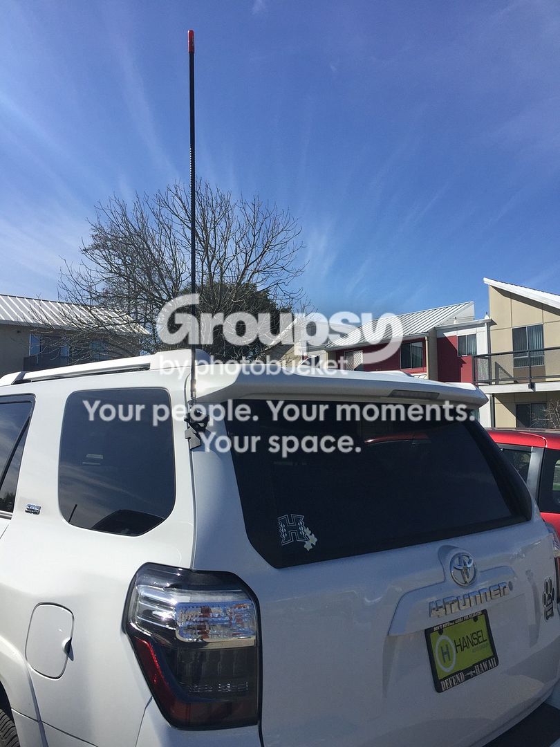

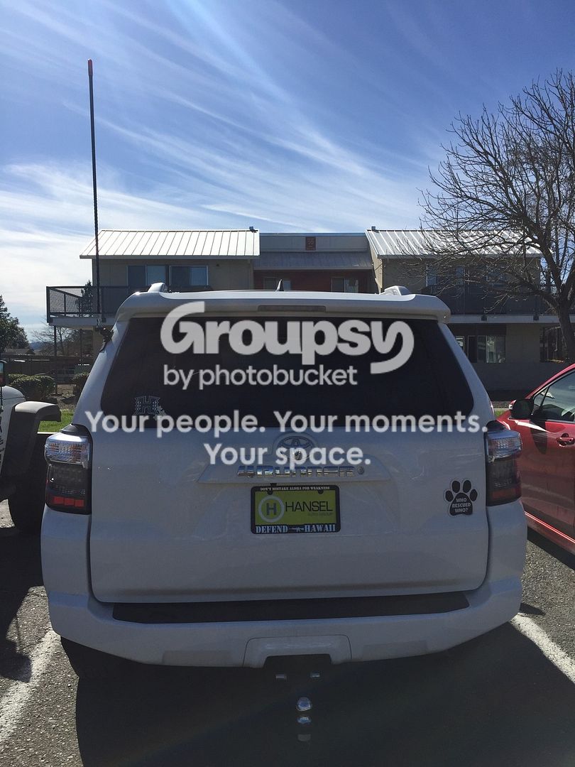

So I actually just relocated the antenna mount to right above the left tail light and switched the antenna to a 2' Firestik so that I could park in my garage without removing the antenna.
The area that I had the old mount did have some rust due to the bolts screwing into the point. There was also a little bit of rust on the opposing side of the mount from the mount hitting the car when the trunk was closed. The rust was nothing major. I just used some Perma Blue (from my gunsmithing supplies), dabbed it on there and then just put electrical tape over it... definitely no science behind it, but I at least feel better about it! hahaha
I also went to a local CB radio shop to get my Cobra radio/antenna peaked and tuned ($50). The CB now puts out 4 Watts, swinging to 10 Watts when being spoken into. It was 2W swinging to 4W when he started. My reception is great now... I don't know how far it goes, but the two random times I did a radio check, I got a clear response :). The best part is I never have to take off my antenna!
Oh yea, last bit... I did replace the heavy duty spring with a light duty spring, so that every time the antenna hits something, it doesn't warp my mount. Here's the link:

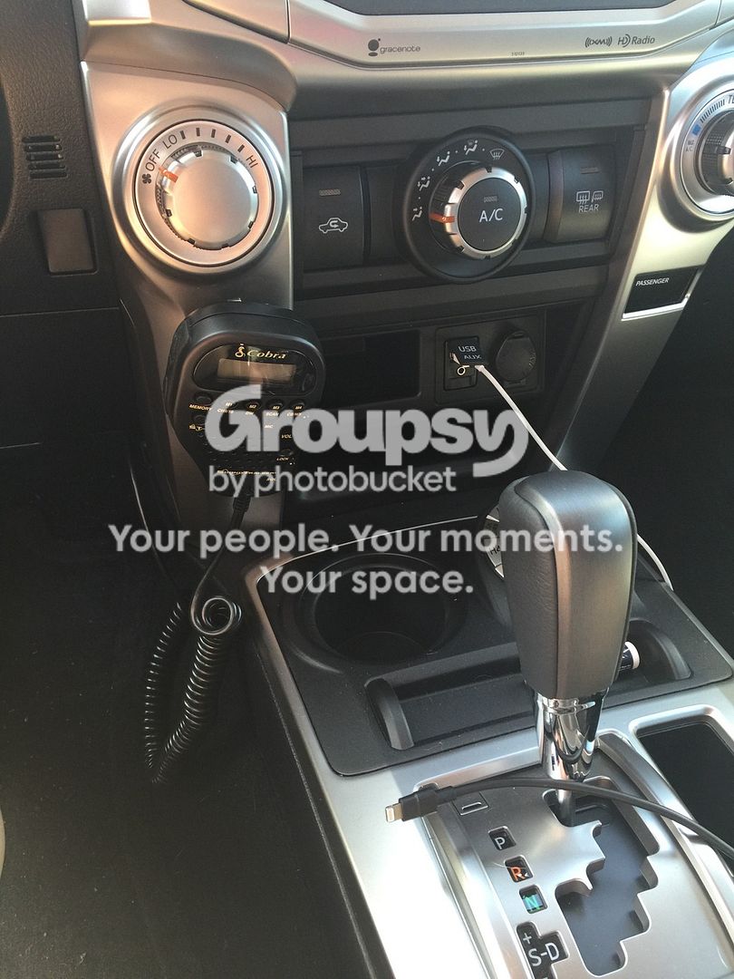

I also used a Diamond K400 mount and love how it turned out! I think it's the sleekest antenna mount I've seen on a 4Runner. Hubby mounted the handheld unit right under the AC power dial and as nervous as I was to have him drill holes in my week old baby, it turned out great!

I am also going to swap out my 3' Firestik for a 2' in a few months. We both have a 3' and he thinks we need it for our caravan cross country in April but after that, I don't want it to be so high. Whatever he thinks is best, since he's the car guy :argue:

Now that the dash and center console are apart, you can begin looking for places to mount the control box for the Cobra 75WXST. Keep in mind that wherever you chose to mount it, the wire that the handset attaches to is only 6" long. This is why Okki ran into trouble trying to get his handset plug to where he wanted it (Thanks for the lesson learned Okki! :hatsoff:). He ended up getting an extension cable, and you can too if you can't find a place that works for you.
We chose to mount it forward of the 4wd shifter, under the cubby hole. And we attached it to this position using zip ties, with the 6" cable running to the front of the car and the power cables running to the rear of the car. Here is a picture of it installed. The black cable you see running to the control box here is the coax extension cable.

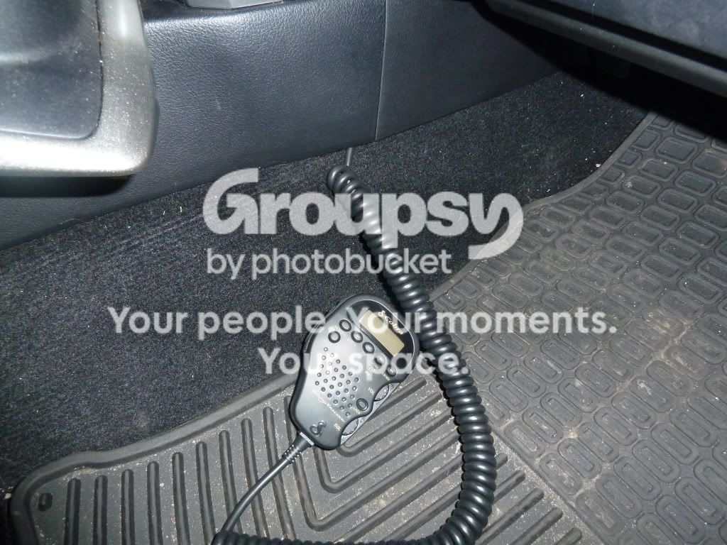

Eventually I would like to mount the handset connector to the side of the dash under the glove compartment (as it's shown here). But I will have to wait for someone smarter than me to figure out how to mount that plug to this panel.
232323232%7Ffp%3B45%3Enu%3D3239%3E%3B32%3E9%3A8%3EWSNRCG%3D3557449564339nu0mrj~original
Until I figure out how to mount it, I just connected the handset to it and ran it out of the right side of the center console. Just like Phillyd2 did.
