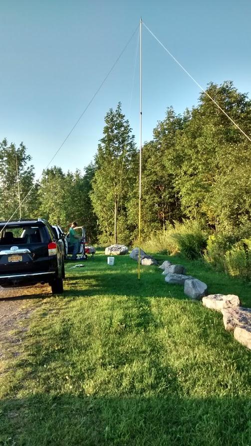

just thought I would HAM it up a bit. we were near Attica NY. Carlton hill state forest. The antenna is strung from the mast to the tree directly in the background behind the big rock left of the mast

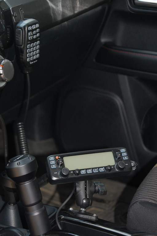

There's definitely not much room.
I initially had ordered a full size 2M mobile, but there was no decent place to mount it. The best I could come up with was a dash top mount, but I really didn't want to do that.
I'm not sure there is a 2M mobile with a remote head, so as near as I could come up with, a lower end dual band was the next best option.
I ended up returning the full size 2M and getting a remote head dual band. The radio can mount under the seat and the head can mount to the console, windshield, dash pockets, etc. Mine is on a RAM mount that adjusts nicely for viewing angle and / or to clear the passenger's knees and the transfer case shifter as needed.
I never use the 440 mhz portion of it, only the 2m. It actually works out really well because you can set both bands to VHF and scan different user groups that way. In my area, public safety is still on VHF, so I have one side of the radio set to public safety and the other to Ham.
That'd be my suggestion if you are looking for something in the 2M range... mine is an Icom IC-2730a, but there are several good options in the sub-$300 range.
