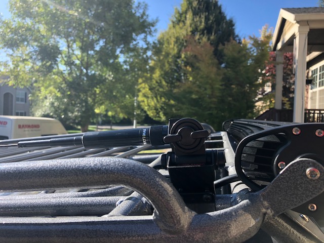

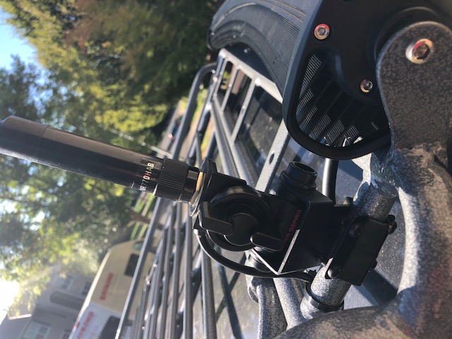

2. Used a Diamond K515SNMO mount on the rear of the left luggage rail. I was worried it wouldn't perform well without having a solid ground-plane, but it seems to do very nice (antenna is a Diamond NR-770HBNMO). I really like this antenna (have 3 of them) - their only fault is that they aren't flexible when you hit low-hanging branches.

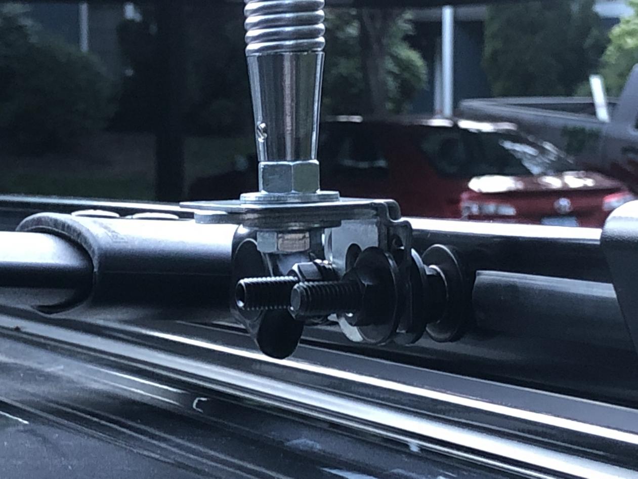

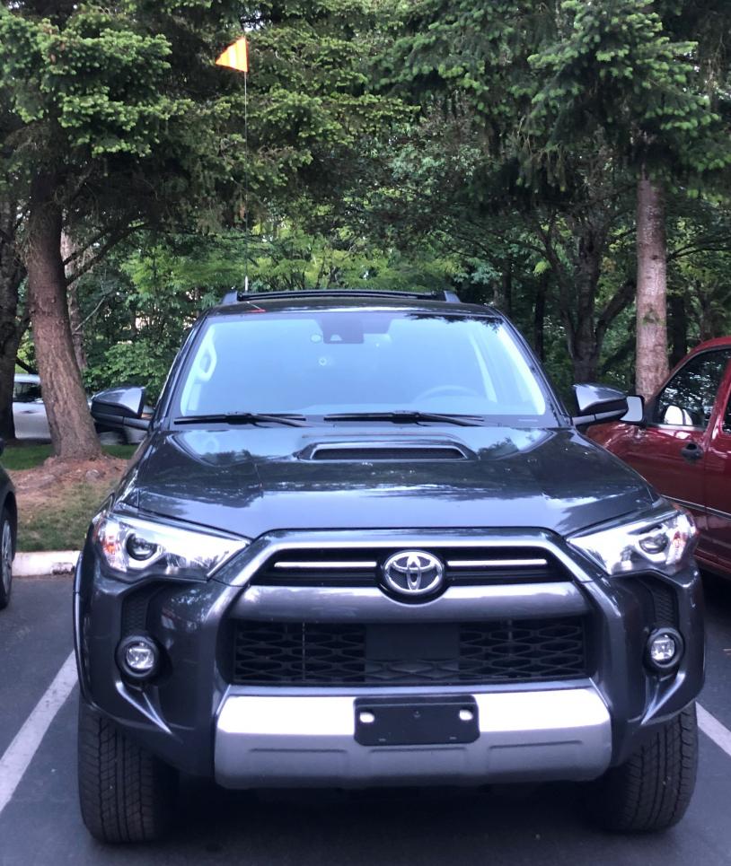

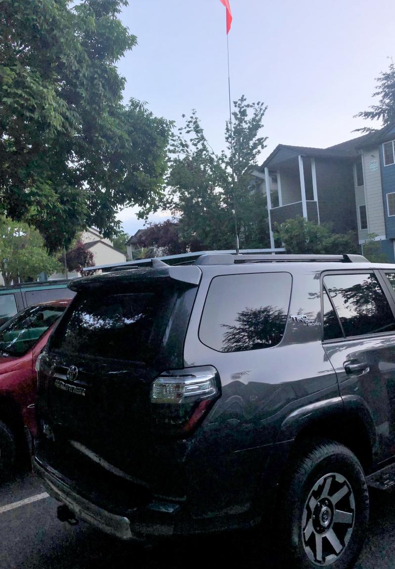

this flag , IKEA 115753 wall mounting angle bracket (Kax Pallax?), dremeled extra hole, two M8 t-slot nuts 90974A115 and screws 91390A153 from McMaster, 30 min time. Rail dimensions. Not tested yet.
