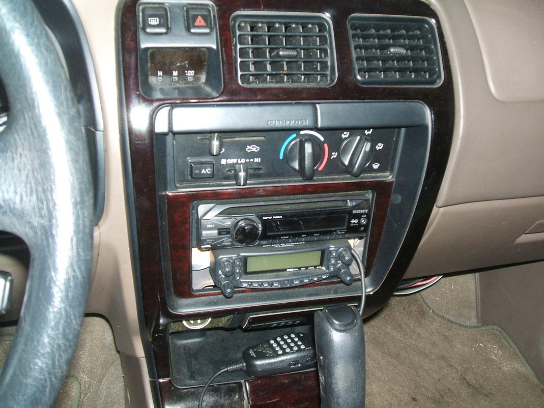

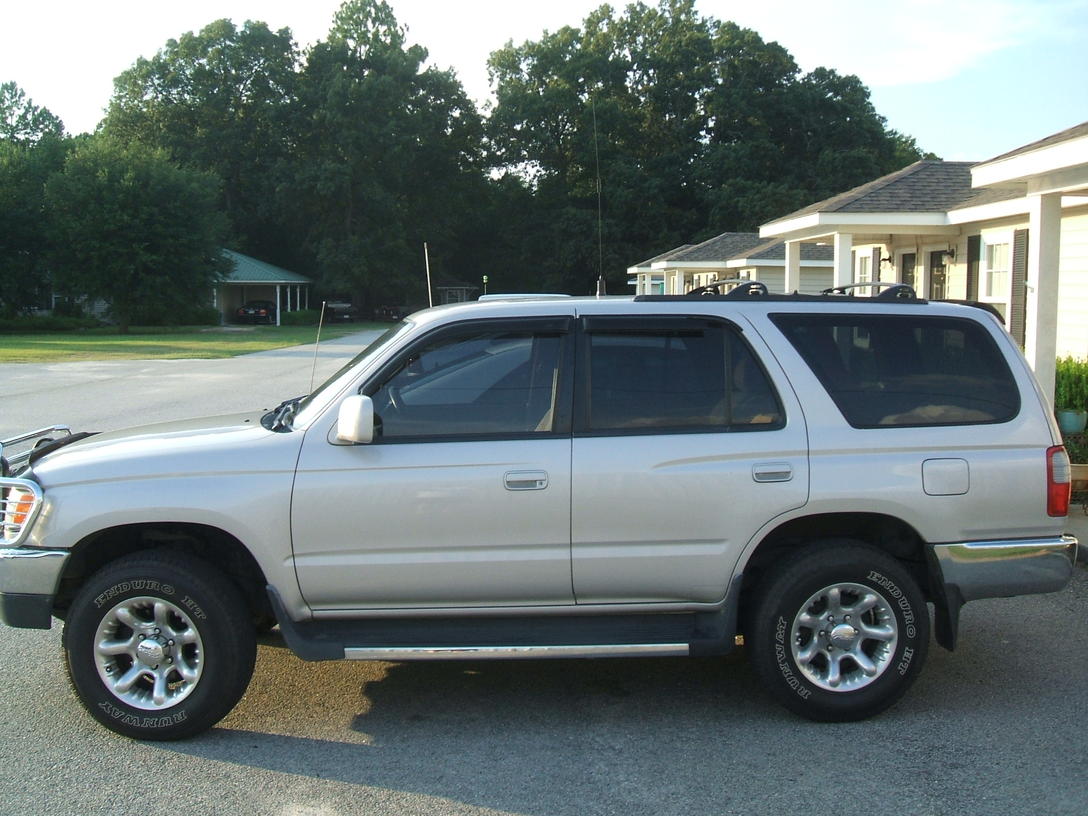

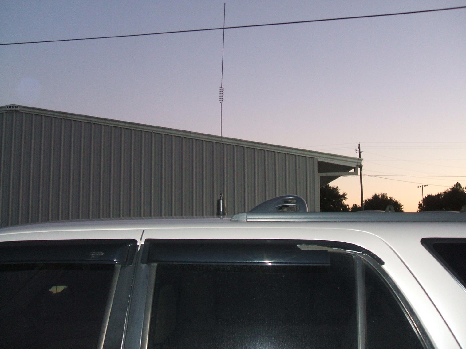

This isn't CB but it is close enough. My antenna is a NMO mount, most people won't drill the 3/4" for it though.
