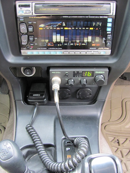

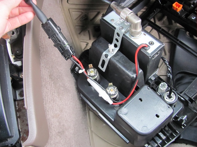

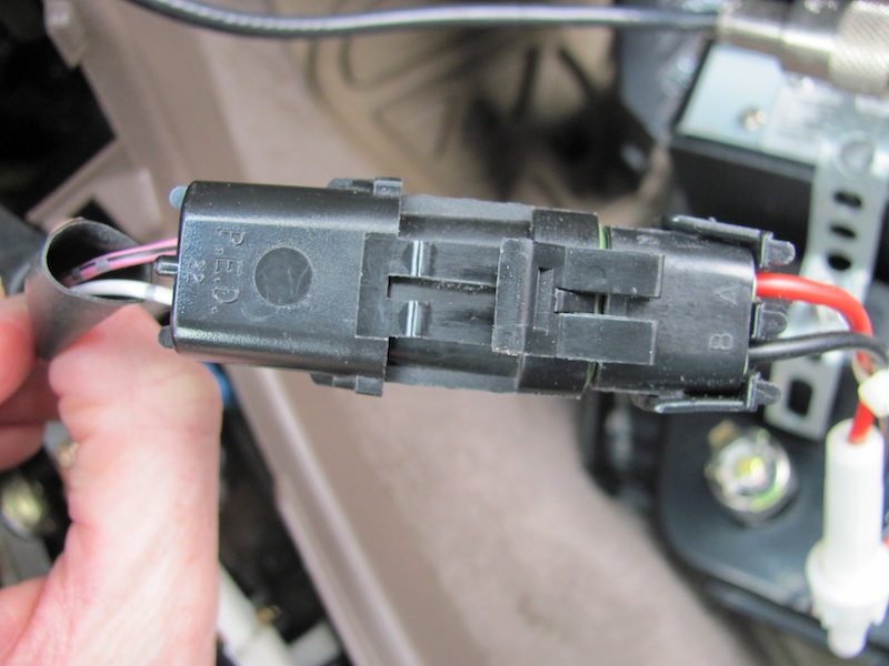

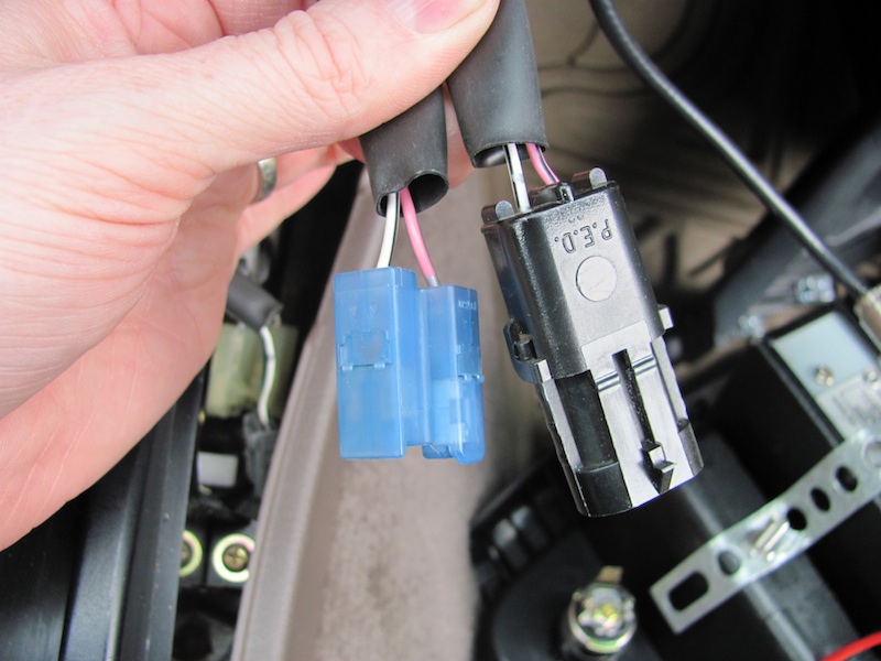

Here is how I did it:
Cut off one of the two auxiliary power port plugs (blue) under the radio and attached a female WeatherPack connector. You don't need this plug, I put it in to ease future dash removal. Using butt connectors works fine too, just leave enough wire to pull the radio away from the dash. Pink w black trace is Ignition 12v source, White w black trace is ground.
Easy.

That looks nice and easy/clean. Does this mean that the aux power you robbed no longer works?

Sort of. I took the plug off the lighter and put it on the aux port. So both aux ports work. If you look I used the lighter plug hole for a switch. If I ever need to plug in more than 2 things up front at once (never have, I tend to hard wire everything), I'll buy a splitter.
