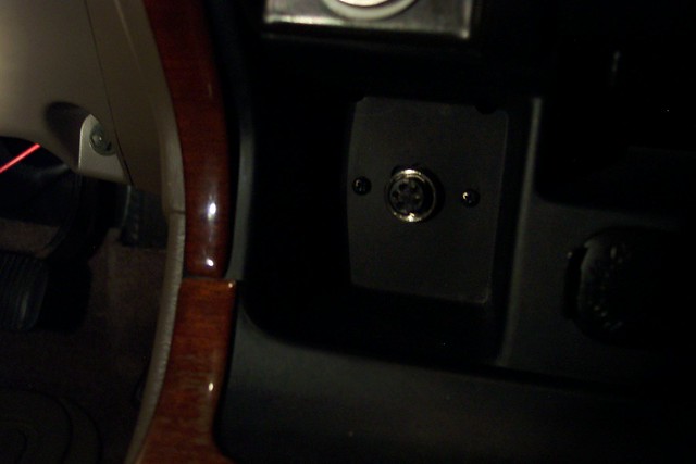

Who has them and where did you mount them? After I tackle swapping my dash over to blue leds this weekend, a CB is next on my list.
I went with the Cobra WX75ST, and mounted it behind the center console, with the connector being to the left of the 12v aux / under the cig lighter.
I keep the actual handset in the glove box when not in use.
I have a cobra 19 dx iv which fits perfectly in the ash tray area. For my antenna, I got a 4 ft. Firestik mounted on my rear bumper.
