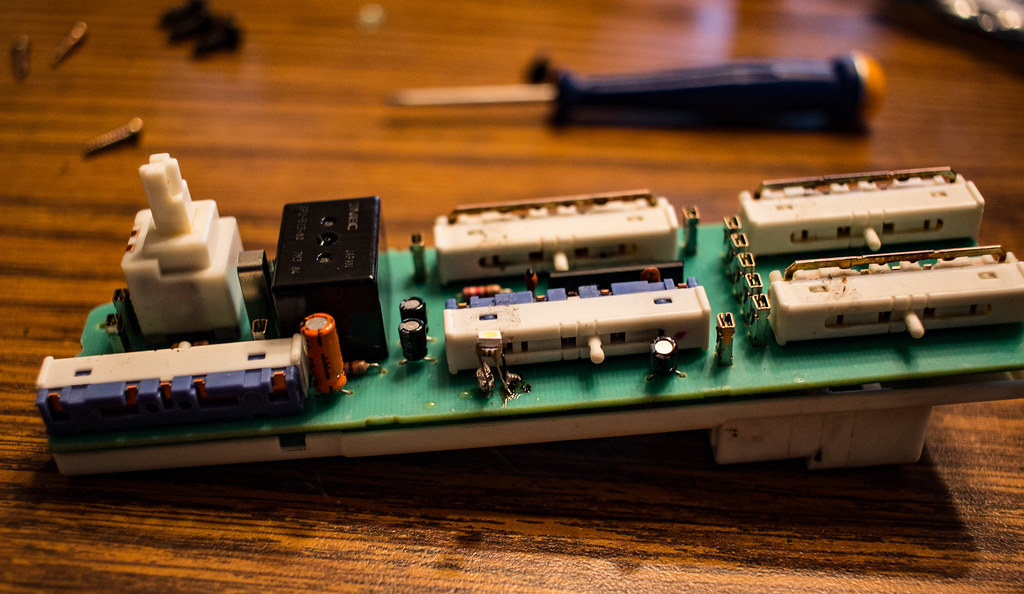

I took apart the the window switches and the ECT switches to swap LED's into them. Neither of these take a plug in bulb, the LED has to be soldered to the board on both.
Here is the LED soldered into place; not the prettiest job but it works:
What bulb did you order? I was looking at doing something similar this weekend
