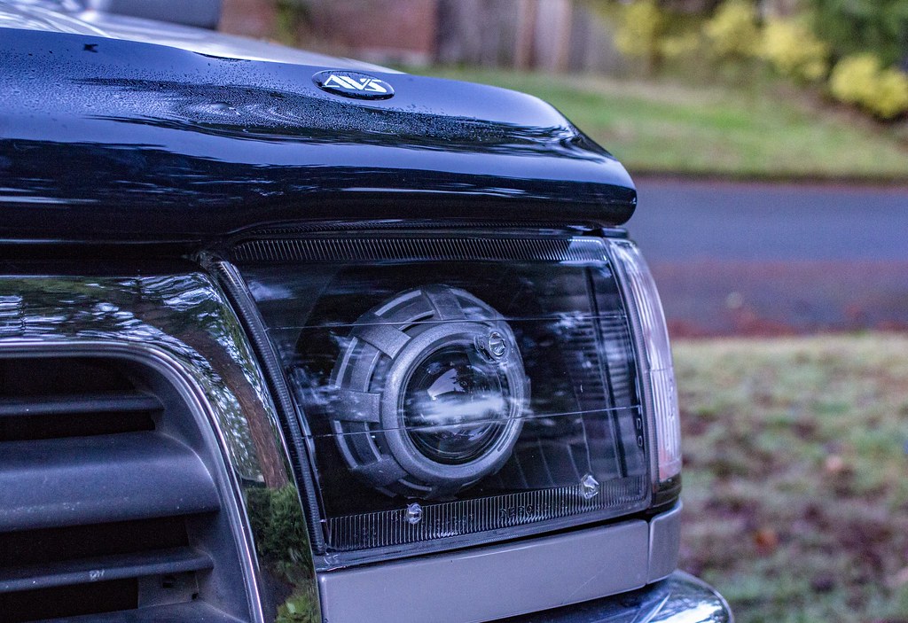

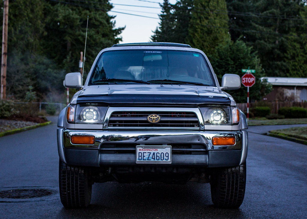

Retrofit 2.0
Hi everyone. So...I wasn't happy with the look of the retrofit so I re-did it.
This time I used the following:
Mini DS2 Projectors
Morimoto ballasts and H4 harness
Depo Headlights
Apollo 3.0 Shrouds
Profile Pivot Halos
4500K Lights
I had Paintscratch mix the silver cladding paint in a spray can and used that for the shrouds.
Anyway, I'm very happy with how it turned out. After seeing so many great retrofit projects here I was underwhelmed with my first attempt, this one is MUCH better. The old shrouds looked way too tiny in such a big headlight.

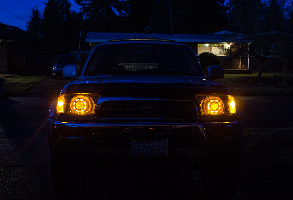

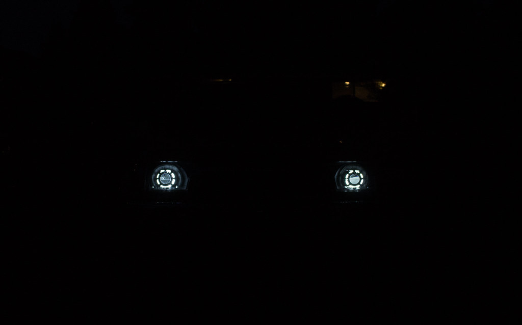

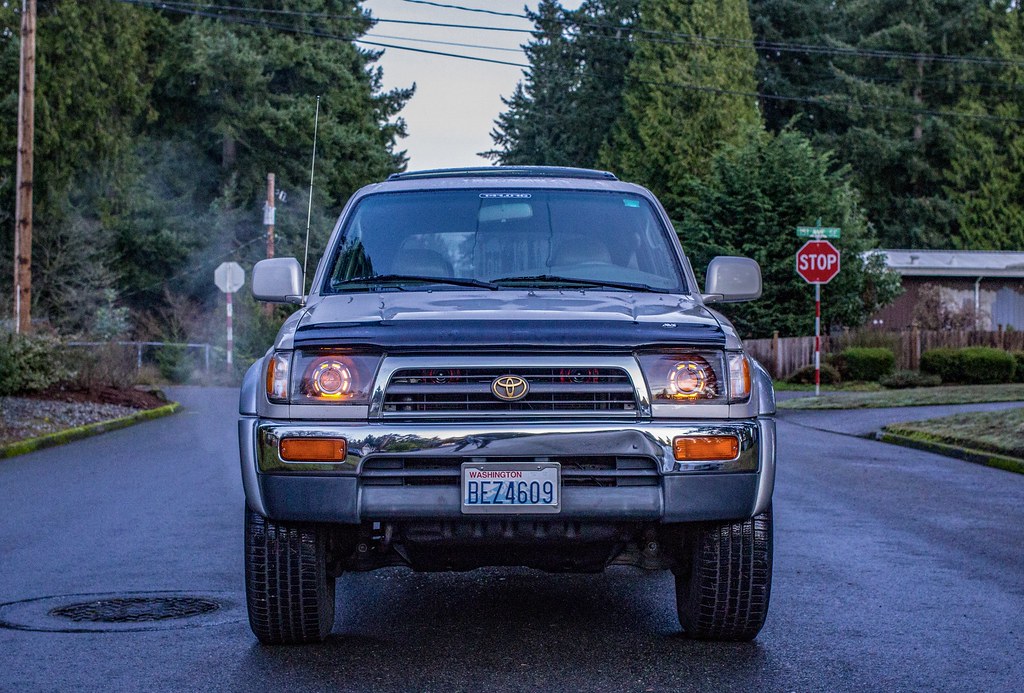

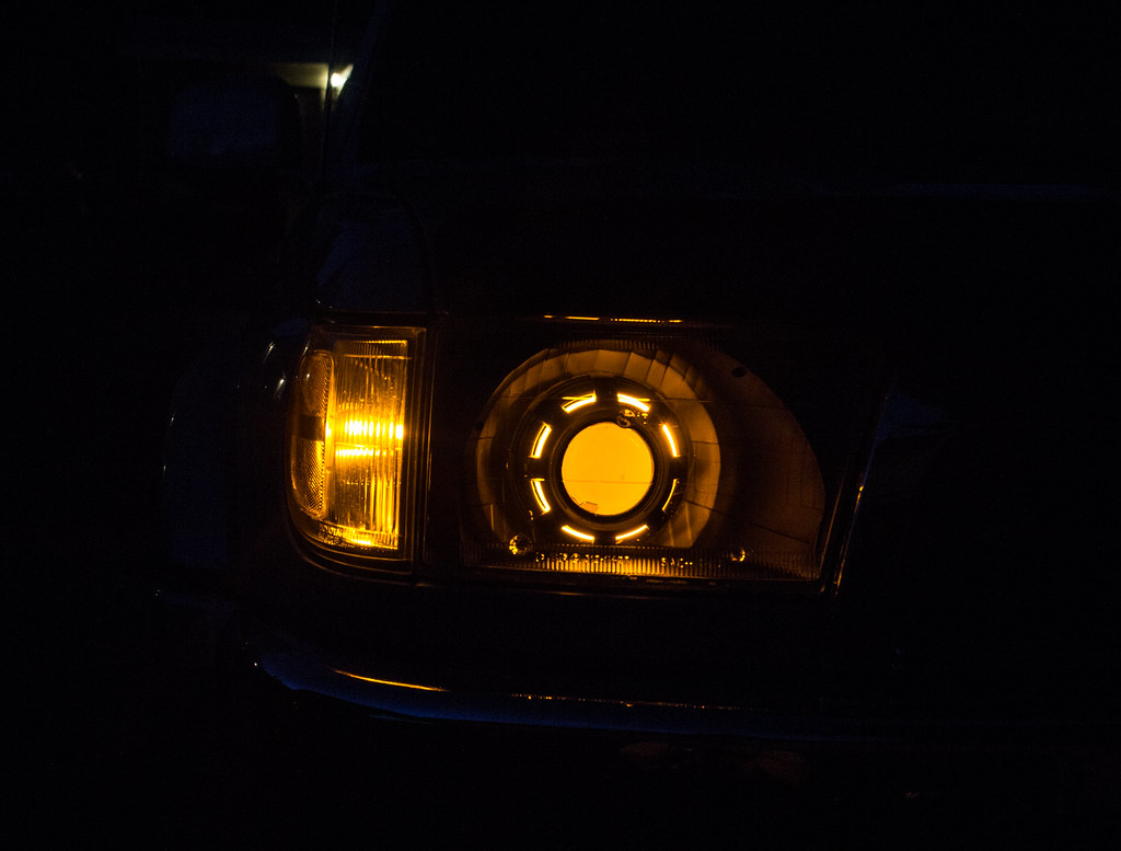

The halo rings can go either white or amber.
White:
They match the LED turn signal lights almost perfectly:
Pretty wild looking!

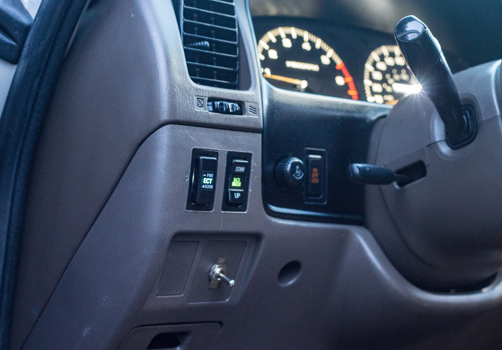

I wired the halo's to an on-off-on switch. I tapped into the cigarette lighter since it is a switched power. Will replace the switch with something better looking but it was the only on-off-on I could find locally.
It's a time consuming project and I have more time and money into these now than I care to admit but I'm pretty stoked with how they turned out!
