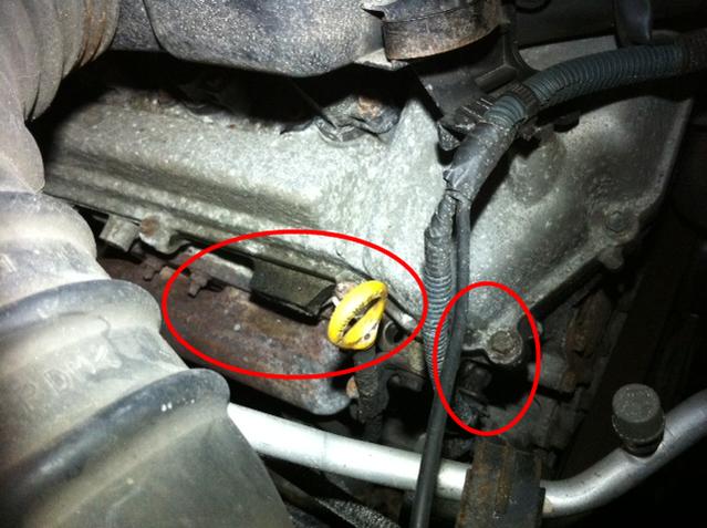

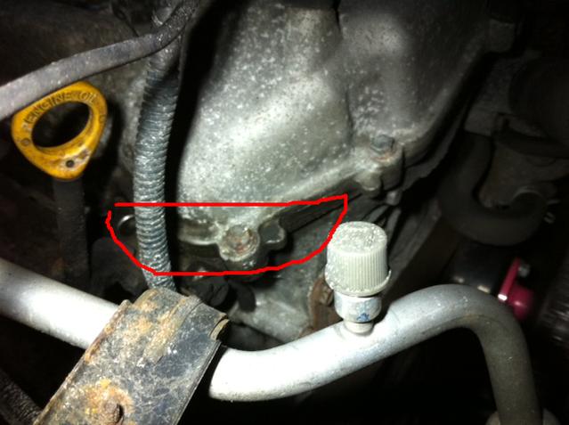

posting two shots I just took. is that a sign from HG blown/leak? if so, it started at least 2~3 years ago.
Passenger side, note the circled area. Not the way to start New Year I'd in mind for sure.
What does it mean for HG to be "blown", vs what, a less severe form of HG leak? So there are two HGs, one of the driver side, the other on the passenger side?
I am with you on the freezing temp exacerbating the leak. How do they number the cylinders, 1 to 6? standing in front of the truck facing the engine, does it start from the right/driver side , like below?

No. The #6 cylinder is the one closest to the driver's seat, the #5 is on the passenger side, #4 is middle cylinder on driver's side, etc.
I wouldn't expect to see coolant on the outside of your engine based on what you've described, but there could be evidence of coolant contamination on the inside. Specifically, take it to a mechanic (following having the codes pulled) and ask for a leak down test. You can also check to see if you've got hydrocarbons in your coolant, i.e. oil in there, or coolant in your oil.
You could also start by pulling the plug in your #6 cylinder to check and see how the diode looks. If it's suspiciously clean compared to another plug that would be another indication that you could have coolant leaking into that cylinder. The rough idle at start-up has been explained as the engine burning off the coolant that seeped in while the engine was off, with the position of the actual piston while at rest influencing how much coolant may get in there.
Again, as a V6 owner I hate hearing these stories, but with an '05 V6 at 160,000 miles, you're right in the sweet spot for this type of failure.

Thx. I also realized the stain/leak from the passenger side engine was from valve cover gasket, according to my own thread with input from BlackworksInc and others. So it's off topic here.
