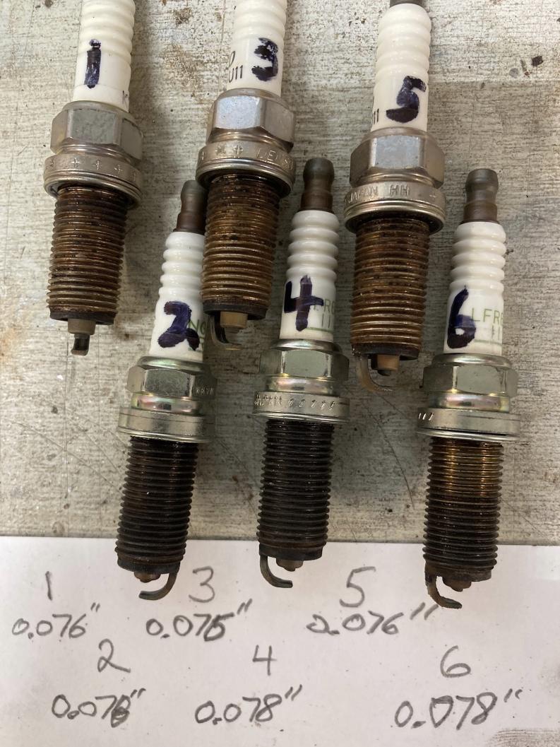

It looks like mine when I changed then at 222,000 miles, original warn plugs gapped at 0.076
