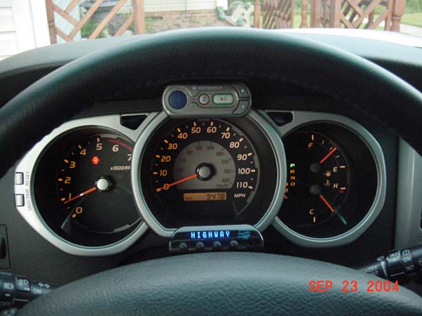

I have had nothing but complements on it. It sounds great, went in easy, is very easy to use. Even with the sunroof opened to ventilate (back tilted not retracted) people can hear me just fine. Even the voice dial works for both front seat passengers.
I know, nice cracked windshield! OUCH, dam rock trucks!
Next weekend a lift!

Mic is mounted to the A-Pillar. The install had no effect on the NAV Headunit. I put the speaker under the passenger seat and it works great. I have more than enough volume.
