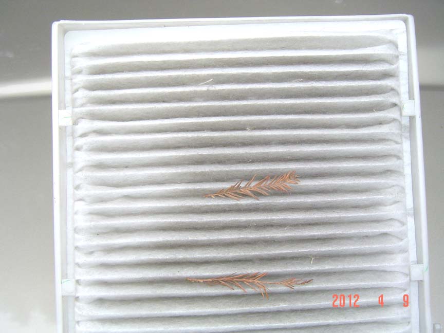

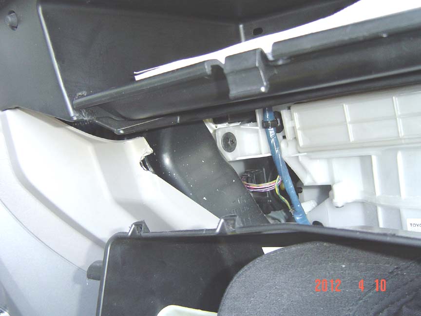

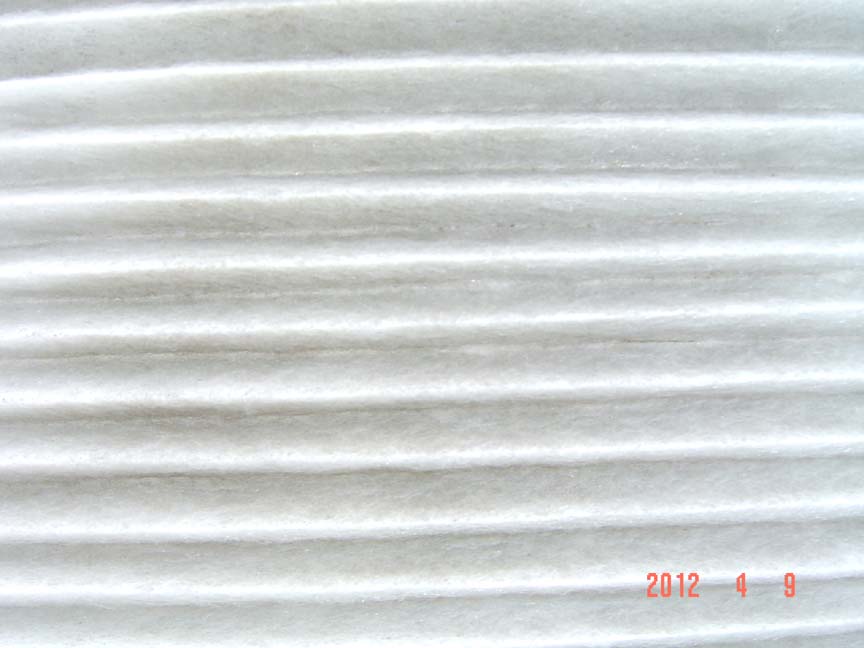

I got to my CPO 07 T4R SR5 V6 2WD, purchased at 43,000, 15 mo ago, added 4,000 mi since purchase. I can not tell if it was chance at this point because it w/n too bad and I used compressed air on it. Other filters and oil was definitely chanced and very clean. An invoice showed other items replaced or serviced and I checked all and they checked out OK. I forgot to check the cabin filter and wondered if it had one since the SR5 does not have a compass in the mirror.
It was a Bear to get one side’s ear past the plastic. I could see they had ground the plastic retainer slot on one side to make this an easy task. I ground the other side with a drill and rotary file but not too deep past the noticeable plastic (something is not too far behind the plastic, attached).
