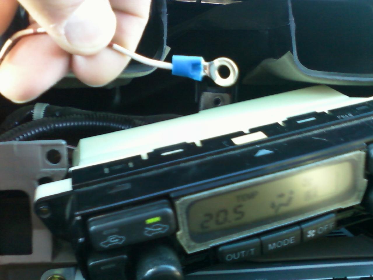

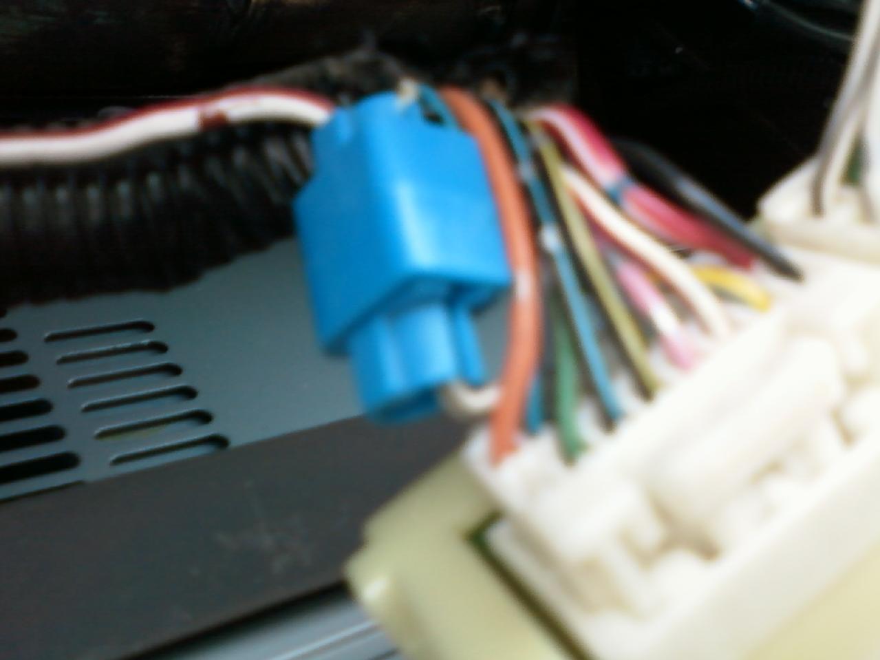

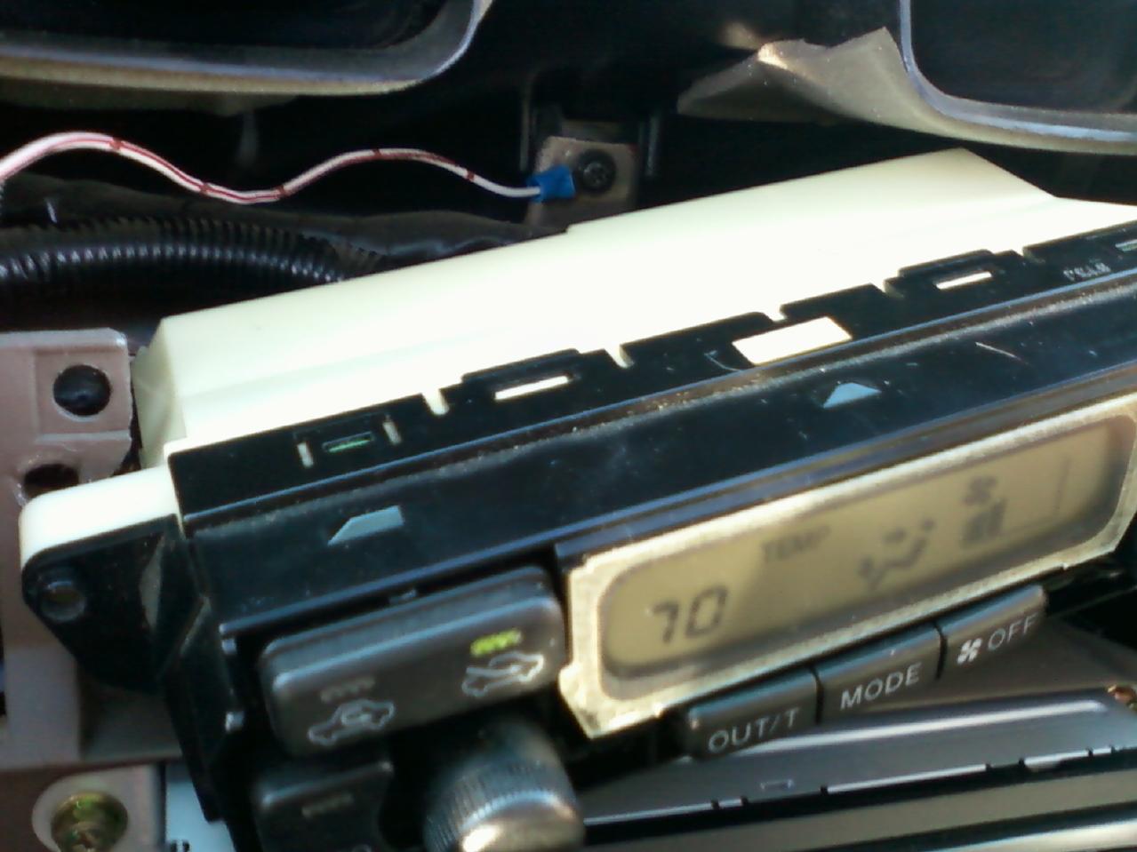

hello from south dakota.. if anyone is still wondering how to do this, i think i stumbled upon an answer. i have a 99 limited that must've come out of canada and i took apart the climate control b/c a few buttons weren't working. i noticed that there was a wire tapped into the left harness and ran back to a screw which is grounding it. when i take the screw out (un-ground it), the unit goes into celcius - put it back it, back to fahrenheit. has anyone else seen this? can post pics of it tomorrow when it's light out...
pics
first and foremost, had to show off my t4r.. finally able to drive it after fixing the dinged up front end!
so i'm not sure if this will change the outside temperature or not, because my outside temp button doesn't work (hence why i took the unit apart.) but it does change the inside temperature.
basically, they tapped into a white wire with a black line on it. if you are looking at the unit with the harnesses plugged in, it is the left harness, 3rd wire from the bottom left.
**disclaimer** i have no idea if this is why my climate control unit has a few buttons that don't work, or if i just have a bad unit. try this at your own risk.
