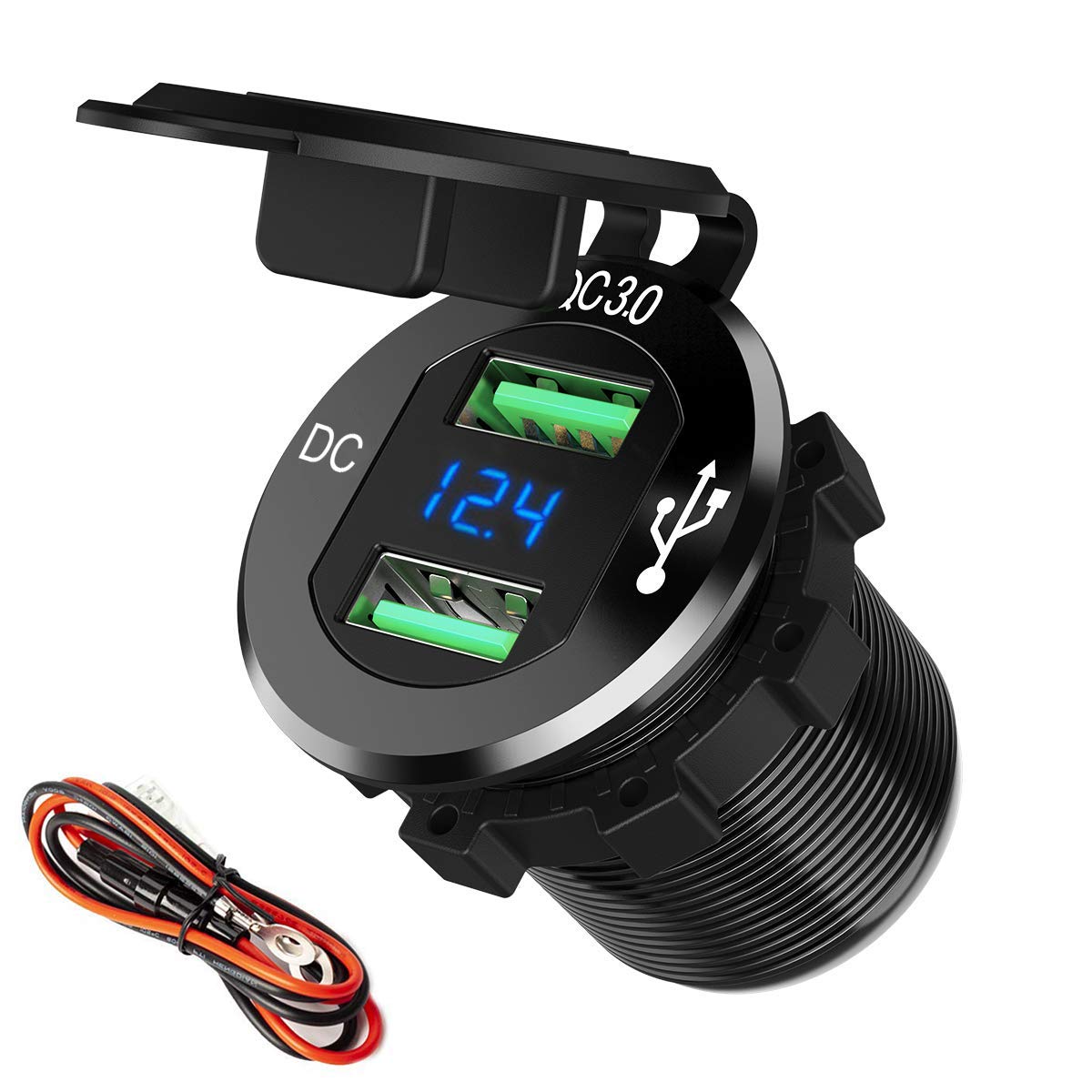

For the ease of use I was going to say just go with the flush mount style and save yourself the hassle, but sounds like you already explored those options.
You can modify that area, but its going to require some cutting / fitting since the OD of those panel mount accessories are generally larger than the 12v plug area.
Personally I would add one or two of those in a convenient location, instead of trying to remove the existing 12v accessory plug. I have seen people put them in the doors which is a nice area for that sort of thing.
Those panel mounts usually use a 1-1/8” hole saw like this.

I was going to suggest wiring the NEW USB device to the back of the "factory" 12V (Power Point) socket, adding the usb adjacent to the 12v socket and find a flat mount usb on ebay/Amazon for like... $6.00 bucks! It can look really good if the OP takes his time, paying close attention to detail.

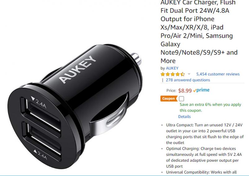

Use one of these and tell the little people to leave it alone.
That's exactly the one I have on the rear of my console but the covers don't close all the way, they stick up at about a 45 degree angle and get hit everytime my kids sit in the middle seat.
I would just remove the cover...
