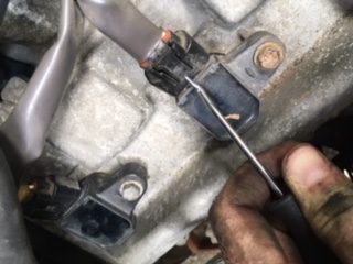

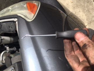

I'll comment that it was pretty easy once I got the wiring clip off each ignition coil. That was the real pain in the ass on my car. The car is a 2004 with 185K miles on it. I would press on the tab on the face of the clip to release the catch and then try and pull the clip off. I don't know whether the clip tab is weak or mine are just old, but pressing the tab with my finger and even a screwdriver would not release it far enough to be able to remove the wiring clip. After about 20 minutes or so of screwing around I remembered some auto hose tools I had. I found one of the smaller ones, pushed on the release tab with my finger and gently inserted the tool under the bottom of the clip. The clip then came right off. I had them all off in two minutes. Then I did all the other steps to complete the job. See pics below:
Here is a picture of the tool
This is what I mean by inserting it under the retaining tab. I had to use my right hand to take the pic otherwise it would be in the picture pushing down on the top part of the tab, inserting the tool with my left hand, and then pulling the clip off while my left hand holds the tool in place.
So just use one hand to push on the tab and then gently insert the tool under the bottom of the tab just enough to raise it a bit more. The clip should come right off. BE CAREFUL: Don't jam it in too far and snap off the clip. You only want it in far enough to hold the tab open. It doesn't take much to do this.

I finally changed the spark plugs on my 2004 V8 and used some of the threads that document how to do so. You can easily find them. The basic steps are as follows:
  1. Remove the ignition coil wiring clip
  2. Use 10mm socket to remove ignition coil bolt
  3. Remove ignition coil and rubber gasket
  4. Remove spark plug
  5. Install new spark plug and torque to 12 or so ft lbs
  6. Clean ignition coil gasket and lube with silicone spray
  7. Install ignition coil and bolt
  8. Re-attach wiring clip to ignition coil.

I just did that last weekend using the pick and flat head to pry the clip off. My first time switching on the Runner.
05 V8 4runner
Thanks for the write up. I just did this last week and noticed that the hardest part was getting those connectors off of the coils. Good idea on using a small brush to get dielectric grease on the backs of the plugs. :)
There's definitely a "feel" for doing this. It's how I take connectors off of spark plugs because they're notorious for breaking. I use a pocket screwdriver to push the connector off the coil after using a pick to gently lift it up.
