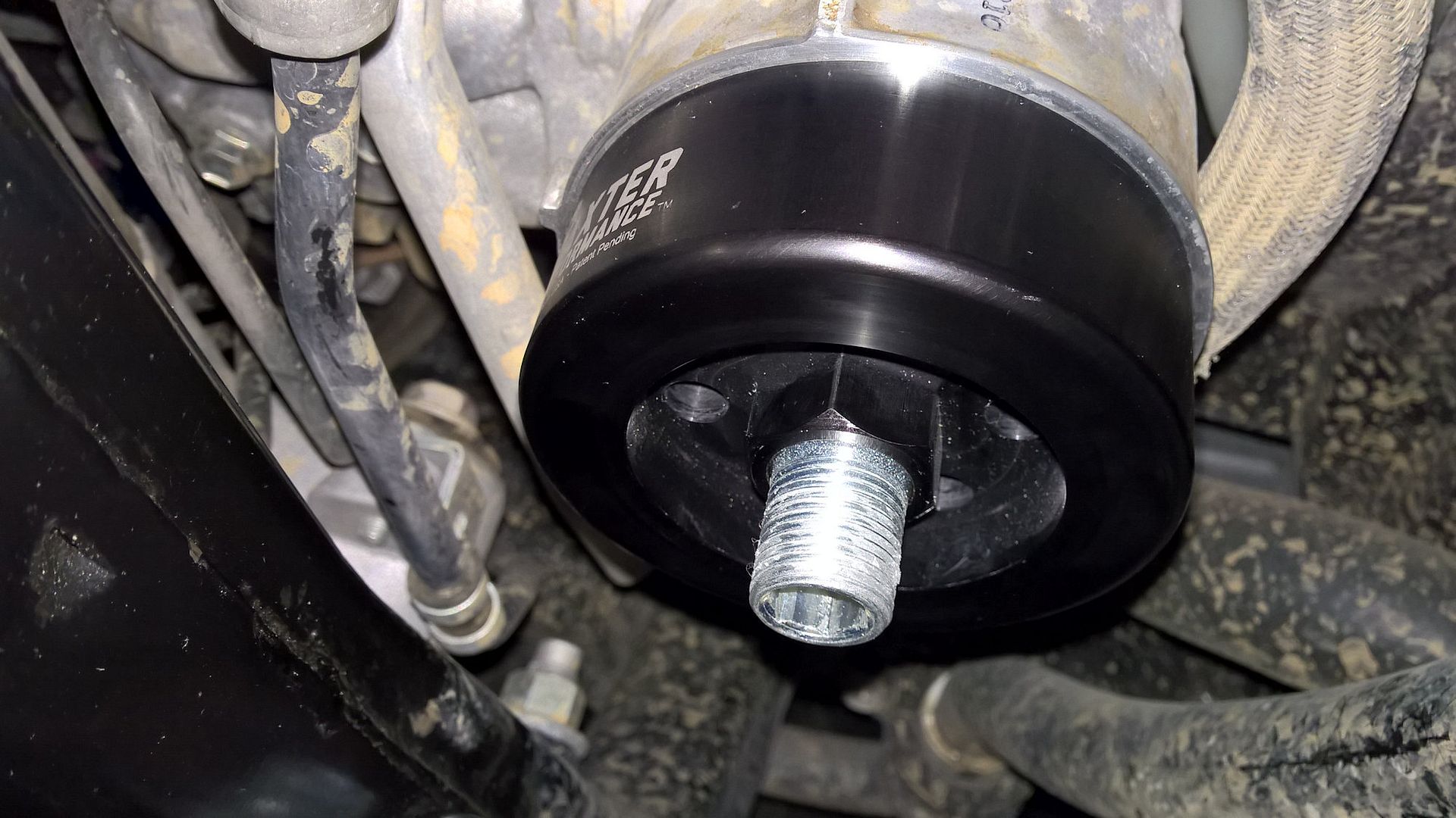

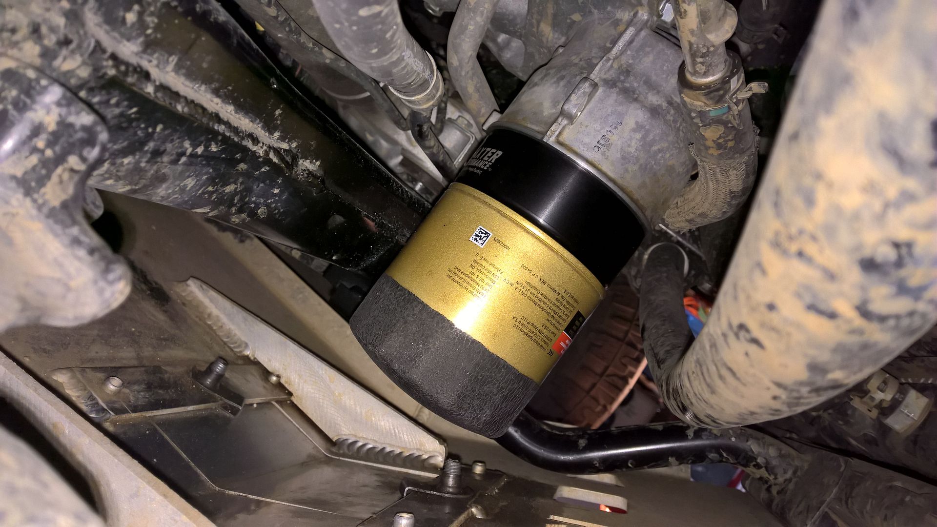

I don't expect there to be any issues with this mod,it was pretty simple and not near as complicated as say doing a front and rear lift, (not spacer). The Here is a couple of pics of the install. The Baxter part is very well made, heck it's a piece of art, and the Fram filter is highly rated.

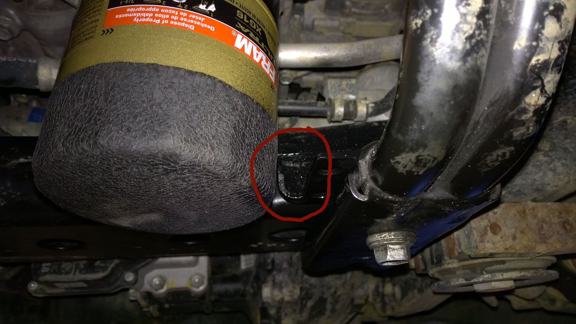

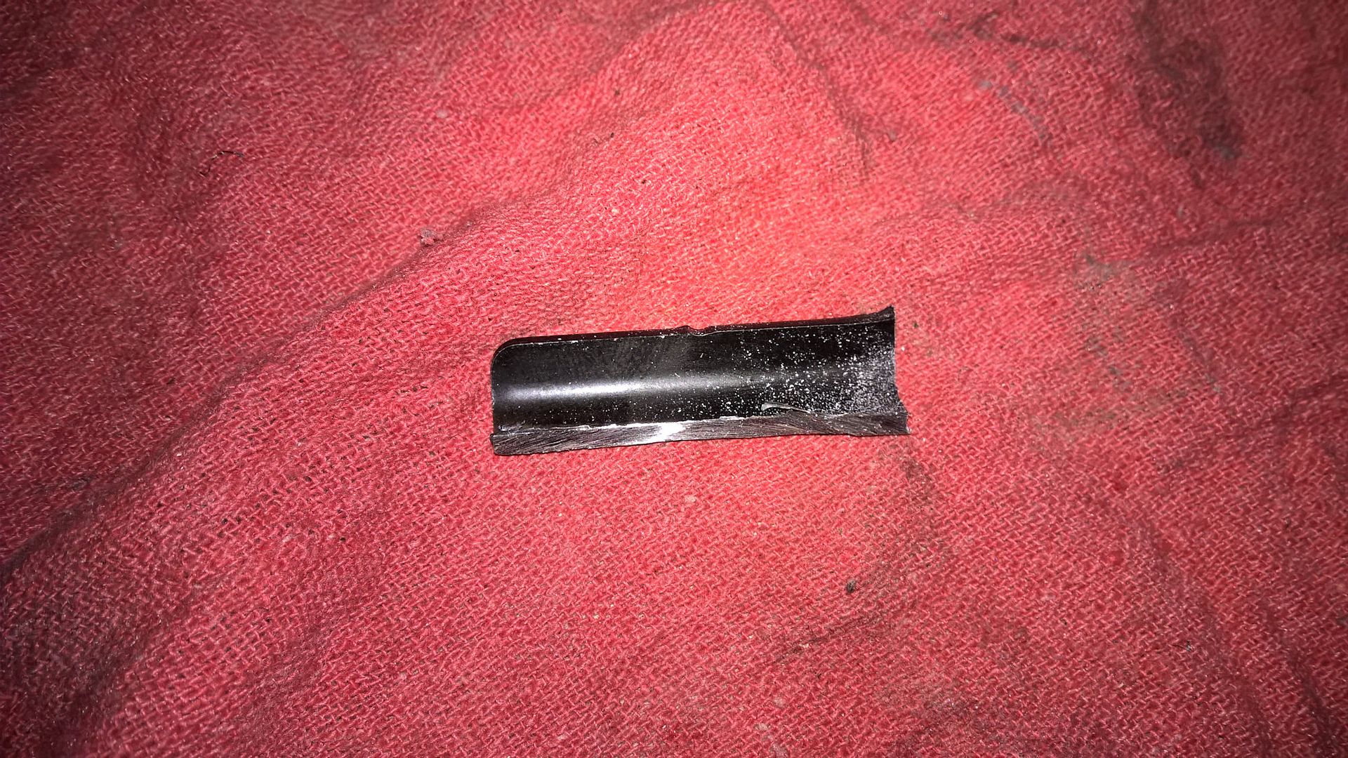

So I used the Fram XG16 because it is the biggest I could comfortably install however, I did have to cut a un-used tab a bit to make sure there would be no issues when the engine flexes on the motor mounts, to 2 minutes to cut and paint. Baxter recomends the Mobil M1-102 filter which is plug and play. I wanted more surface area so I went with the XG16.

Baxter installed.
The piece cut from the un-used tab. About 2"x.5"
Where the tab was cut.
Finished product,, tons of room and can still access the filter through the "door" in the RCI skid.
