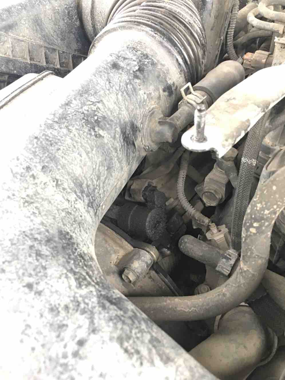

Alright so I know there's a topic or 2 on her about rough idle however they didn't seem to be the same issue as mine. It rough idles around 500-700 rpms and it putters and sounds like it's going to stall. I'm checking for vacuums leaks, I'm going to clean my MAF sensor and throttle body tomorrow morning and replace the pcv. I'm also showing a misfire code but I'm hoping it isn't bad coils so I'm going to swap the coils from the bad cylinders (2 and 6) to the opposite side of the motor and clear the code.
My question to you guys is, what is this part, what does it do, and what is the proper way to clean it?
