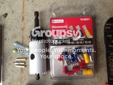

So I have started my build kinda... starting small. I am starting with a power mod for the passengers that gshadow325 posted over on toyota120. It is awesome!! keeps the peace and the charge.
So I haven't started my build page and was thinking I should for fun and for myself to look back on the transformation. I haven't got the build planned out completely and already have changed my mind on components like 9 times, which is part of the problem of why I haven't started it yet.

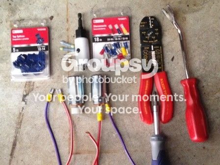

Anyways, I have started with small mods and I have to give credit to gshadow325 for the power outlet mod in the doors. Here is what I am starting with. The hole saw is a 1"/25mm, (if you can find one go with a 24mm hole saw; the one I used was just a tad too big... it worked good thou) the wire is just left over from a auto start installed I did, purple will be my ground, red power. the wire is probably an overkill on gauge but it was what I had. The clips used to attached to the lighter outlet fit nice and snug. I will post the actual installation pix once done.

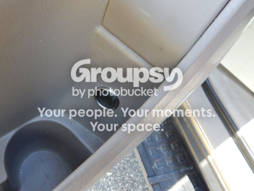

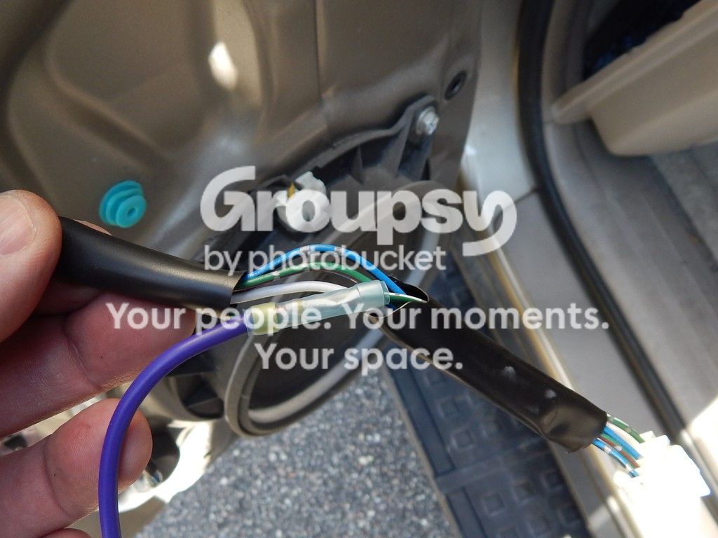

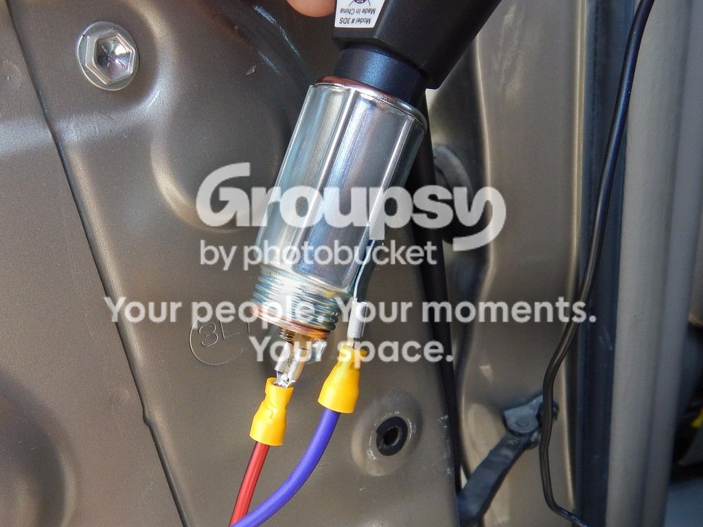

Here is the 12v door outlets installed... put one in each of the back doors.
Here is how I got to that point
cut and spliced into the Green w/ white striped wire for ground
Did the same with the white wire for power and used the yellow disconnects for connecting to the outlet

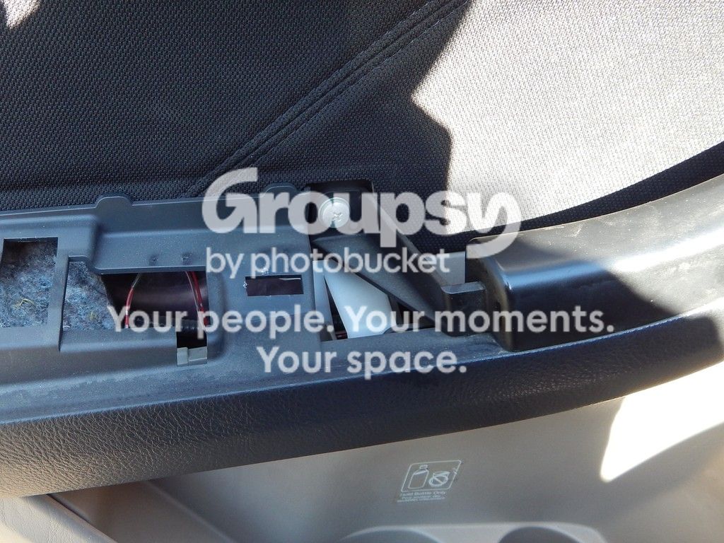

To be able to remove the door panel I removed these two screws
Then put it all back together.... easy peasy

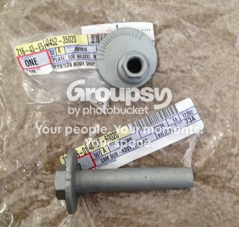

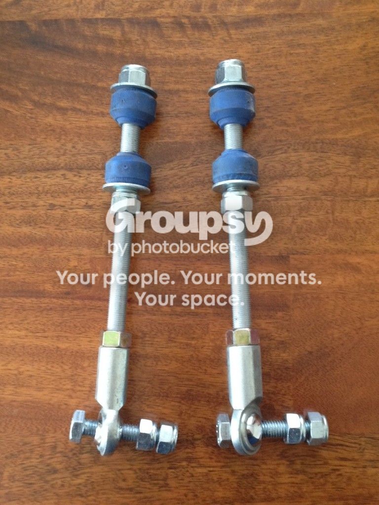

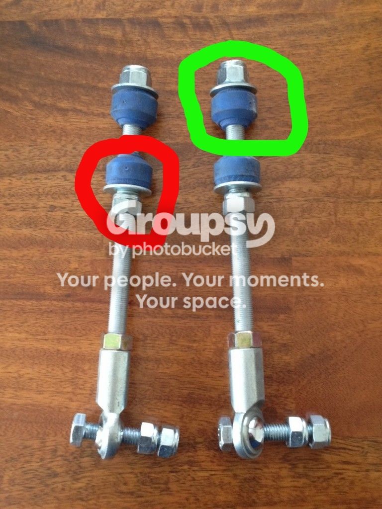

SO.... I have this that I have had for when I do my lift... Finally getting around to it, on that I am done with my masters...
I want to make sure I am installing them correctly.. not like there is too many possibilities to do so... but I have been proven wrong before...
Anywho, the install it self is, or should be pretty simple... it is the adjustment I need assurance on... once in place... you raise/lower the lower nut (circled in red) up/down until flush with bottom of bracket.... then tightened the top nut (circled in green) down until tight on the bracket? anything else that needs to be done afterwards? I know I need an alignment once done with the lift.
Thanks in advance for the help and advice
Haven't installed these particular ones before, but that sounds right. I made a set myself. I would suggest using some bushing lube on them during the install, too.

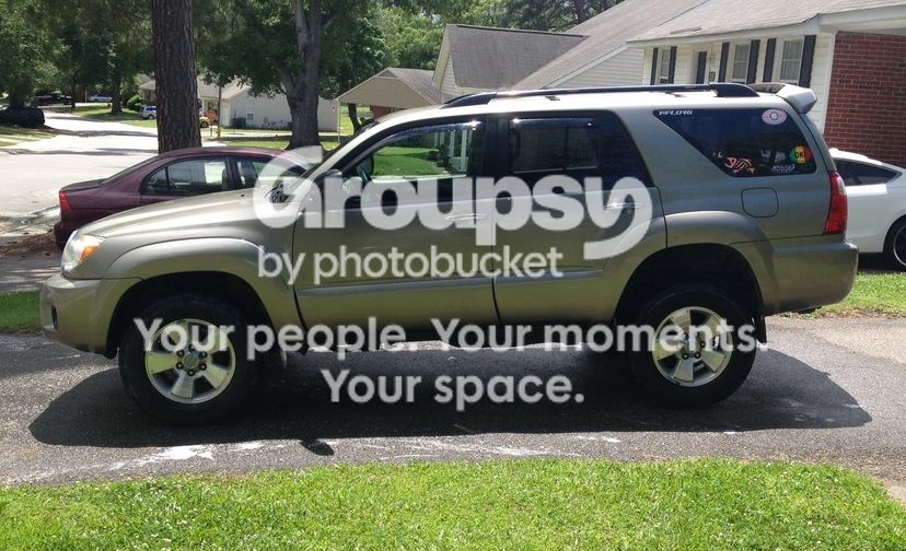

So lift complete, spacers installed and loving it!!!! Need to get an alignment after I replace the Cam adjust sub-assembly and rear plate..
I haven't taken pix yet of it, been working on other projects. Will post some soon... :worthless
Loving the ride and the look!!! and the Spacers!!!

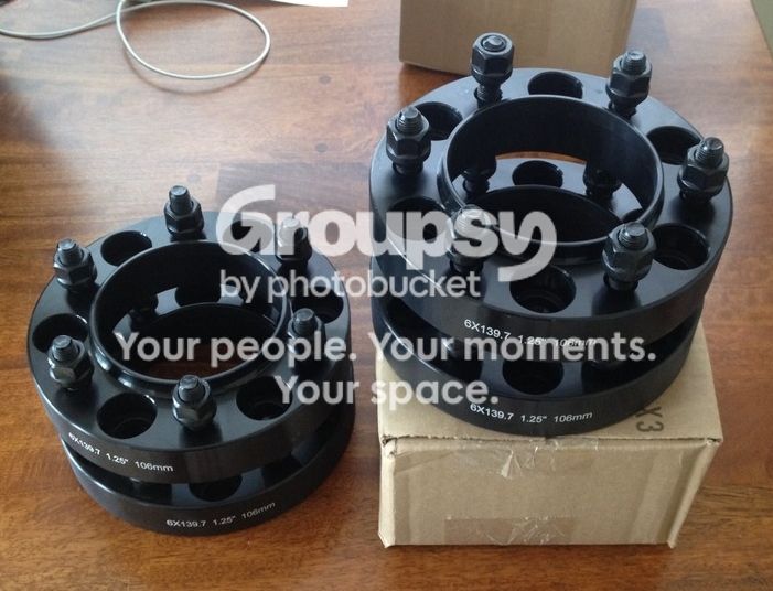

These are the spacers I installed...

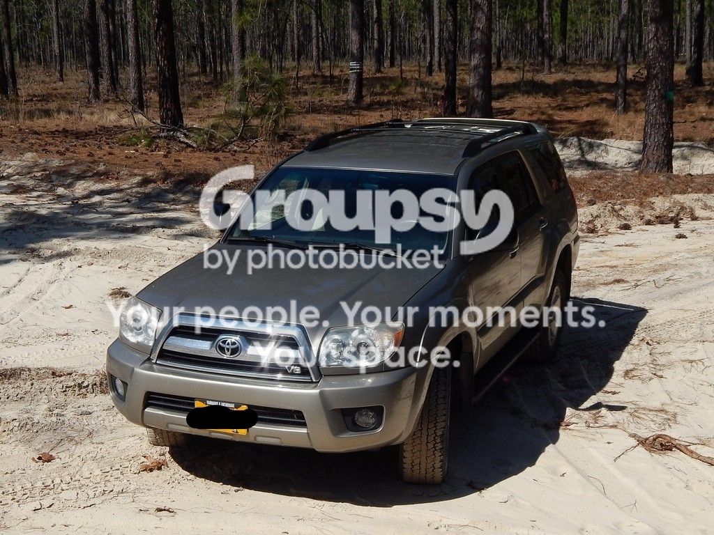

So here it is after the bath it got for going out and getting stuck
Another view after washing and it is on a slope but it still has too much nose down for my liking. I am getting 2.5" front spacers to bring the front within .5-1" of the rear.

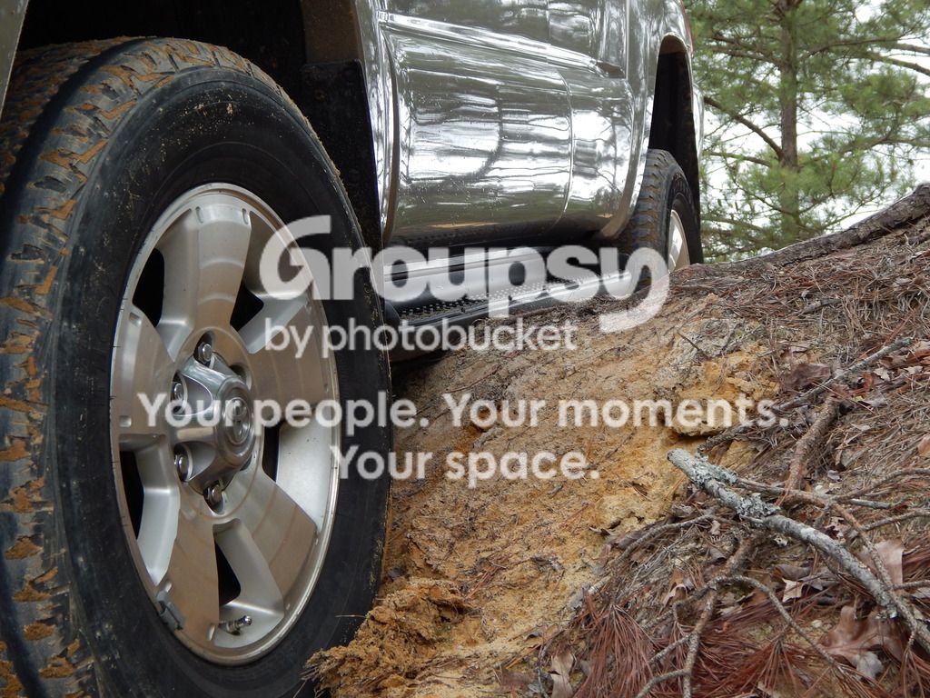

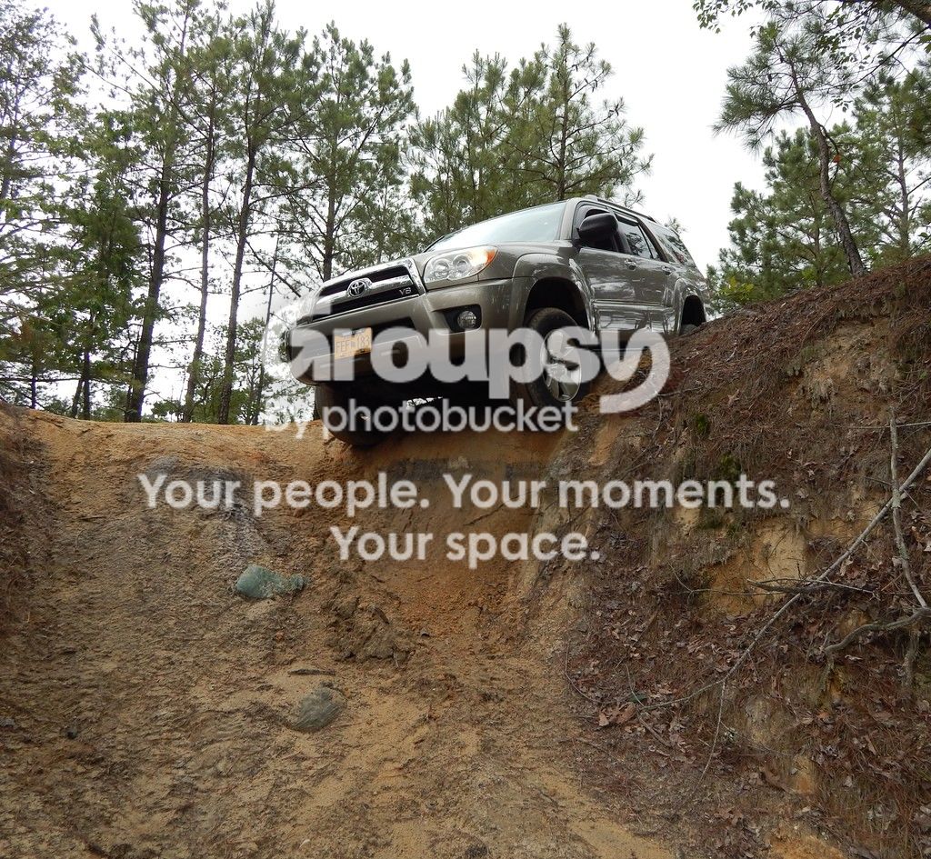

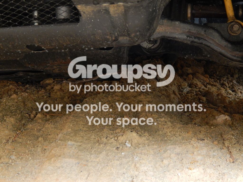

Here is what happens when you do not recon the site first and hit the brakes at the last second when you realize you F!@K up!
Underneath
Side
And frontal
Course it didn't help I need new tires as a result of needing to replace the Cam adjustment bolt and needing an alignment. But all is well and was fun. Definitely looking to go out again soon!!
And yes I removed the side steps. Wanted to see how she looks without them. undecided whether I'll put them back on or not.
I wasn't going anywhere without help. I was high centered and tires just dug in. I got pulled back off the ledge.
