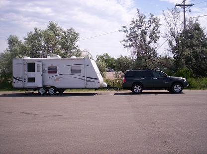

This week I took our 4Runner in for 15k mile service. According to Toyota
If a warranty claim needed to be filed they could claim 5 miles of towing means 'used for towing' as a way to hassle you. At 5000 miles worth of towing there's no doubt you should maintain it to the towing standard.
I have thought about this and edited this: I would change the axle and t-case at 15k. It still has the original fluid in the axles and t-case. During breakin the oil gets hotter than normal and some extra metal shavings. This is especially true for you as you work your T4R by towing. Get the beat up, metal flaked oil out by changing it at 15k. After the initial change a 15k change should be done as long as you keep towing. And yes, I would do my t-case at 15k then as prescribed.
The transmission should be done at 60k and that interval is probably just fine.
