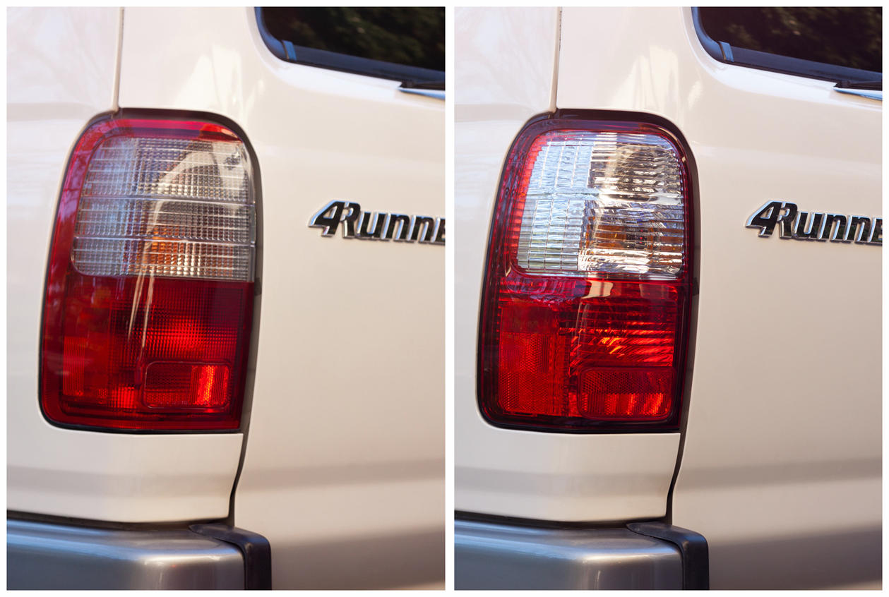

Just bought some used 01-02 tail lights off eBay!
Came with the entire wiring harness, so just had to remove the old ones, and plug the new ones in.
Was a little bit of work, as you have to take off a bunch of body panels in order to get to the plug and ground wire, but well worth it.
Love the new look!

just double checking but the tail lights and headlights are interchangeable for all 3rd gens right?
The tail lights you need the 01-02 wiring harness with it, as they changed the size of the reverse light, and the 96-00 reverse light won't fit. Other than that, it slides right in, and hooks directly up to the old plug. All functions (brake, turn signal, and reverse) work perfectly.
As for headlights, I'm not sure. I'm pretty sure it'd be a direct fit.
I do know that theres a 96-98 style, and a 99-02 style.
