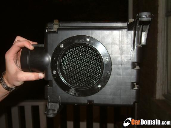

Because of sitting in a cubicle all day now, ive been looking on the forums a lot. As a result, the other day after work, my buddy and I did the deckplate mod to my car. I only found a white deck plate but painted it black, and i added the screen which i think helps keep a LOT of stuff out. I notice a huge difference in sound and pickup. I also tightened the throttle cable which helped with pick up too. However, my gas milage has been destroyed. I attribute that to "mmm more power and it sounds so good so i'll floor it all the time now" but once im done flooring it all the time, i know the mpg will be better than before. I also ordered the amsoil drop-in through boaz so when i get that it should improve even more. The next thing im thinking about doing is a borla/trd exhaust but i kinda like having my t4r be decently quiet at lower rpms and throaty around mid to high rpms. If i really had money and really wanted a super fast t4r id do what i saw some guy on cardomain do...add a supercharger, nitrous, exhaust, etc. That thing is FAST.

well the advantages to deckplate vs hole are pretty good. first off, i think i read that most people screw the deck plate back on in the winter and when they go offroading. If im correct, your t4r is 2wd so i dont think you'll be offroading and therefore, not a problem. The reason i chose to put in a deckplate as opposed to a hole are as follows:
1) Other people have done it and therefore I felt safe doing it.
2) if i messed up or didnt like the results of putting a hole in my airbox, I could simply screw the deckplate on and its back to stock performance.
3) I really liked the screen idea (take the tube clamp and a piece of screen and clamp it to the part of the deckplate that sticks into the box. Theoretically you could simply take some silicone and glue it to the inside of the box but im disregarding that)
4) Its like the reason i bought a crappy little toolkit from advance autoparts and the same reason you buy insurance: in case shit happens. You might not see a use for it now, but its better to have it and never need it than to need it and not have it. One of my friends' old car died because the intake he had sucked up too much water. You might not need it for water now but what if you did and didnt have the deckplate to screw on and it resulted in you needing a new car?
5) saying you did "the deckplate mod" sounds a lot cooler than "i cut a hole in my airbox"
I might even screw my deckplate back on for a little to see the difference and to keep my from wasting gas by flooring it all the time to hear the results.

hmm thanks for the reply jpless
btw, when I screw the cap back on for winters, do I have to pull that one fuse (forget the name..ECU?) to let the car adjust itself again?
Oh and would I need an aftermarket filter for the deckplate mod? Or am I safe with the stocker
you dont have to do anything. It would be a good idea to take out the fuse and replace it i believe (basically all i know is that doing that is supposed to make the car "stupid" and thus relearn how to accelerate according to the way everything is working, thus when you change things, you should do it) I'm using my stock filter right now and notice a difference especially in sound but im getting the amsoil filter because replacing the filter adds to the benefits of the mod. The deckplate mod allows more airflow into the box but the air still has to go through the filter. Therefore, most people who do the deckplate mod also replace the stock filter with an aftermarket, high airflow drop-in filter. The filter a lot of people use is made by Amsoil and i just got one for $31 and change from t4r member Boaz (check the performance products forum, he has a thread). Swapping the filter allows more air to go through the filter, therefore not replacing it would result in less air going through. The deckplate allows more into the box, the new filter allows more of that additional air to pass through the filter into the engine and kaboom, more power.
