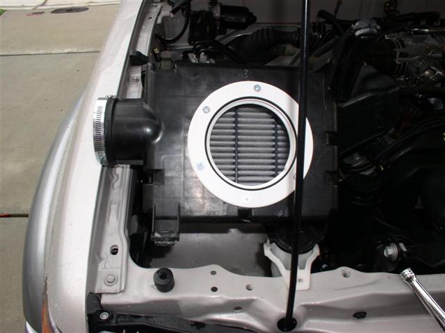

Here are a few pics...

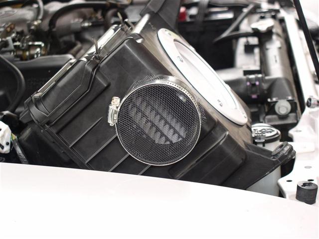

I screened as well but i put the screen on the deckplate. If you reach in where the filter goes and use the same technique for putting the screen on the elbow you'll end up with the same thing i've got (deckplate mod wise). I prefer this because it keeps leaves and bugs and other large debris out of the box. Pic of it is shown on page1 of this thread.

Well yea my screen is a little big but it seems as if you didn't screen the deckplate and only screened the elbow.
The ecu: open the fuse box, look on the inside and it should tell you. I have a 98 and on the left side of the fuse box (if standing at the front of the vehicle) has like a 20amp fuse with 3 15amp fuses below it. The middle 15amp fuse is for the ecu. Check the fusebox diagram tho (should be stuck onto the inside cover of the box or in the manual...also search this site and yotatech.com forums if you don't find it)
Thanks for the ECU info! Yeah I did screen the DP. You just can't tell in the pic.
You got to look real hard. lol
The reason I took the elbow out along with the deck plate because I want the least restrictions as posible. Also I noticed that the elbow picks up ALOT of dirt from the fender well. At least now the box has an extension pointing in that direction but nothing to restrict it and suck dirt from the well as much as it did before.
