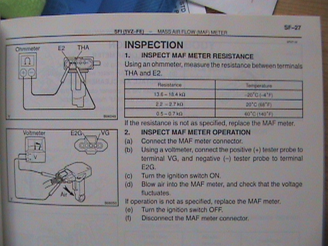

I would bet money that its a bad MAF sensor. Go get one from autozone and switch them out while your there, and if its the problem, then keep the maf and give them your core, it will end up being 90 bucks. And if its not your MAF then just take it back out and return it.
I had this problem too, i would clean the maf sensor, reset the battery and then once it the computer cycled through and the check engine light came back on it would run like sh*t.
this is where an actual scan tool (not a code reader) would come in handy. You could use a digital multi meter as well though. put the multi meter on the maf signal wire and monitor the voltage. I don't have any datalogs from the truck on this computer anymore, but i'll try to throw the innovate in before i leave for work and get you an idea of what the voltage output should be. I would also suggest checking fuel pressure, and maybe running a good injector cleaner (i prefer redline brand), and double check the intake tubing and manifold for vacuum leaks first.
I would check for any kind of vacume leaks like around the PCV and also any other vacume lines. You could also check for air leaks after the MAF sensor on the air intake. Like 00Spork said the MAF could be the culprit. Also do not discount the IAC having a problem and allowing to much air all the time. Just some more ideas. I had this code once on my 2000 4runner but cleaning the MAF took care of it and you have already done that.

This really requires some special tools, but the injector volume should be between 60-73 cubic cm or 3.4-4.5 cubic in. You can also test the injector terminal resistance, it should be approx 13.8 ohms at 68

Thanks man. Time to find a friend I can try and swap mine out with.
yeah, i hear you. advance auto parts let me throw it in there to make sure that was it. you may want to ask them if they will return it if that's not the problem. it can easily be done in the parking lot with a phillips head.
