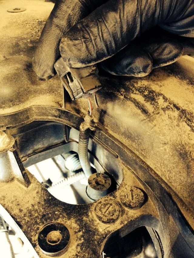

Code for mine came back as P0020 camshaft timing control circuit malfunction.
The Toyota dealership tried to clear the code and it wouldn't go away.
Turned out to be a wire on the connector for the oil control valave = frayed & broke. They soldered the wire together, cleared the code & I was back on the road. 2012 Limited 4Runner.
