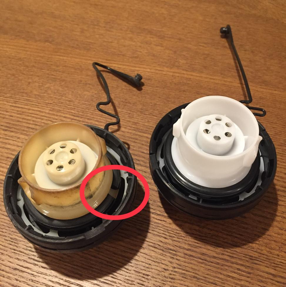

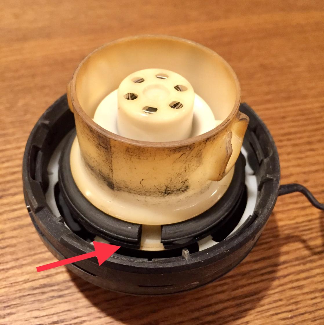

Had this problem and resolved it.
Gas cap. I had already checked to make sure it was tightened but still had lights. On closer inspection, the rubber O ring had cracked. Replaced it with an OEM Toyota (~$20 on amazon) and all lights cleared.
Check your gas caps carefully.
