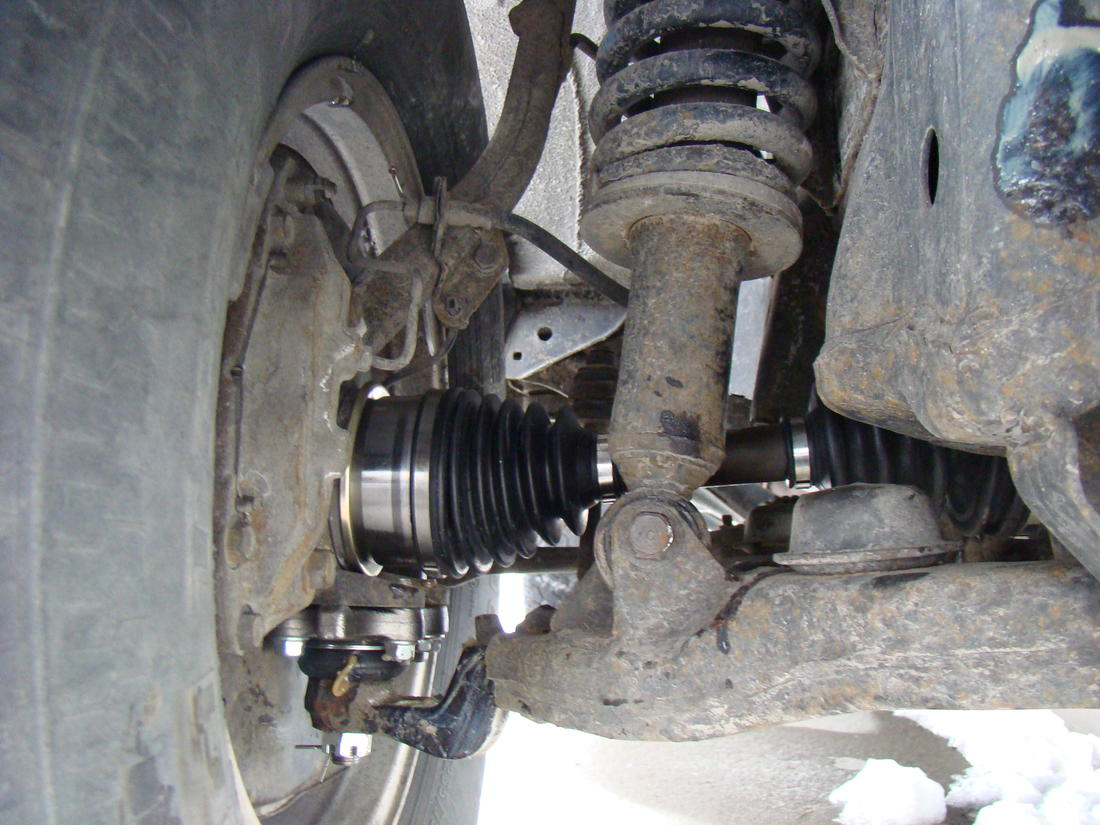

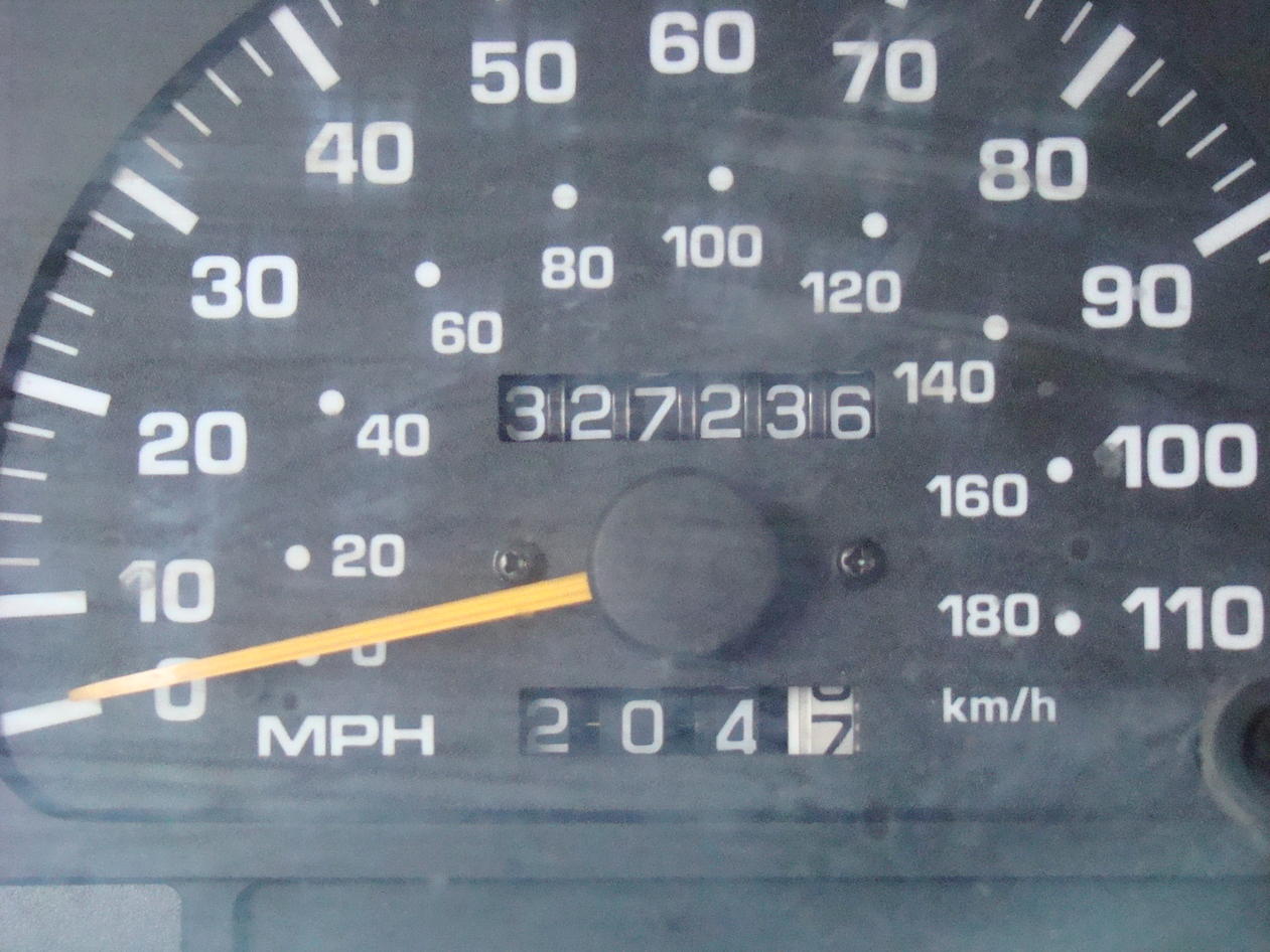

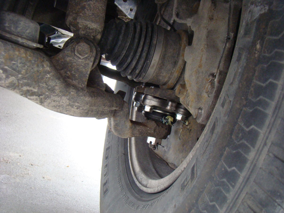

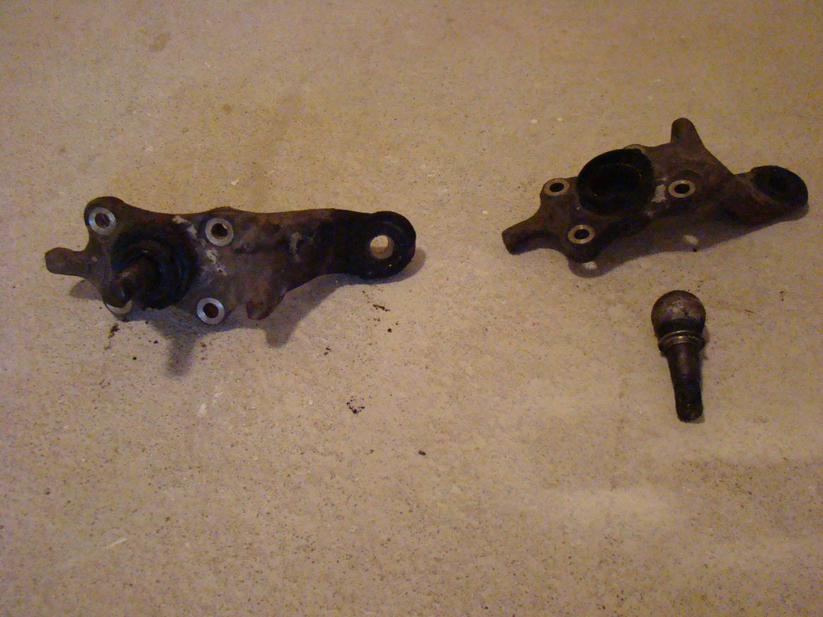

After basically 327,000 trouble free miles, I had my first mishap today: Driving to work and the 4Runner was shaking a little bit oddly. Concerned, I turned off on a side street, slowing down to about 5 mph and BAM…the right end crashed down to a complete stop. Looking at my front wheel which was now leaning at about a 45 degree angle, I knew that I had at least a busted a lower ball joint. Had a flatbed tow truck ($100) take my rig to my buddy’s shop and we assessed the damage. Besides a busted lower ball joint on the right side, the drive axle was broken as well. The driver’s side ball joint looked pretty worn so we replaced that too. New drive axle was $96 and the lower ball joints were $115 apiece for a grand parts total of $326. Luckily labor was free but it would have been at least $200. I can’t imagine cruising down the highway at 70 miles an hour and one of these breaking. So my advice, CHECK YOUR BALL JOINTS!!!

No pictures of the carnage? I replaced both LBJs on mine as soon as I bought it after seeing one too many threads like this lol.

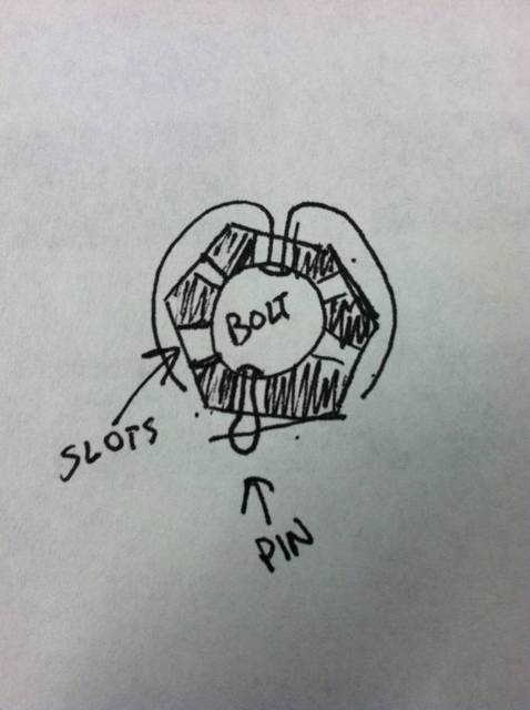

Tell whomever put the new ones on to tighten up the cotter pins correctly.
Yep had the same fear as my boots were in horrible condition and the drivers side was loose. Now it is just OTRE and UBJ and I will be good :)
What do you mean by this?
Meaning that the both sides of the pin should be bent but as long as it is through the hole and can't be pulled out then should be good. Proper way I was taught was to not cut any off and wrap the end around the nut.
(Yes I just drew that at work lol)
Im looking at this on my phone so it might just be me, but are the boots ruptured already? These joints wont last as long as the first set.
I have the same question as grease is squeezed out from what looks like a hole but then again that could just be so the grease doesn't "blow out" the sidewalls
The tighten part had me confused.
Mine for my 1st gen were like that, when i pumped them with grease it slowly started oozing out of there. I think only the non-grease-able ones are sealed.
