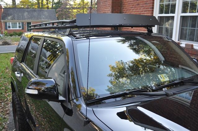

So, the GOBI.
I elected not to have the crossbars installed in the rack. I wanted to have a bigger space for storing/hauling stuff flat. I also wanted the front of the Gobi semi contour the truck. That's why you'll see the top bar curve down. Orignially, I was going to mount the SR on top like everyone else, but I wanted to keep the truck "parkable" in garages. I know it isn't that much, but every little bit helps. I also told them that I did not want the vertical "bars" in front of the rack (the part that separates everyone's 6" lights). And I have the sunroof insert also. Haven't decided on the ladder yet, but it's growing on me.
I'm also not too big a fan of the fairing sitting on top of my truck. I live where there are too many mature trees and can only imagine the crap that would get wedged behind the fairing. Plus, when we do get snow (ice here in nova), it'll be easier to sweep away.
And yes, the fairing is di noc'd
Pulled from my build thread. I have no idea why Gobi designed it this way.
