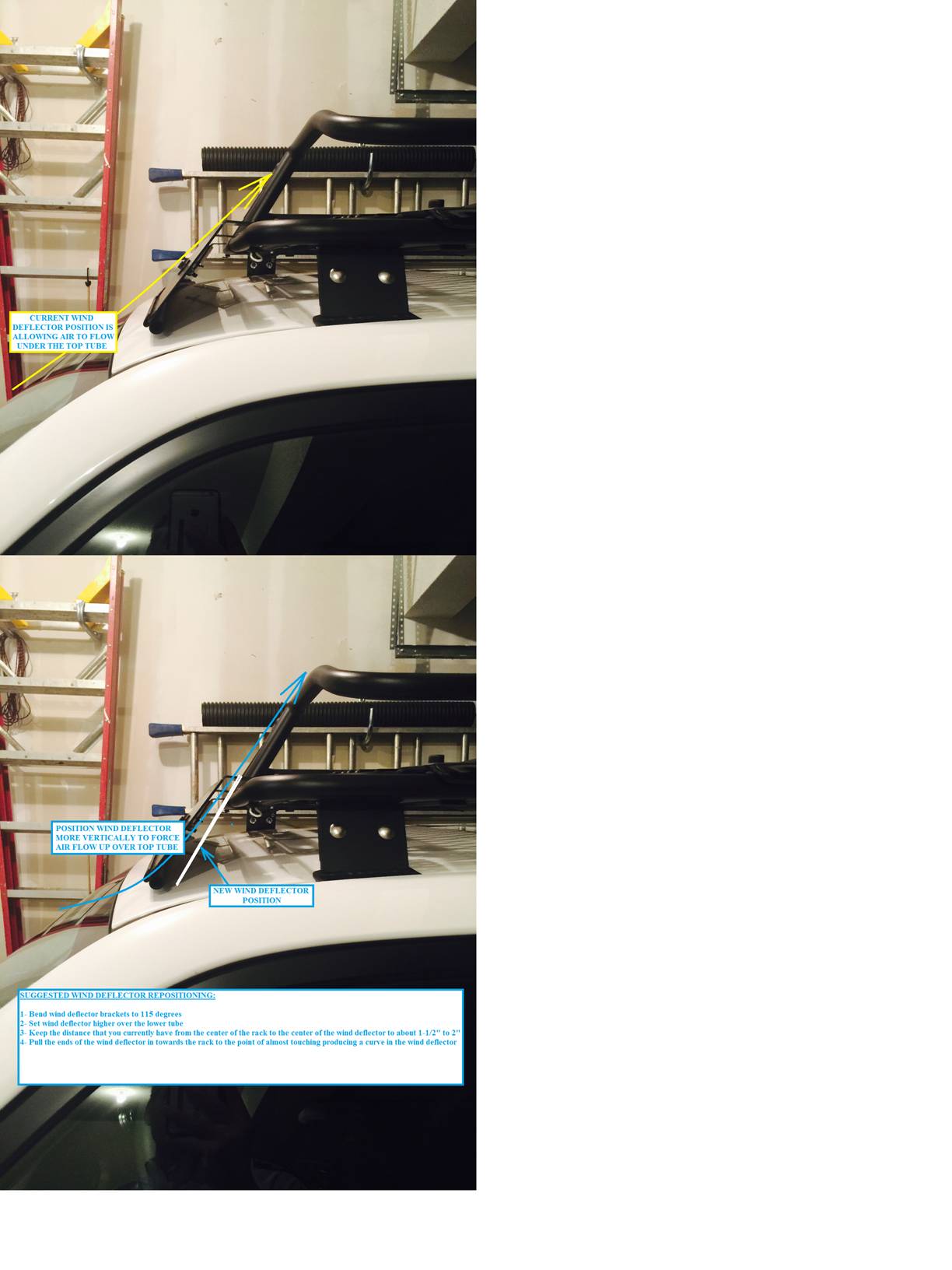

I have chatted over email with Paul at Gobi and he suggested bending the brackets to 115 degrees to help lift the air over the top bar on the Ranger Rack. I did that this morning and it definitely helps. I also experimented with the fairing touching the roof and off the roof top about 1.5 inches. I would advise snug to the roof. The fairing ends were flapping when they were off the roof. Below is Pauls drawings he gave me. His suggestions really helped, I did everything he suggested except raise it off the roof.

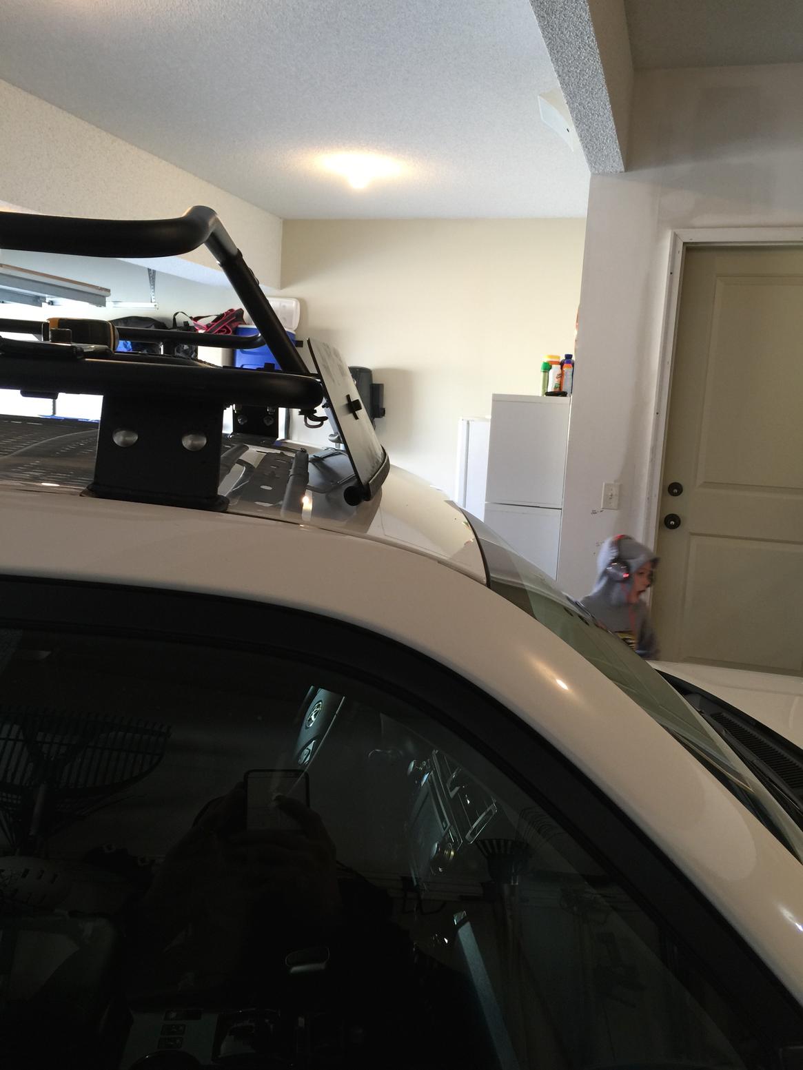

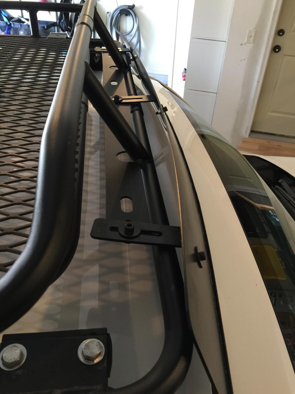

My current positioning after Pauls tips. Definitely much better. It is still very notable noise at 70 with no radio but I am not expecting total silence. You also might notice that I changed out the supplied bolts with new black allen heads and bigger washers. Looks a lot better and you can get more torque on the nuts. I also replaced the nuts on the sunroof insert, since I don't have a sunroof I just wanted it installed all the time. So I replaced the spin off removable nuts with the black allen head bolts and all new washers. Snug as can be.
