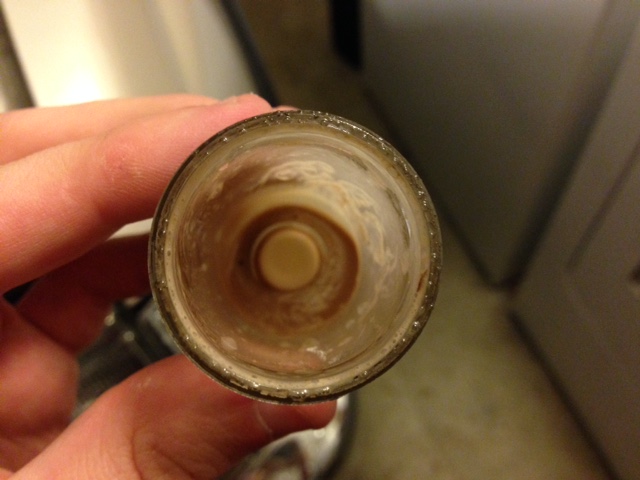

Noticed something unpleasant while checking my catch can (between the the PCV valve and throttle body):
Water oil mix, I presume. Last few times I've checked, it's been straight oil.
Dipstick shows oil level is fine, and no sign of the mix there. Oil cap shows no sign of it. Radiator coolant is topped up. Everything is running fine, though it's been mostly short trips for the last couple of weeks, and a couple of wet days.
Anything I should check or watch for, besides engine temps? Catch can is cleaned out, we'll see if it continues.

I've seen this happen from time to time in the intake area, it is caused when condensation builds up and mixes with oil and gives this strange appearance happen a lot with oil caps on valve covers. Typically just clean it off and move on. Unless your are seeing other signs that got your worried like overheating and such

I concur with [MENTION=110088]SilverRidgeRunner1[/MENTION]...this will happen, especially with short trips. The engine isn't given enough time to truely warm up...and get hot enough to dissipate the moisture from the oil/engine. Take her for a 10-15 mile drive up on the highway...she will be happy again.
Just a thought...if you do a lot of short drives like this...I guess if this is the norm for you. Might want to think about changing your oil more often.

Yep, that makes good sense. It's been wet and cold here lately too, so condensation was sort of what I figured too.
Been an unusual two weeks, lots of short errands and not enough time to do them on foot. As you say, just need to go for a longer cruise and cook things a bit more.
I'd check the inside of your oil fillter cap and look at the oil on the dipstick. If those are good, I wouldn't worry about it. If you've got that inside the filler cap you probably have problems.
...Dipstick shows oil level is fine, and no sign of the mix there. Oil cap shows no sign of it. Radiator coolant is topped up.....

You must have missed this part of his original post. Sound like all is going to be good..thank goodness. :party:

You are fine. Sometimes the oil in my catch can looks worse, other times just fine. I chalk it up to the oil caught is mixing with a little moisture somewhere. For $10 change the PCV, using an OEM one.
Bad valve guide seals?
As long as the oil on the dipstick is good, drive on.

Replaced the PCV shortly after I picked it up in 2013, figure it's probably good for anther 200k.
Thanks for the advice everyone, sounds like nothing I'm going to worry about.

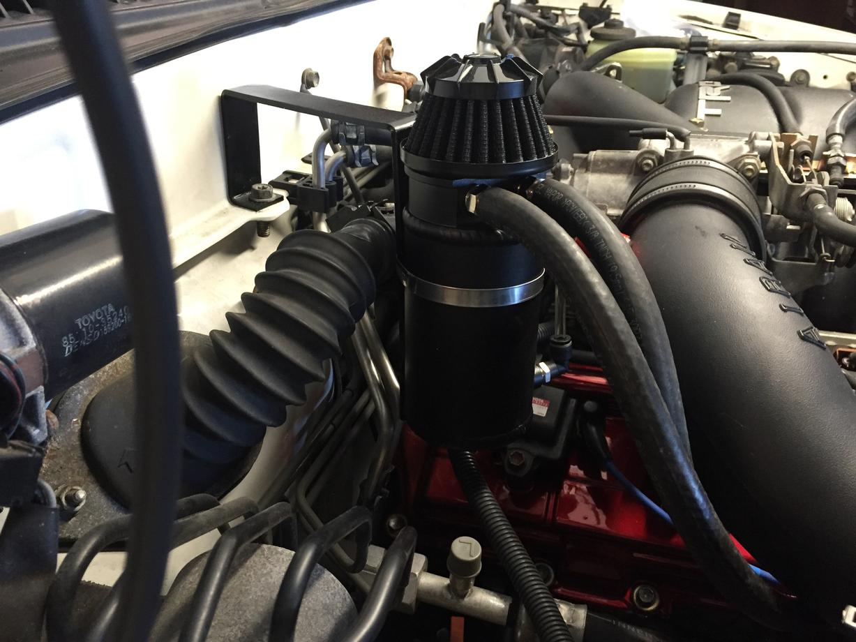

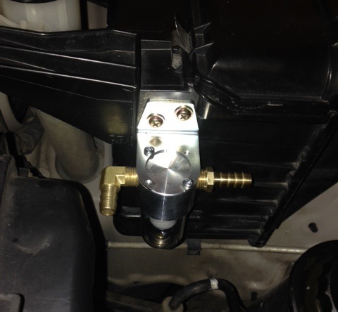

How about posting pictures of your catch cans and location. There is a lot of water vapor produced as a byproduct of the combustion process.

I like where you put yours. I wish I would have though of that! I built a bracket for mine...it works! Also, please note: I'm not running the filter. It's been removed and a cap has been put in its place.
