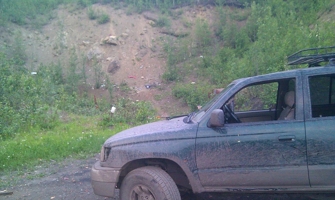

Ok, so here is a pic of my rig from last summer. I bought this thing for my ex-wife in 09, five months later we were divorced and she had dumped it in my drive. It was in tip top, fantastic shape. I set out to destroy this thing. Fastforward to now. I have rolled it three times, sunk it in the knik river, rallied it in current stock shape that would make any leeper cry. I barely maintenanced it, and for a time generaly didn't care what came of it. Needless to say, It won't die, and I have come to absolutely love this rig. So I am now going to crazy on it. Mods, repairs, interior, and paint. I got some pictures this week pulling some interior, and getting my marking and measurements complete. I'll be putting those up soon.
