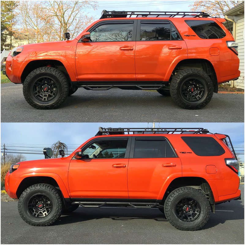

So I said I wasn't going to lift it but the mod bug got the best of me. Ended up getting this Toytec lift kit. `Before I got the lift kit, I went with BFG All Terrain KO2's in 275/70/17.
Here it is in it's current state and I think I am finally happy with the stance and suspension setup. As others have stated a millions times, this is how it should have came from the factory (as far as the lift goes). I was able to sell the 275's for exactly what I paid for them and got 285/70/17 KO2's and I think it came out perfect. No spacers and more importantly, no rubbing at all. I couldn't be more happier. Enjoy the pics!
Top: 275/70/17
Bottom: 285/70/17

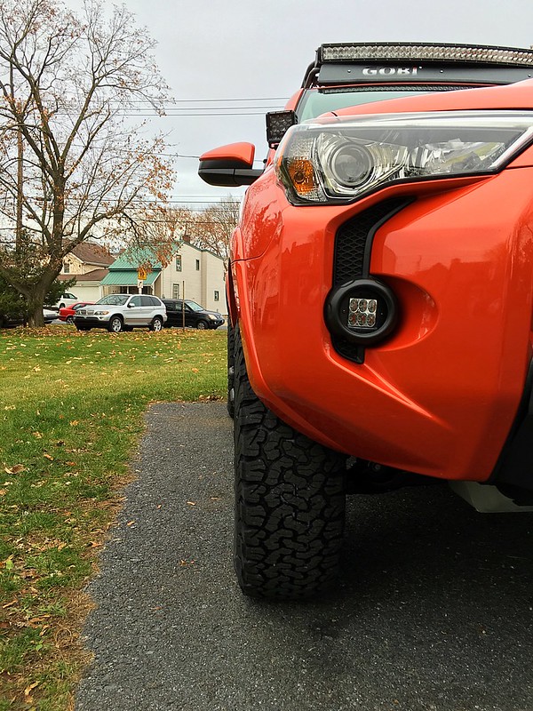

I'm looking to replace my factory fogs with Rigids, however, I'm new to Rigid and hoping you can provide some guidance.
I understand the D2 wide/driving are not DOT approved and may be/are illegal, but I'd prefer to have the amber lights for fogs. How are you currently using your fogs? Do you use them on a regular basis (in town)? If so, do you get flashed by other drivers? Or, are you only using them in a limited fashion? I usually have my fogs on all the time, and really prefer to get the amber light, but don't want to be blinding other drivers.
Do you have experience with both the driving and wide patterns? If so, which one would make a better fog light, or is it truly personal preference? I'm hedging toward the driving pattern.
Thanks Kuato!
I ALWAYS drive with my fogs on so when I got the amber D2's in the foglights and first turned them on, I thought they were really bright and would blind oncoming drivers. I also thought they would draw a lot of attention. After driving with them, I've gotten flashed maybe 2-3 times in the last month or so but I think they were more for my headlights since I am about 3 inches higher with the lift and tires. I don't regret the Ambers one bit. I love the look of them and they match the other amber lights perfect.
As for patterns, if you really want them to be effective as a "fog light" then I suggest the wide pattern since you want the beam to "cut" through the fog so-to-speak. I'm by no means an expert on lighting but I find the wide pattern to be more effective. Good luck with your decision.
