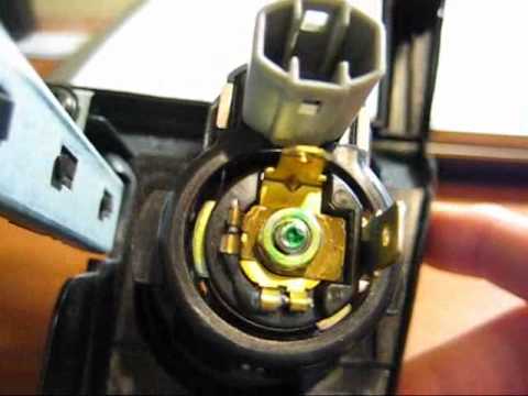

Runs off the ACC fuse. If your clock and radio still work, then you fried the fusible link that is built-in to the receptacle. That means a new receptacle or you can DIY a hot wire fix. The how-to is out there if you search....might be on YotaTech. You lose that extra protection, though.
See that L-shaped black wire? That's it.
