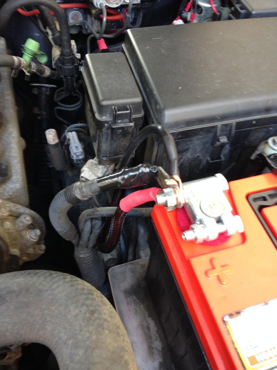

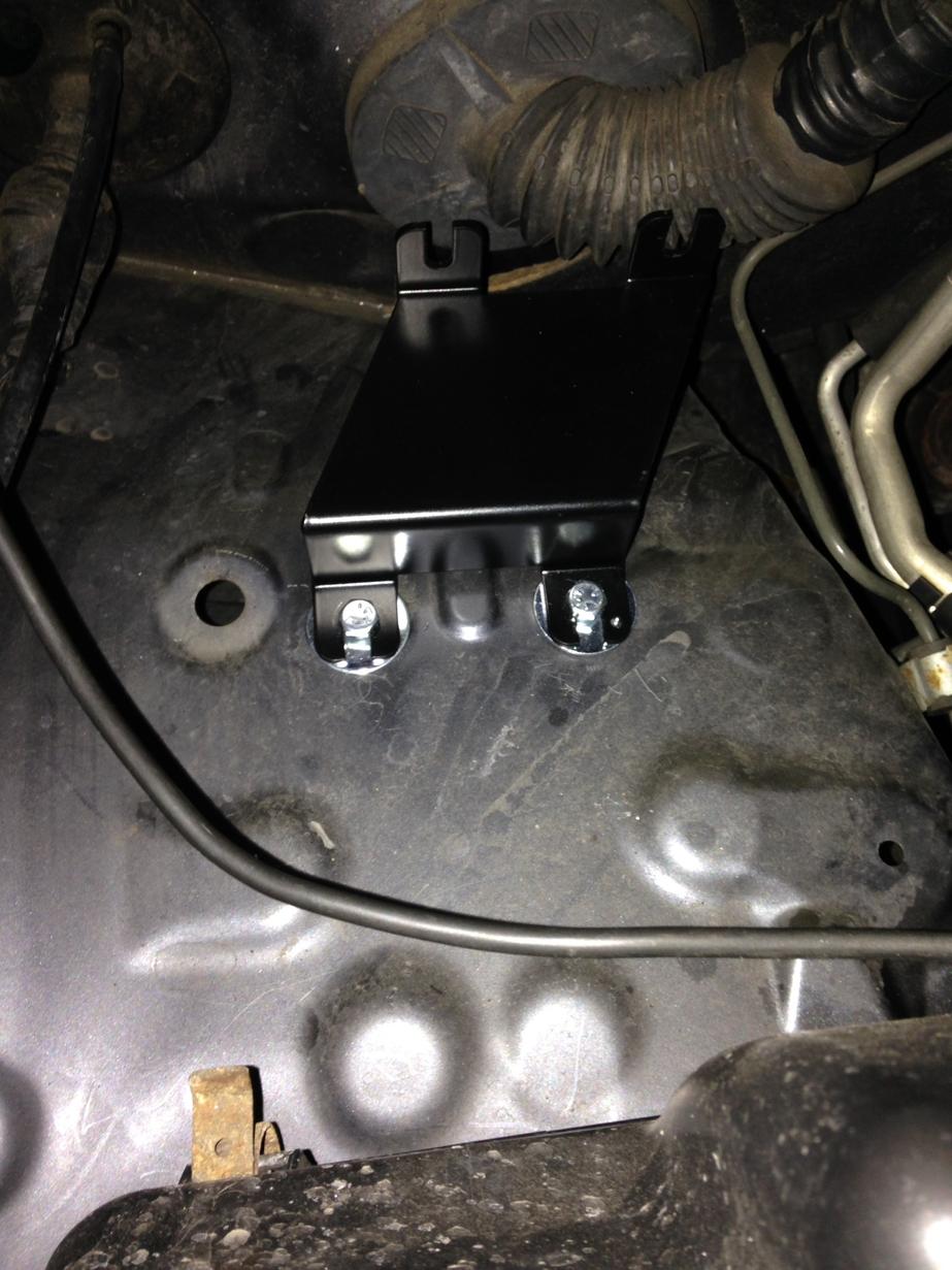

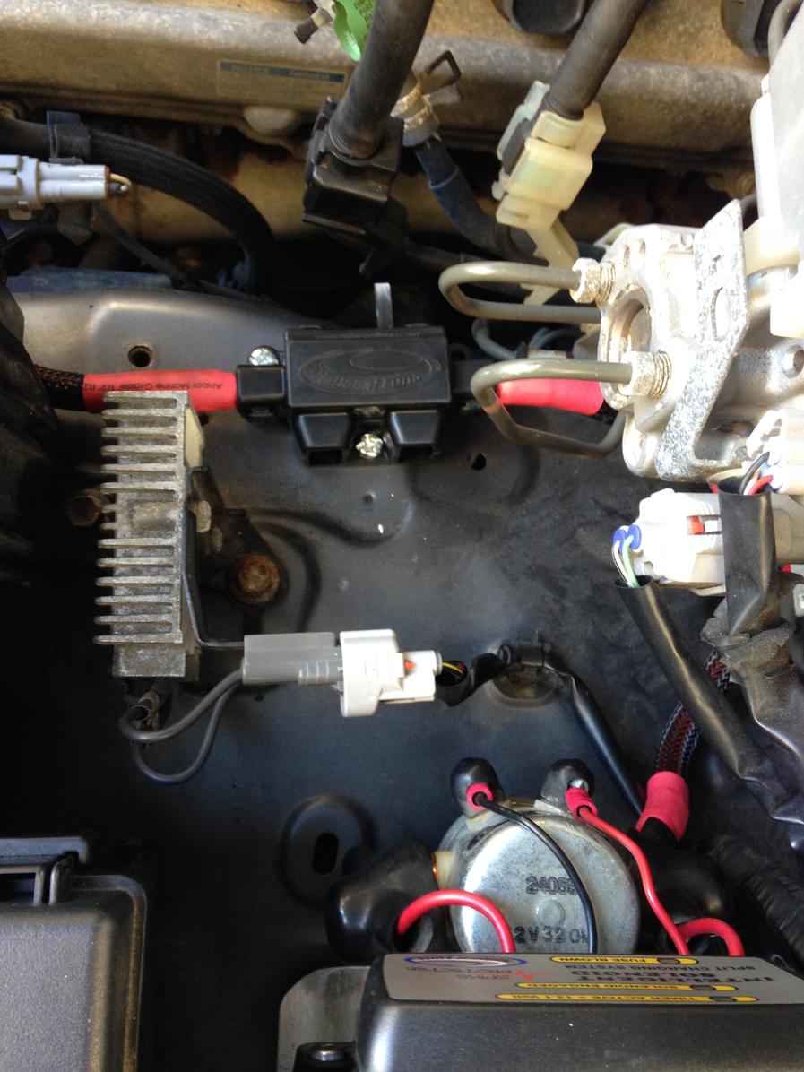

Dual Battery Setup.

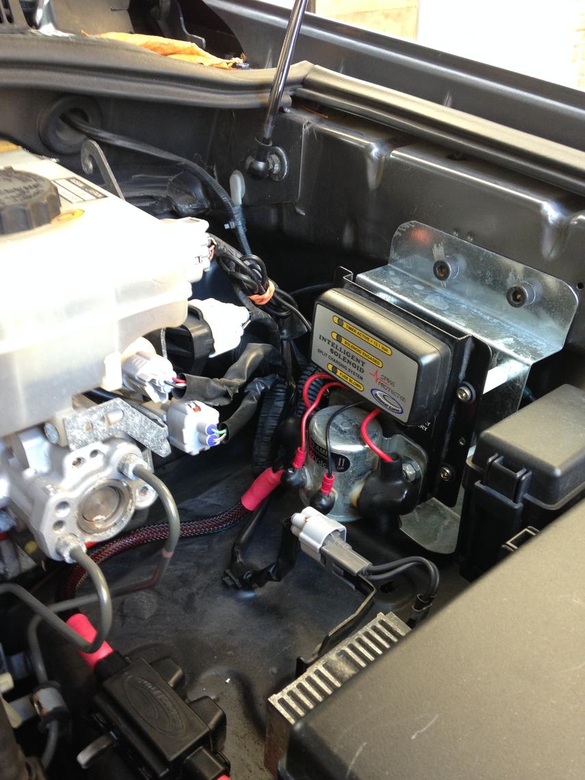

This was the first mod I did myself that was a bit of a project. I spent about a week figuring out where to mount the solenoid that comes with the Kit. I knew the 2nd battery was going to go in the rear passenger side with the Dirty Parts dual Battery Tray. I put the solenoid on the driver side fender where existing threaded holes are present to prevent having to drill new holes. All the wiring was ran in Techflex sleeving for protection (I hate using split loom as it gunks up over time and gets nasty) with Ancor Marine Grade Electrical Adhesive Lined Shrink Tube colored red to denote the hot side of the system.
Parts List
National Luna Dual Battery Kit
Techflex sleeving 3/8's
Noco Marine Grade Lead Free Zinc Battery Terminals
Pico Terminal Ends 3/8" & 1/4"
2 M8 x 1.25 SS Bolts 10MM
1 M8 x 1.25 SS Bolt 18MM Long
Zinc Coated 16 Gauge Bracket

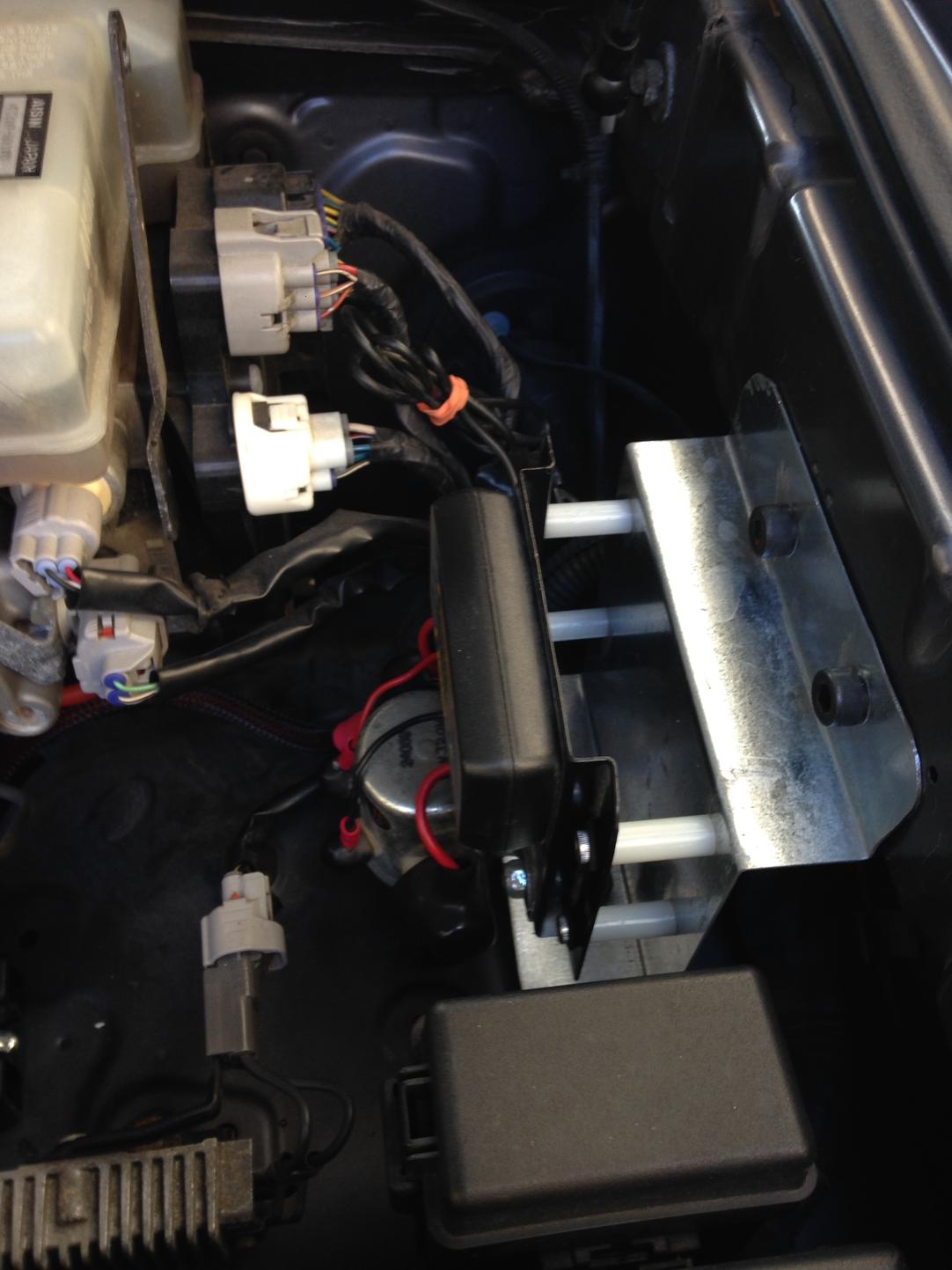

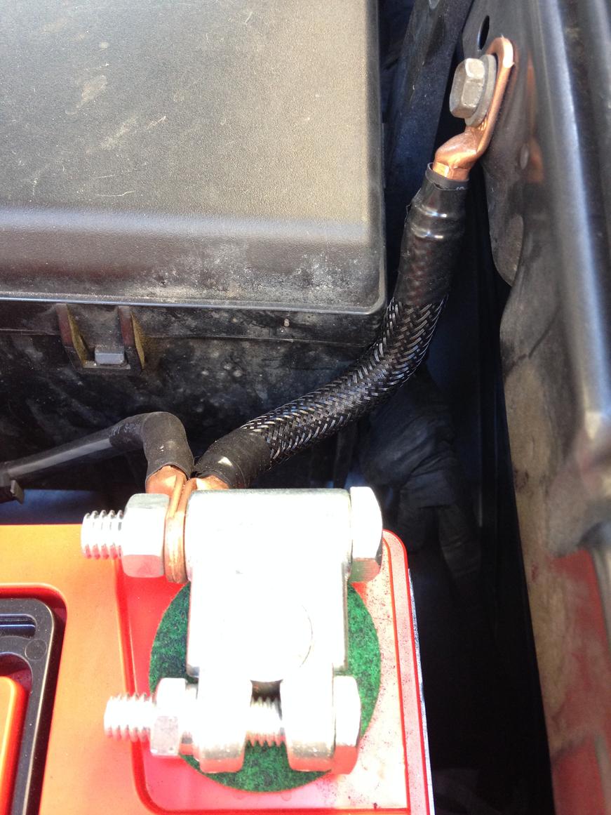

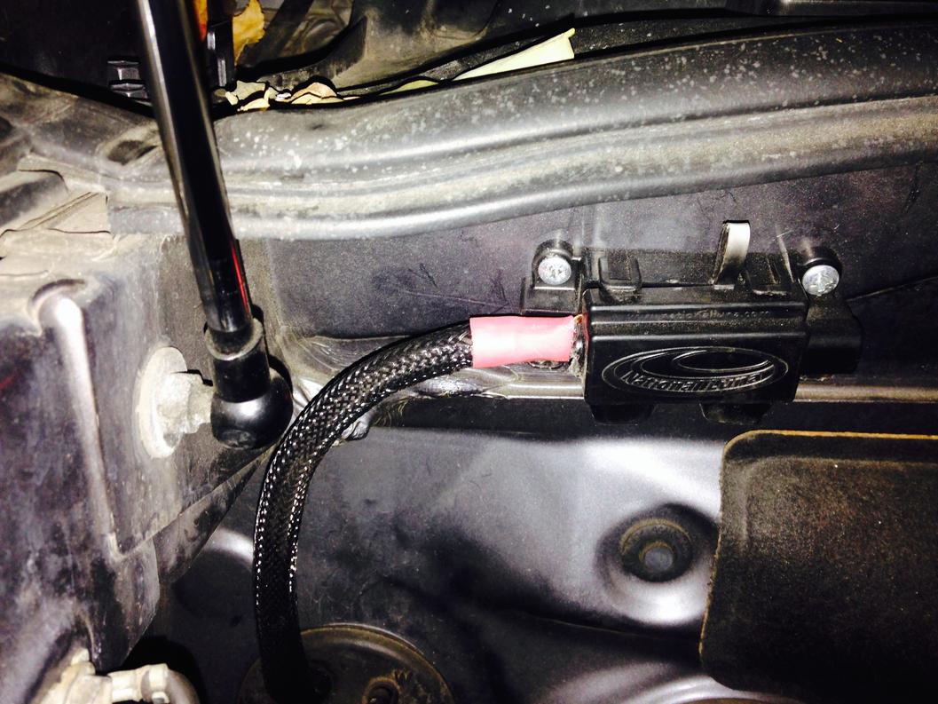

I started by making a template out of cardboard for the bracket where I wanted to mount the solenoid. Once I had that I was able to take it to my sheetmetal guy and get it made out of 16 gauge zinc coated aluminum. This is plenty strong and lighter than 1/8 steel which is overkill for this application. Plus it will never rust, does not need to be painted, will never chip. It's an easy maintenance free item that anyone can make, I just happen to use the sheetmetal guy b/c he was making other items for me for our company. Saved me an hour worth of work.
Once it was completed I drilled the holes to mount the solenoid. I spaced it off the bracket so it would clear the hood strut on the way down using plastic 1" spacers, SS screws, and nylock nuts.

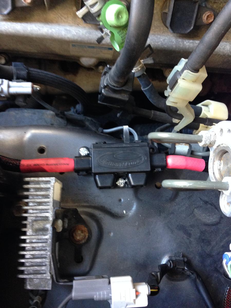

The bracket mounts to existing threaded holes using the ss bolts listed above. the longer one is for the bottom hole b/c my bracket was about a 1/4" short of touching the bottom part of the fender. If you stick it right on the fender then you need 3 of the 10mm ones.
The national luna fuse between the starting battery and the solenoid is also mounted to existing threaded holes that are M6x1.0 10mm screws. I had to drill out the holes in the national luna bracket to fit that screw but they threaded holes in the fender are spaced perfectly for the bracket. It fits like a glove.

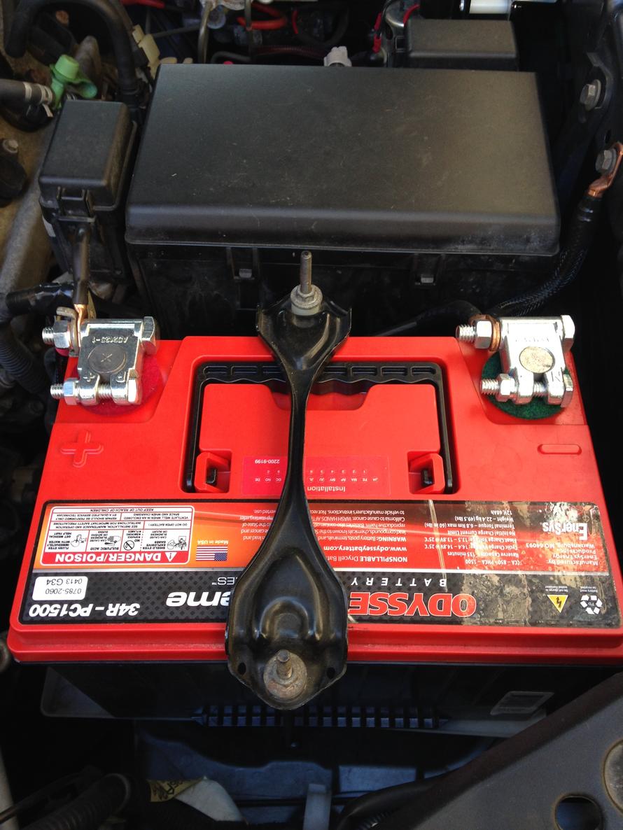

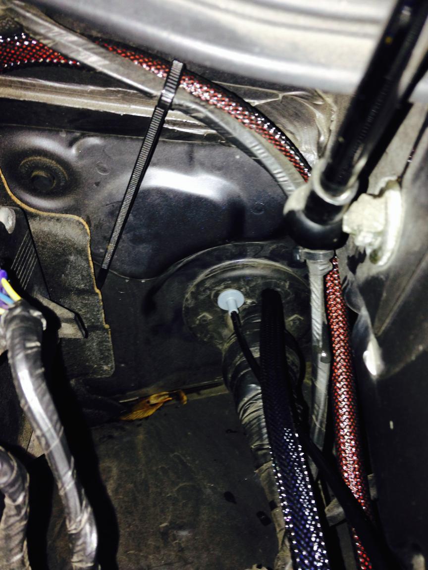

The wiring leaves the solenoid and runs along the firewall towards the passenger side. The only hole I had to drill was for the 2nd fuse that goes right before the 2nd battery.
I"m just waiting on the Dirty Parts tray to come in before I can install the 2nd battery and run the negative cable back to the starting battery. Then I'll install the controller in the glove box on a bracket and the system will be complete.

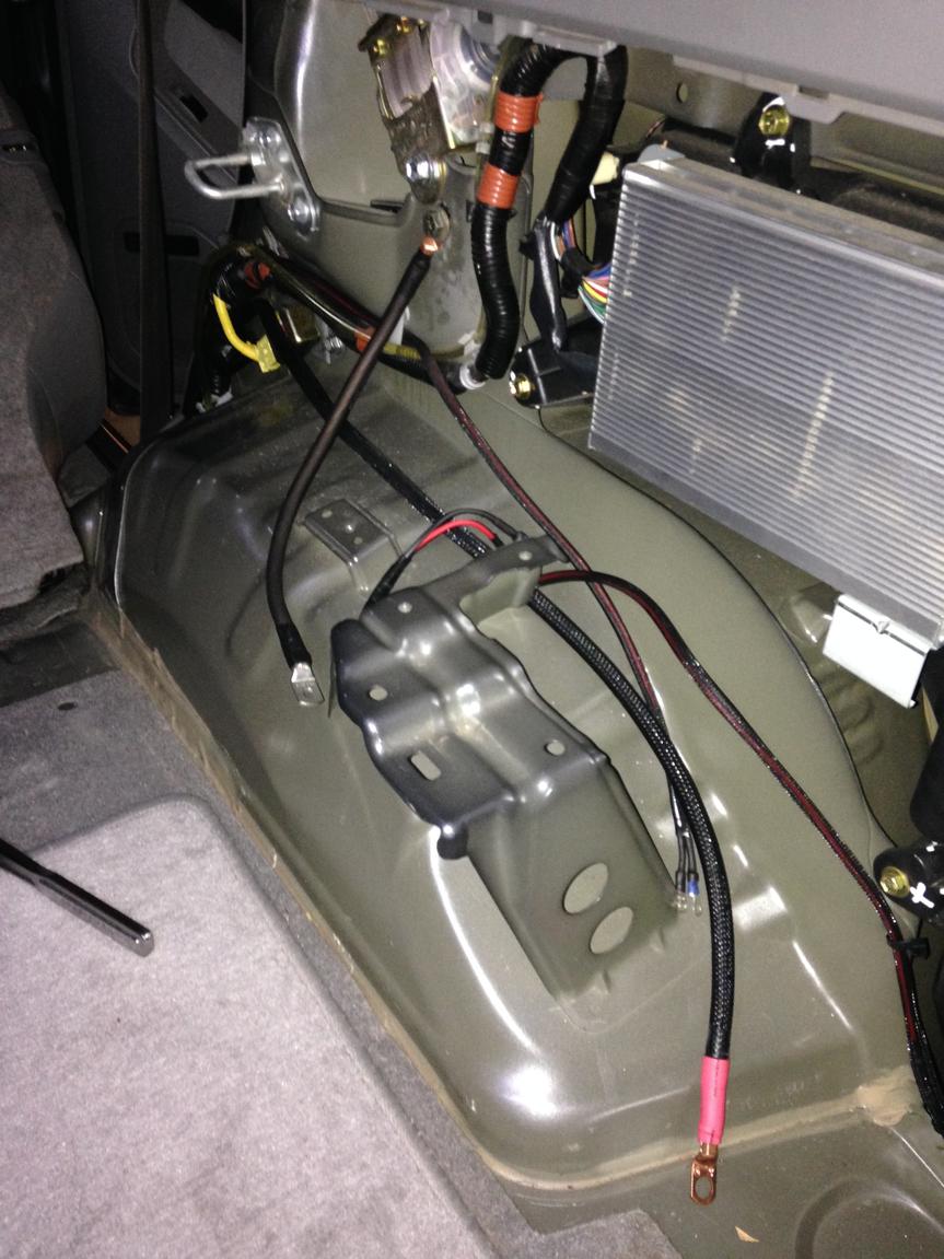

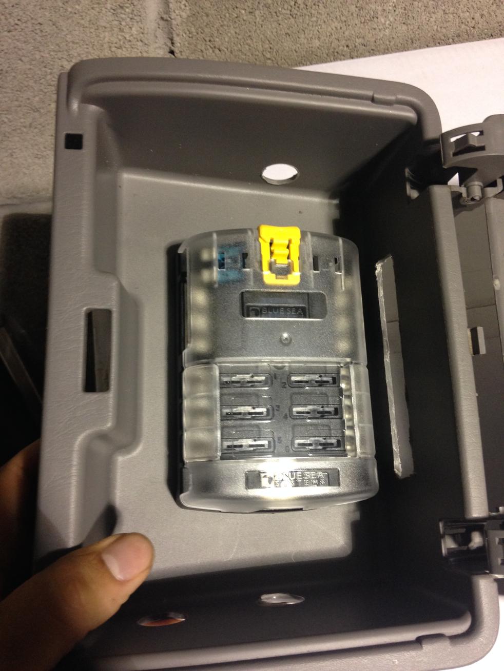

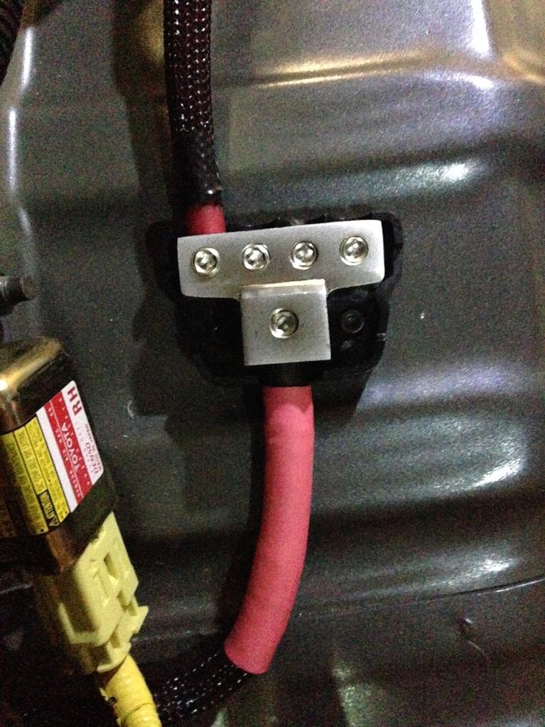

Currently I'm in the process of finishing up my Auxiliary fuse block in the rear compartment, Blue Sea Dual USB Outlets, and my power distribution block (more on this later).
Once I had the dual battery system in place and pretty much complete I started figuring out where to add my auxiliary fuse block. The stock 12 volt outlets in our 4th gens does not put out enough juice to charge the iphone while using so I decided to add the Blue Sea 2.1 amp usb outlets. I placed the fuse block in the rear cargo area in the small receptacle on the passenger side. this way it would be easy to access while still hidden from view and not in the way.
Parts List
National Luna Fuse Holder & 100 amp fuse
KnuKoncepts 4 guage power cable
NVX XDBU4 Power distribution Block
Blue Sea 5025 6 Circuit Fuse Block
2 Blue Sea 2.1 Amp Dual USB outlet
Techflex Sleeving 3/8"s
Pico Terminal Ends

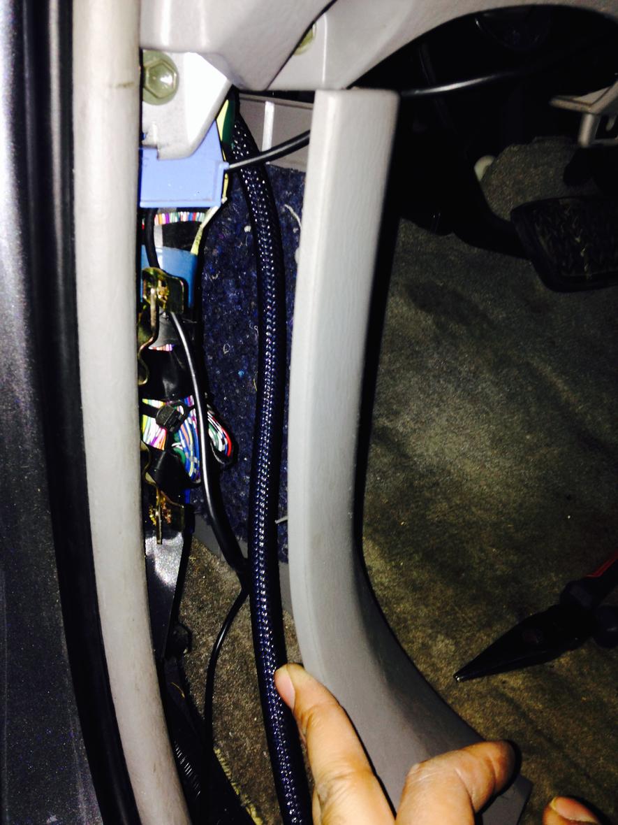

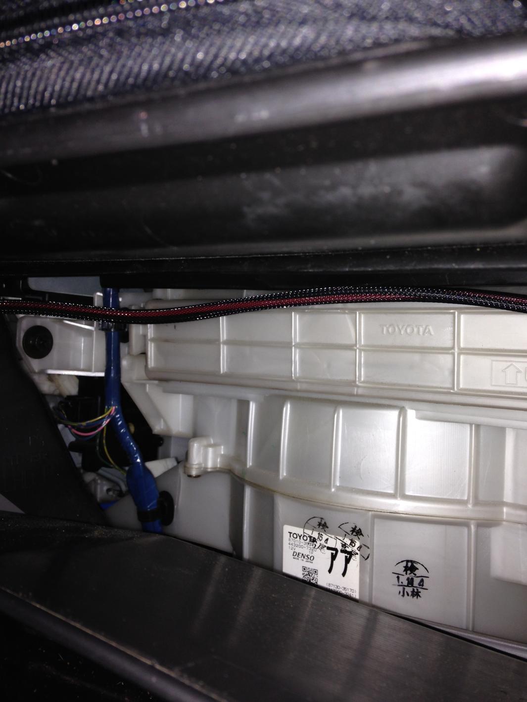

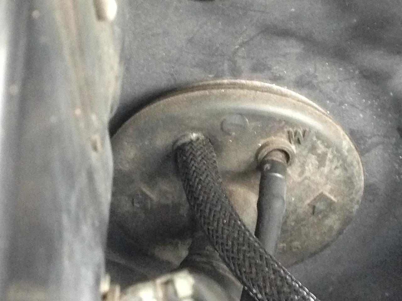

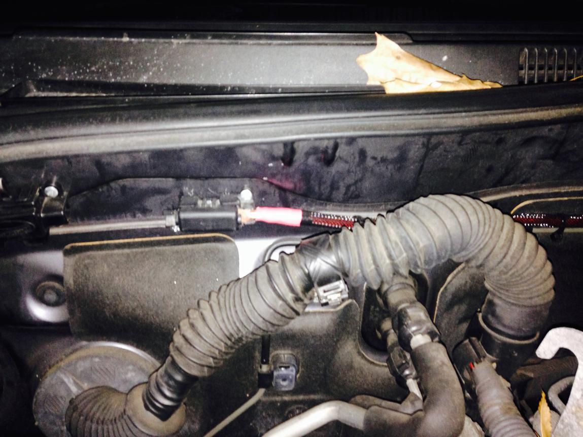

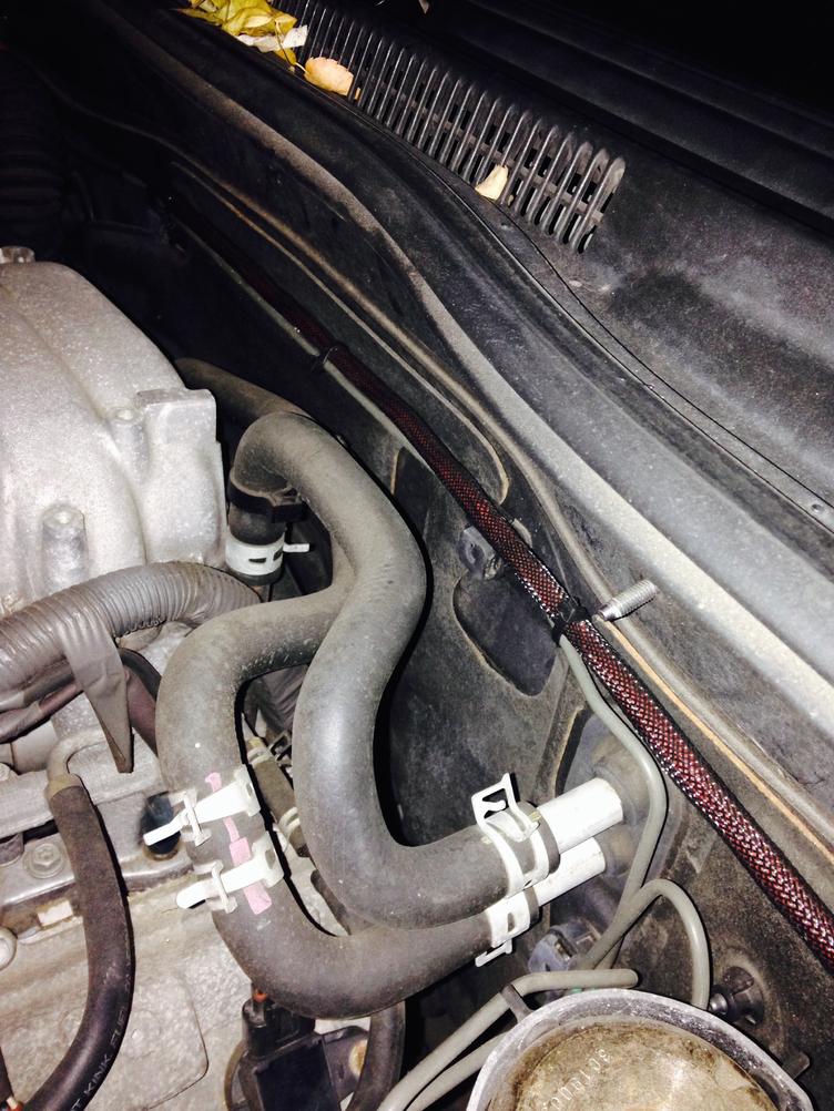

I ran a 4 gauge power wire through the passenger side grommet, through the door sill chase, back to the rear cargo area. It goes to a NVX distribution block. Then a 4 gauge power wire runs to the fuse block. I plan on running my USB outlets, ARB fridge, Baja Designs rear floods and my CB off of this fuse block. Its more than adequate and and sized so that if plans change I can run whatever without having to run new power wire.
The secondary part of this install will be my ARB twin compressor. I used 4 gauge with a distribution block for this reason as I can run my 8 gauge wire into the block without having to run the ARB power source all the way to the front. This is not yet installed as I'm currently working on my audio setup. Everything in the rear is interconnected (fuse block install, rear arb setup, fridge, audio upgrades) so they all kind of meld into 1 big project.

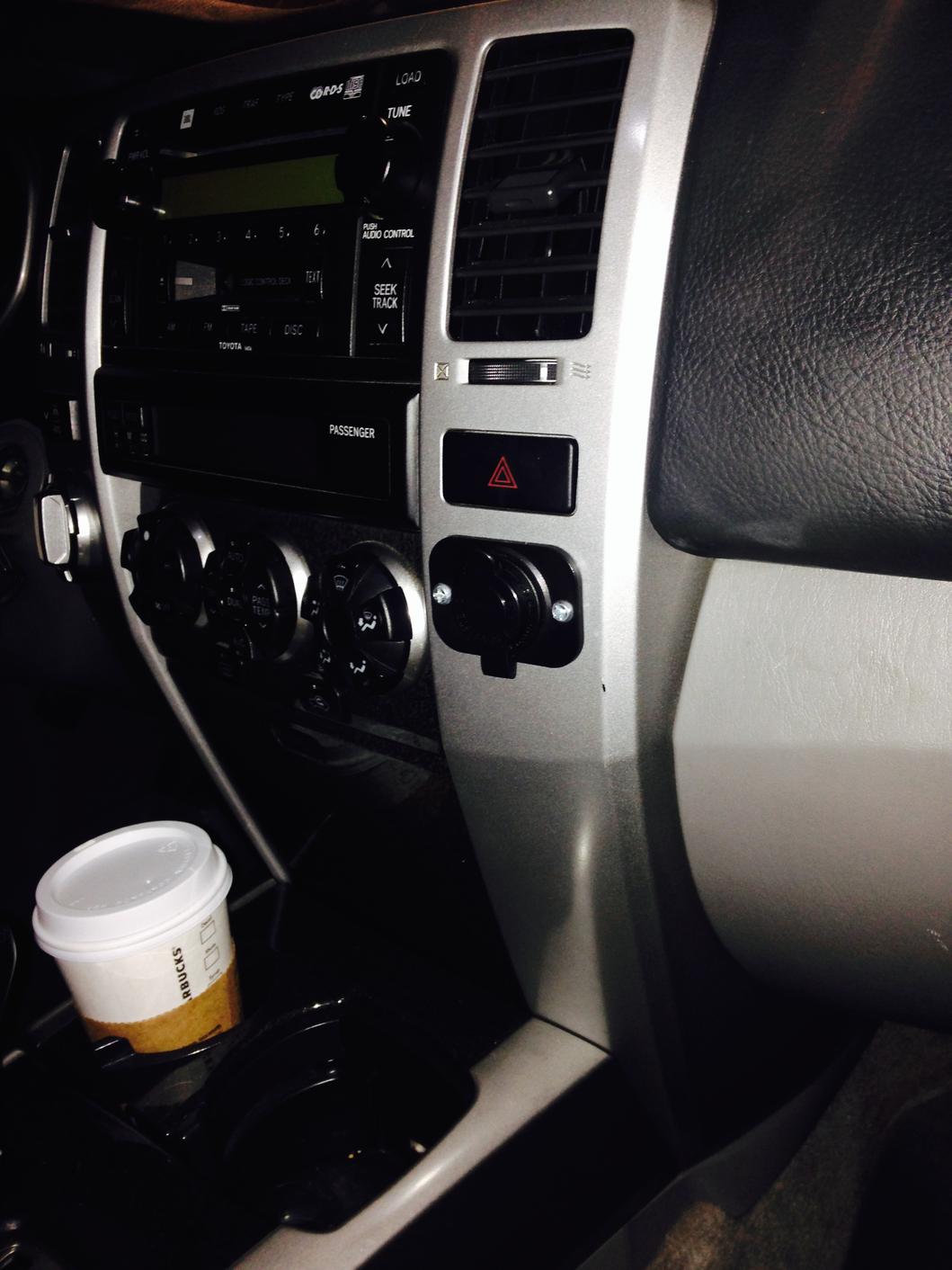

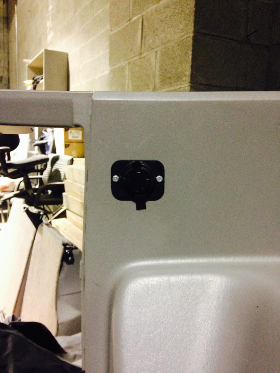

In the compartment where I mounted the fuse block I drilled 1 hole in each end for my 4 gauge power and ground to run through. I cut out a rectangle along the back side to allow for the power and ground wires to come through for each circuit.

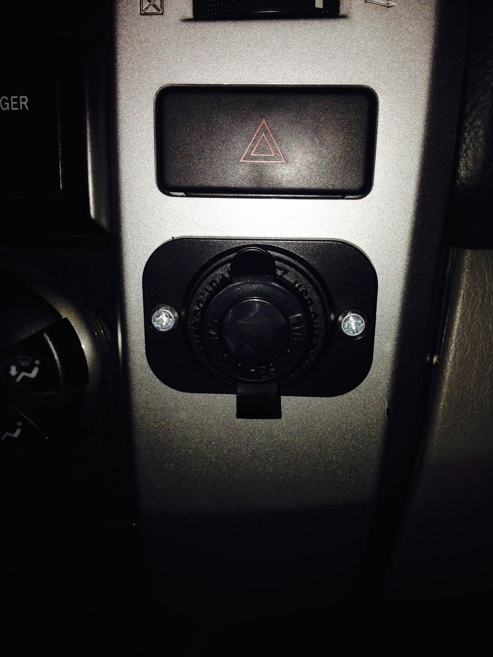

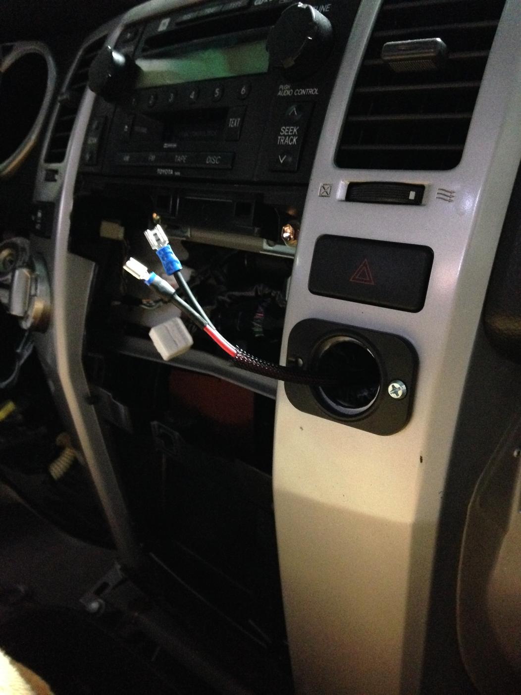

the usb outlets were wired using 16 gauge wire run in techflex sleeving for protection. The front outlet is placed right below the hazard button and the rear is placed on the driver side rear panel above the wheelwell. This way i can charge items and place them in the driver side rear compartment while driving or while parked. Currently the rear driver side panel is out of the car for stereo install purposes but you can see the placement of the outlet.
This was pretty simple to install. I ran the wires for the front while doing the power wire. The front is a bit tricky b/c there is bracing in this area. I didnt know this when I first drilled it out so I had to dremel away some material on the inside brace to get the lock collar for the outlet to tighten down enough. If I had moved it over 1/4" this wouldn't have happened but then you wouldn't have it centered which is what I wanted. The rear outlet power and ground run along the chase that is below the trim piece by the rear hatch. really simple to pop it up and zip tie the wires to the existing.

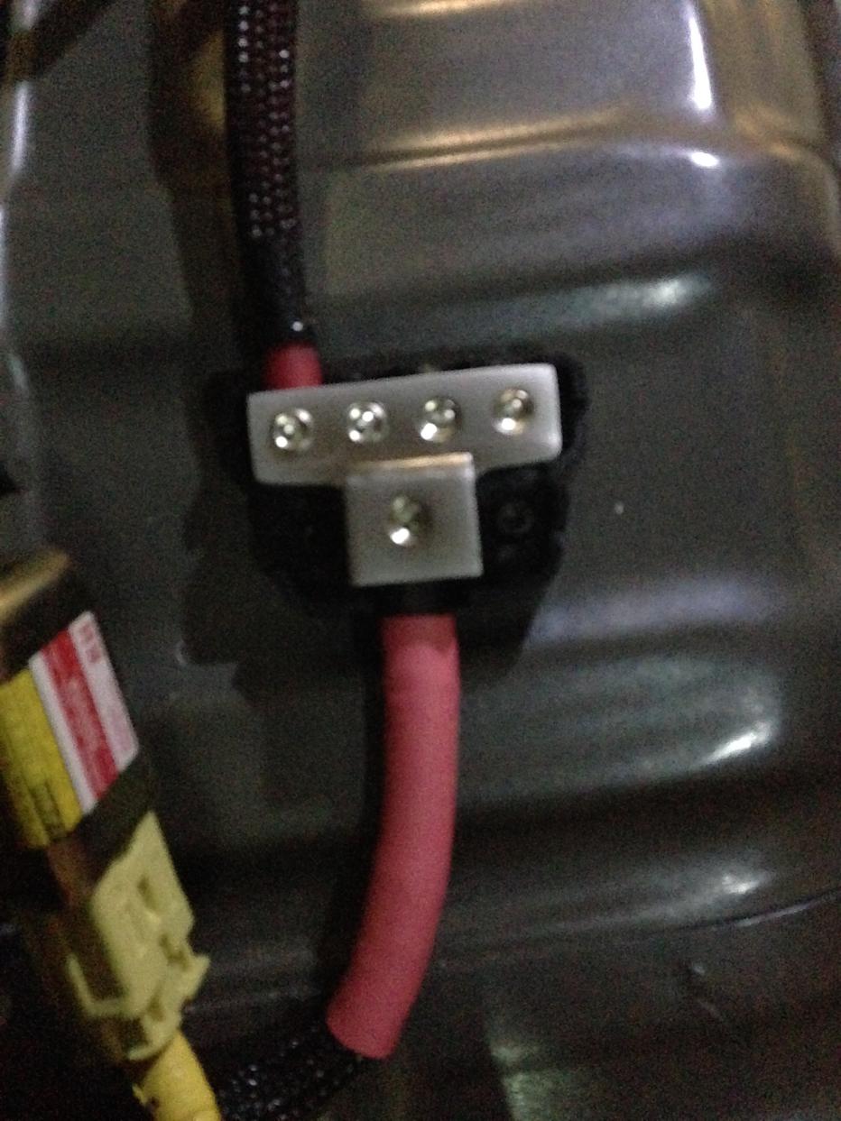

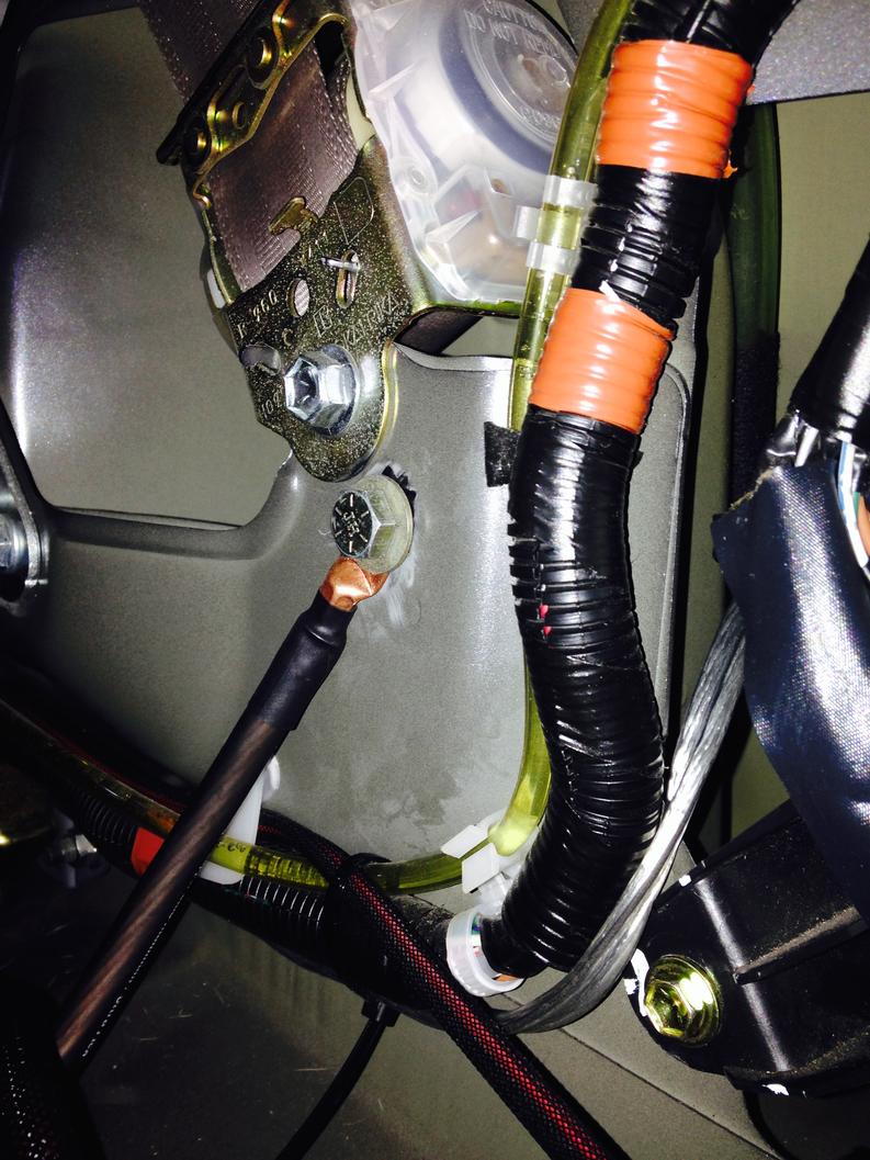

Rear fuse block setup and wiring
The entire rear fuse block is run off a 4 gauge power wire from the second battery. It runs into a distribution block and then onto the fuse block. The distribution block accepts 1/4 gauge input and has Four 4/8 gauge outputs. This will work perfectly for my compressor and fuse block that will tied together through the distribution block.
The ground for the fuse block runs through a 4 gauge wire and goes to an empty bolt hole on the passenger side compartment. I ran a 5/16th bolt through the hole after scraping the paint off and it is a perfect spot out of the way.
the 2 sets of wires coming into the rear are for the blue sea outlets, 1 in the front and 1 in the rear compartment.

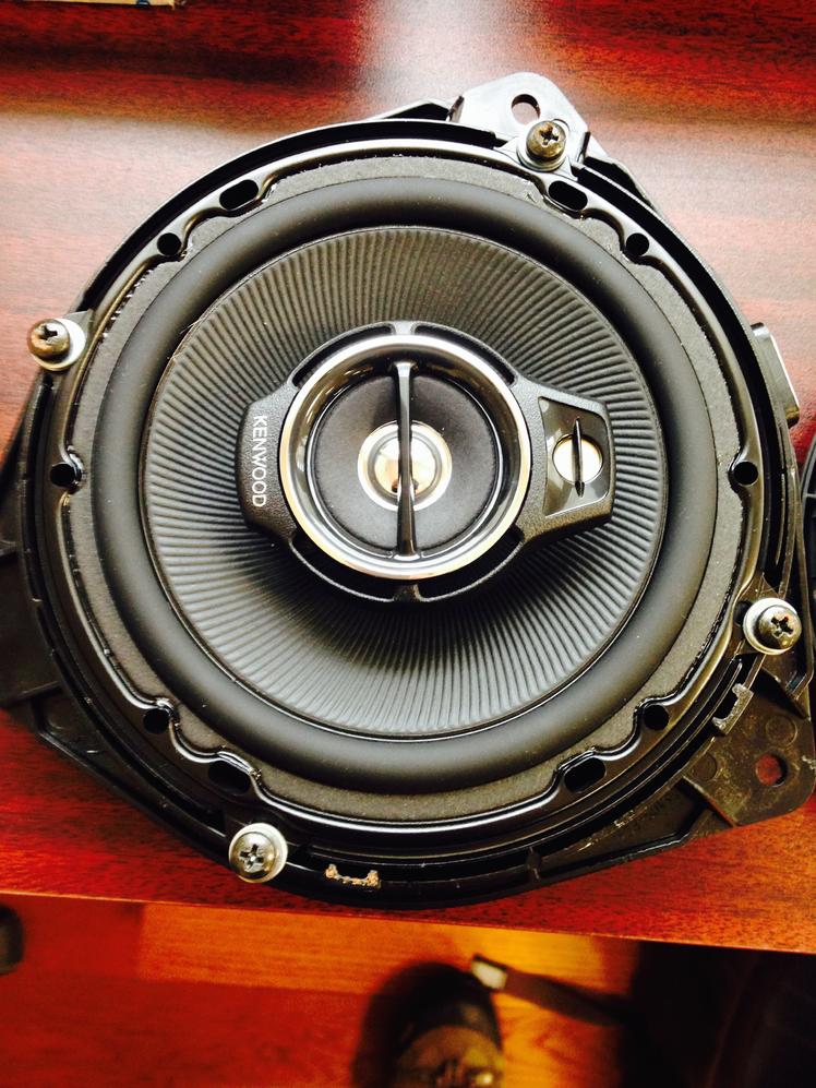

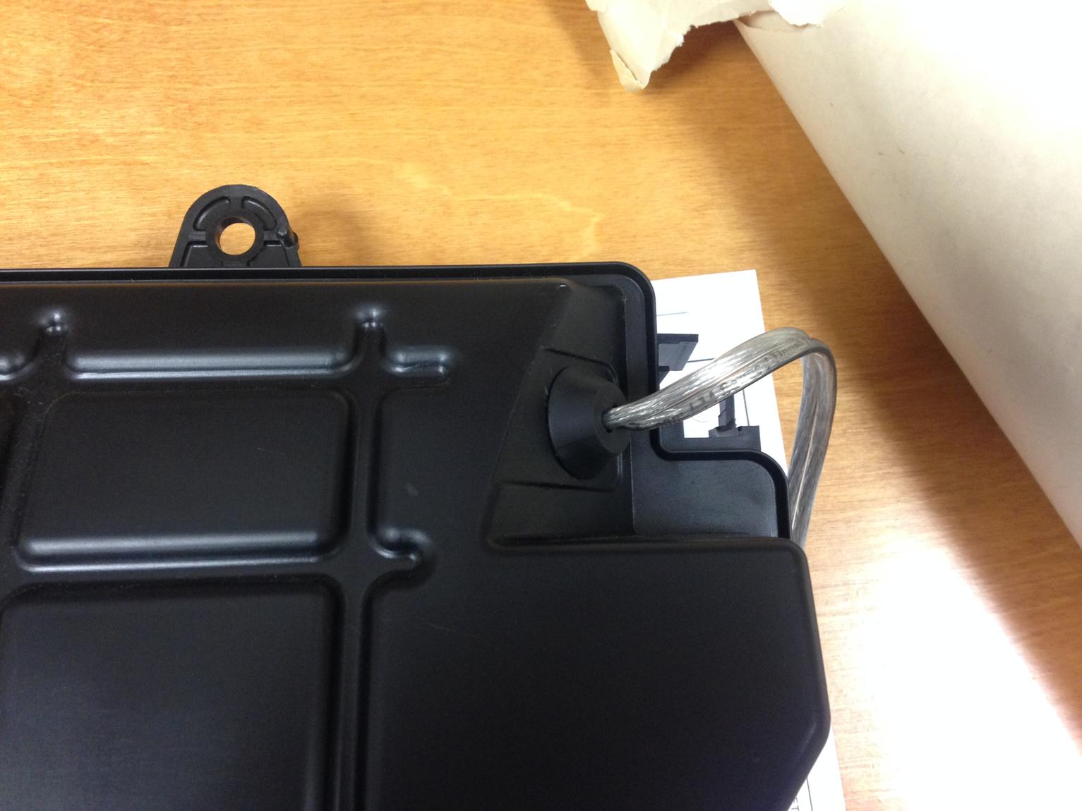

Complete Audio Overhaul.
Living in NYC bluetooth is essential as is navigation for my work (client and architect meetings all over the 5 boroughs). I read tons of threads and info regarding the factory sound system and i decided that to get the results I needed/wanted I had to bypass the entire setup and run a complete new system. This is not as daunting as it looks/seems. I've never had any experience with sound systems but I read a ton and started slowly.
Parts List
Kenwood KAC 5 channel amp. (I wanted the x900.5 but was too expensive)
Kenwood 6 1/2 rear speakers
Kenwood 6x9 front speakers
Kenwood KFC 8" sub (drops right in)
Clarion 510 rearview camera
TacoTunes Front adapter plates
Metra ASWC-1 steering wheel control harness
Dynamat Bulk Pack
Knukoncept 4 gauge power wire
Knukoncept 12 gauge speaker wire
Knukoncept RCA cables

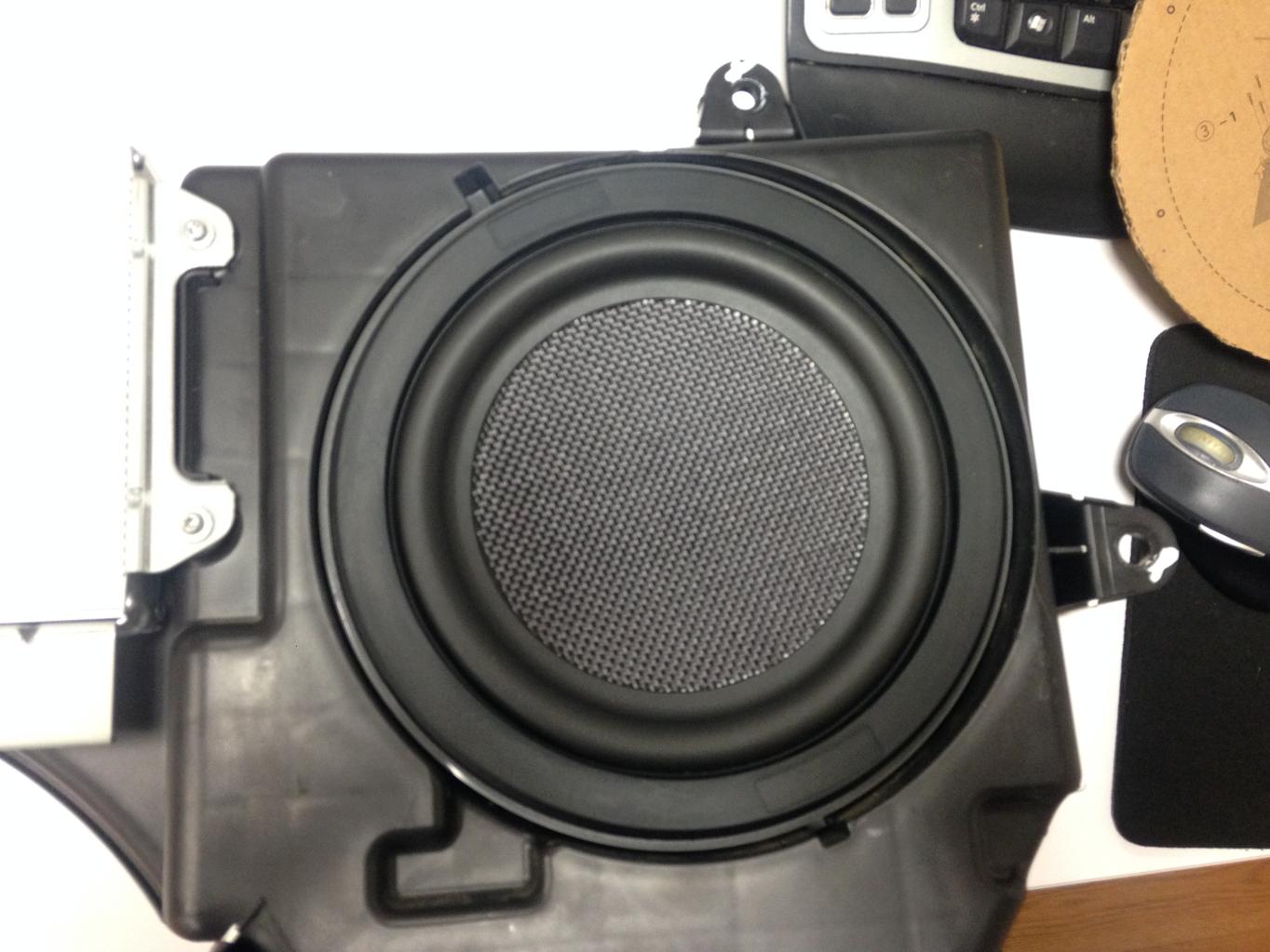

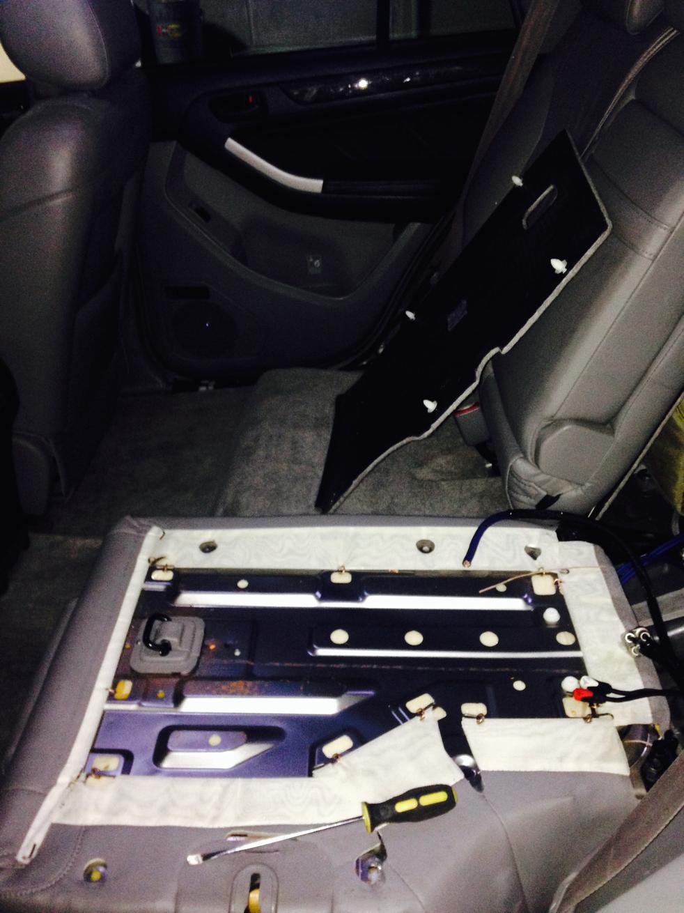

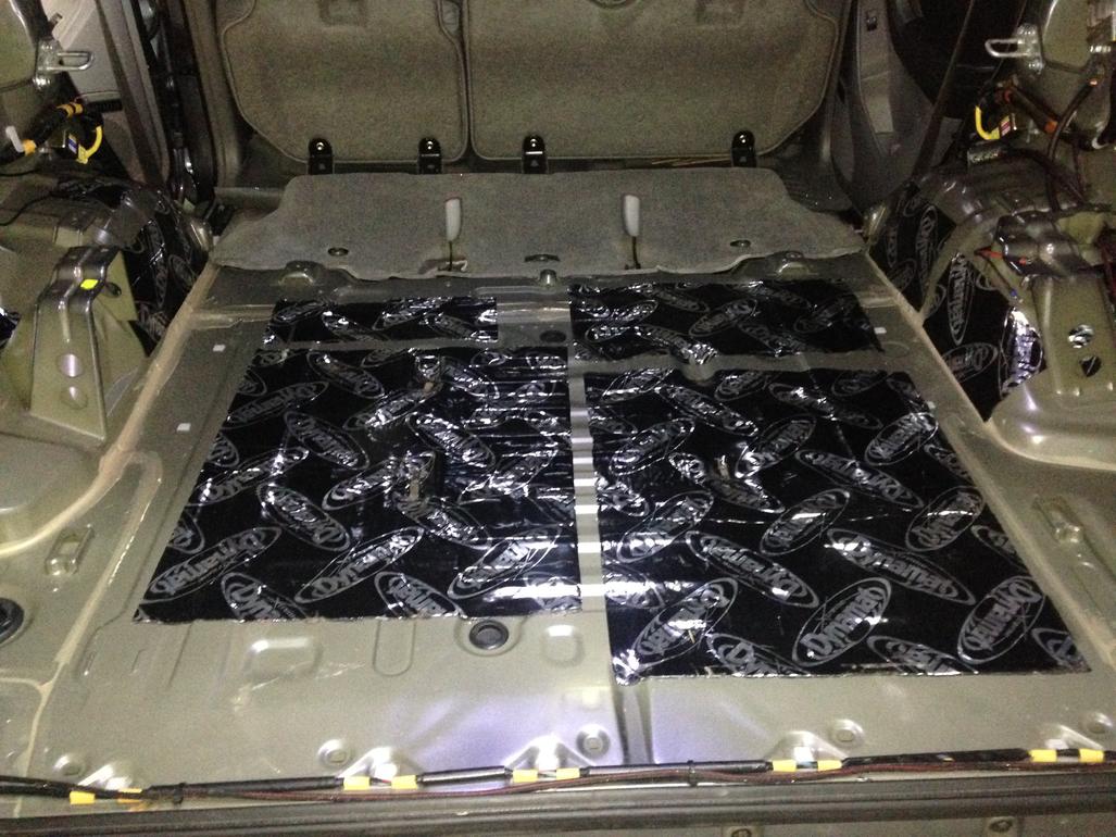

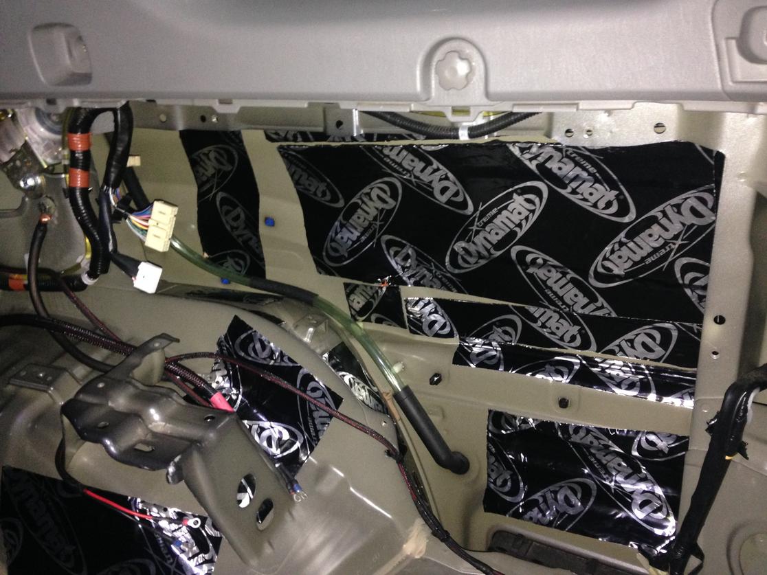

I decided on mounting my new amp to the rear 40 section seat back. I planned on mounting my fridge there and it would nicely protect the amp once bolted in place and keep hidden from view. Running the wiring is the most involved aspect of the install as I wanted clean lines and routing of the cables. I also had to remove the doors to dynamat them so it wasn't that much more work to run new speaker wire.
I didn't post info on how to remove interior panels, plenty of info on that already. This is a great link to remove rear door panels:
Couple quick tips:
1. run your longest speaker wiring first (save you headache with small sections that are no good later
2. remove the rear seats. Easy to do for the seat bottom part. On the seat back start with the driver side first, easier to get that bolt out. Be careful as there are lock washers that go with the bolt and washer as well. Do not lose those, make sure they go back in from the outside part of the bracket when putting the bolt back through.
3. remove the carpet at the rear all the way to the back of the front seats. The black plastic tabs are easily release by pulling towards the center of the vehicle and then pushing the white tab in with a screwdriver.
5. Run new wiring for sub through grommet in sub box. Push the grommet into the box instead of trying to pry it out, much easier to get it removed as its larger on the inside than the outside.
6. Run your power wire through the passenger side engine grommet if you can. Easier to work with. Snip off the nipple and then stick a long allen wrench or screwdriver into the hole. Pull back at an angle. You need to pull the inner part out (like reversing a sock) as the opening gets smaller on the inside of the grommet than it is on the outside. This is only necessary if you are running 4 gauge or larger cable.

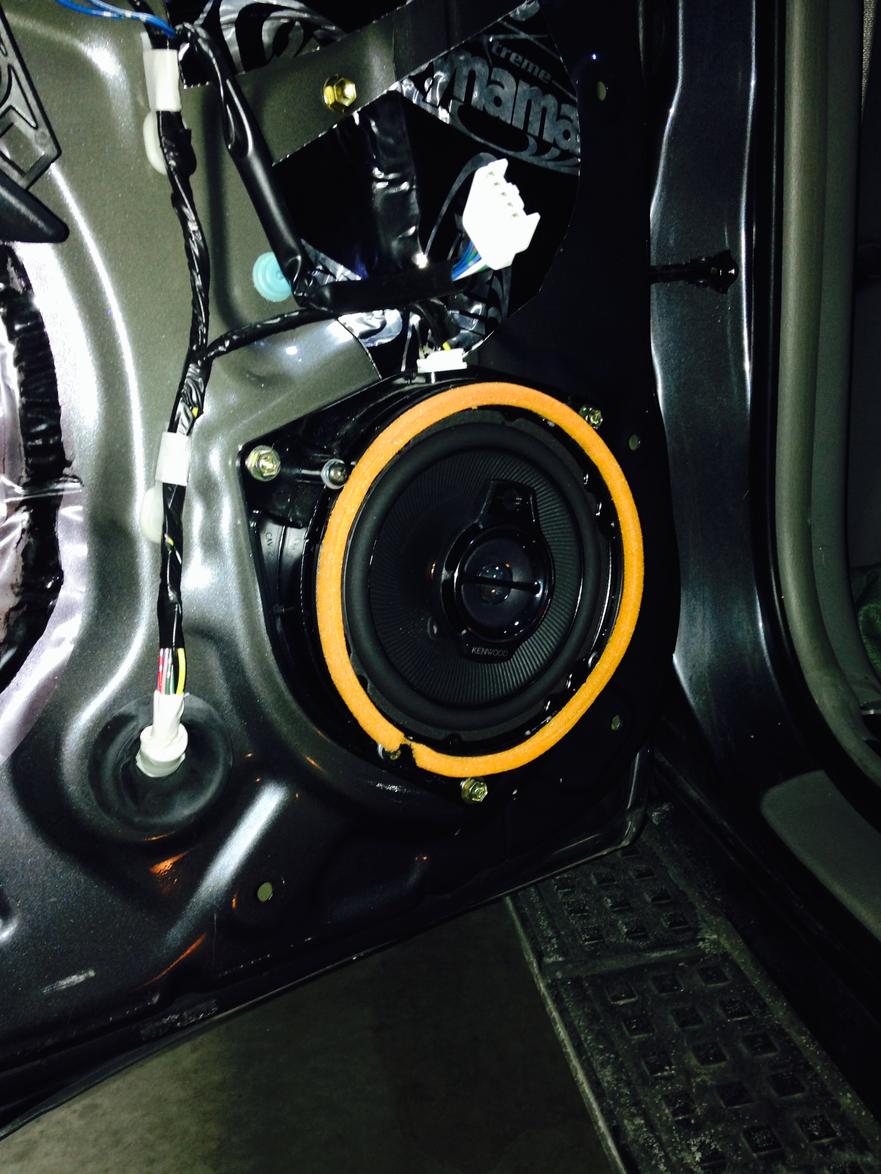

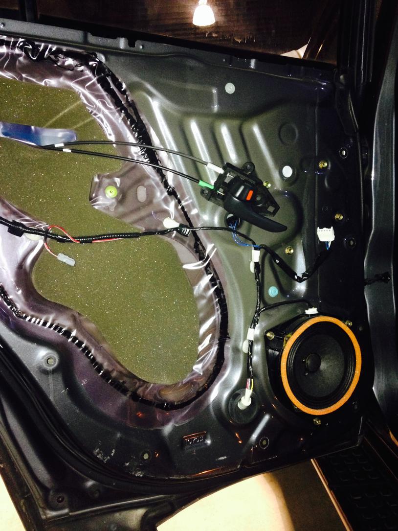

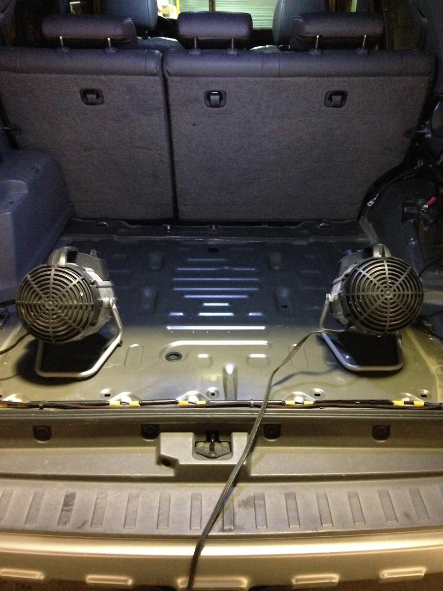

The Bulk dynamat package got me the rear trunk hatch, rear floor and subwoofer area, rear sides and beneath the rear seats, rear doors and front doors. I did not go overboard and stick on every sq. inch of surface area. 30-40% is all you really need and this is not a competition system. On the rear doors I cut the plastic back, cleaned the outer door skin and concentrated there most. The interior door skin I just did the areas above the speaker. I could have made new plates to cover the large opening but I decided against it. It would have taken quite a bit of work to remove the sealant holding the plastic on, measuring and making new patch panels and then installing them for the benefit IMO.

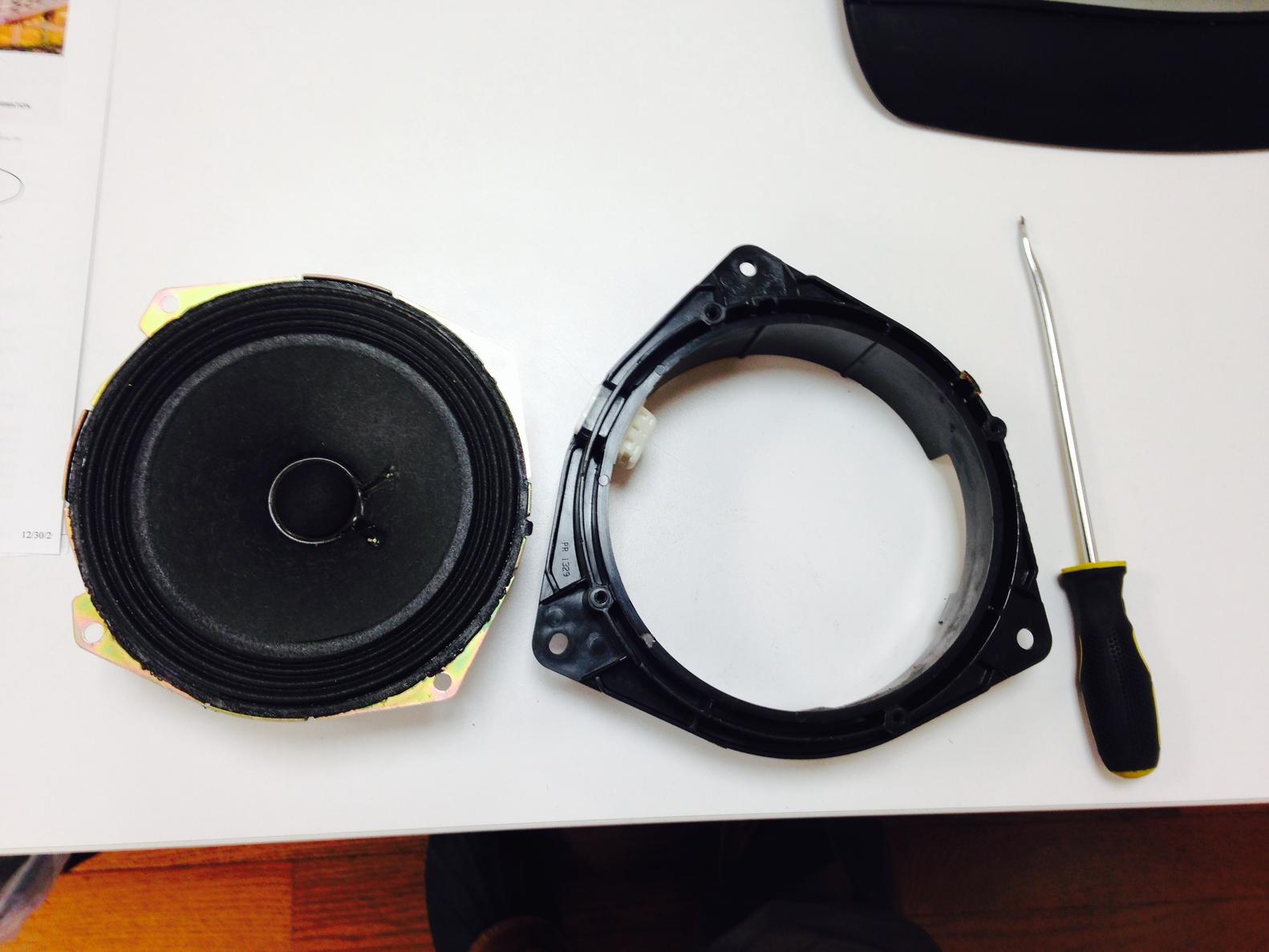

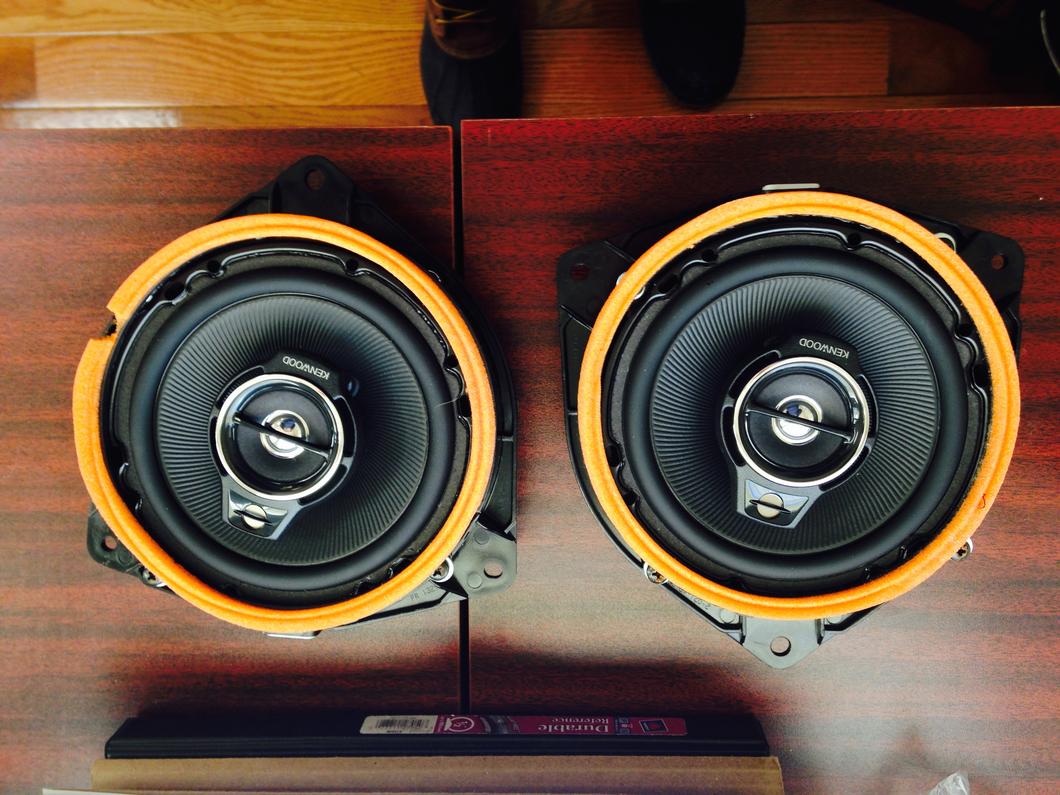

The rear door speakers I was able to reuse the brackets. CAREFULLY pry off the orange trim ring. You will reuse this later. Carefully separate the speaker from the bracket and then mount your new speaker. The holes almost lined up perfectly but I used washers to ensure good connection between the new speaker mounting ears and the screws.
I gorilla glued the orange trim rings to the new speaker and reinstalled in the door.

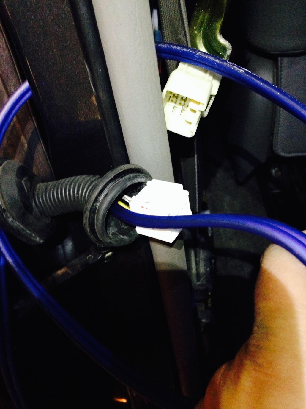

Running the new speaker wire through the door can be done like this link on TacoTunes
Unclip the connector that is inside the door and pull the grommet out towards you. Very easy to then run the speaker wire through the door and then through the grommet.

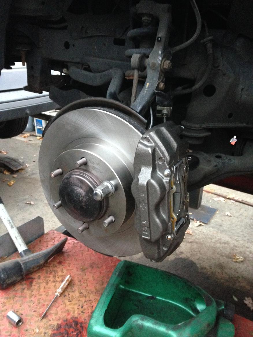

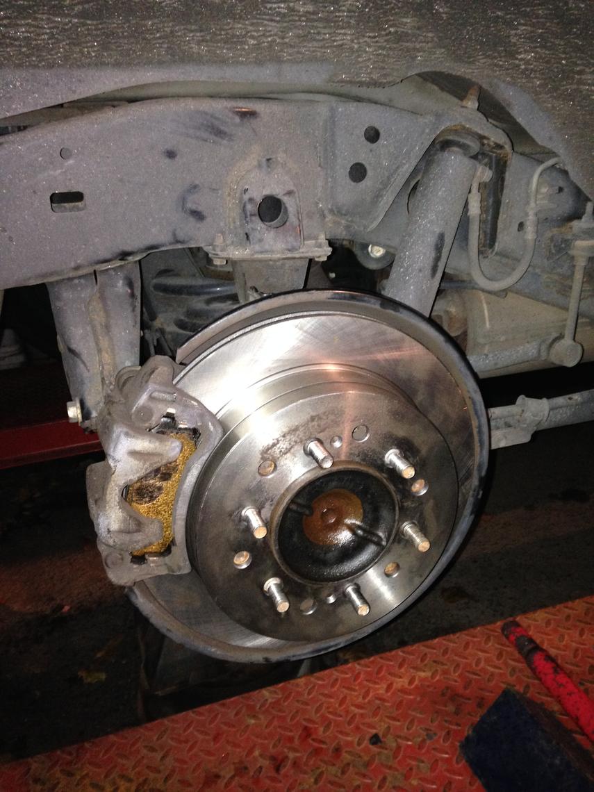

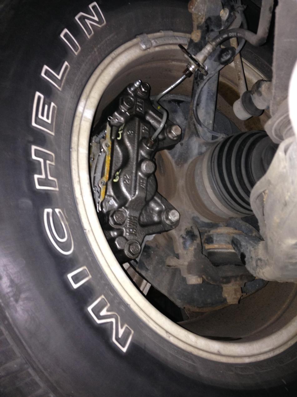

Got around to fixing the annoying squeal from the front driver side brakes. Decided to replace the entire system with new calipers, rotors, pads in the front and new rotors and pads in the rear.
Had my brother (mechanic) pick up all the parts from his store. I did not use OEM original equipment for this, I though about it but decided to save a few dollars and he assured me that the aftermarket was quite reliable in terms of brake pads, calipers, and rotors.
This was the first real maintenance project I did myself. Was nice throwing it up on the lift and having him walk me through/instruct me on how the system was designed and the steps required to do a complete brake overhaul. Amazing the little details that make a big difference (like anti seize on bolts and on hub faces to prevent wheels from sticking and make future disassemble easier). To get the wheels off I had to whack the crap out of them with a dead blow hammer.
Brakes feel much much better. Originals were changed at 70K so it was time to get them done again at 140K. All in took about 3 hours and that included down time for brews and setting the car up on the lift. 1-2 hours is more like it with a good mechanic.

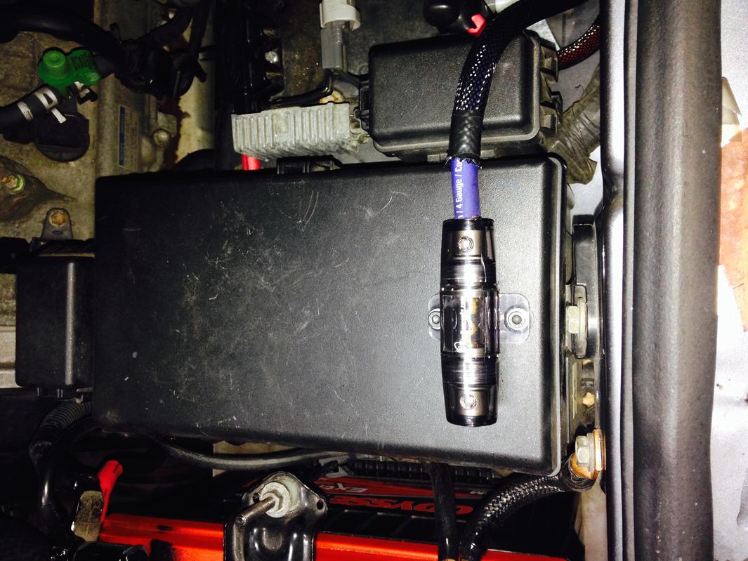

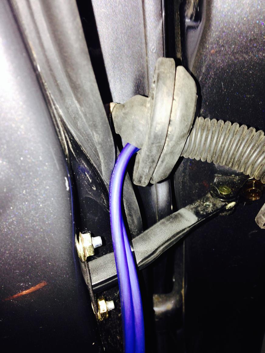

So I ran my power wire down through the drivers side grommet as I already have a 4 gauge power wire running through the passenger side for my rear fuse block, fridge, and compressor. Getting the 4 gauge through this grommet was a bit trickier than the passenger side due to space constraints.
The fuse for the amp is a waterproof one from knukoncepts. I mounted it on top of my fuse box. The wiring is easily run through the chase to the rear. My RCA cables ran through the center console underneath the carpet to the rear. This was a bit difficult but not that bad. I mounted my amp on the rear passenger 40 section seat back. The panel pops off and you can see the seat back has metal sections for sheet metal screws. The amp is secure and tight.

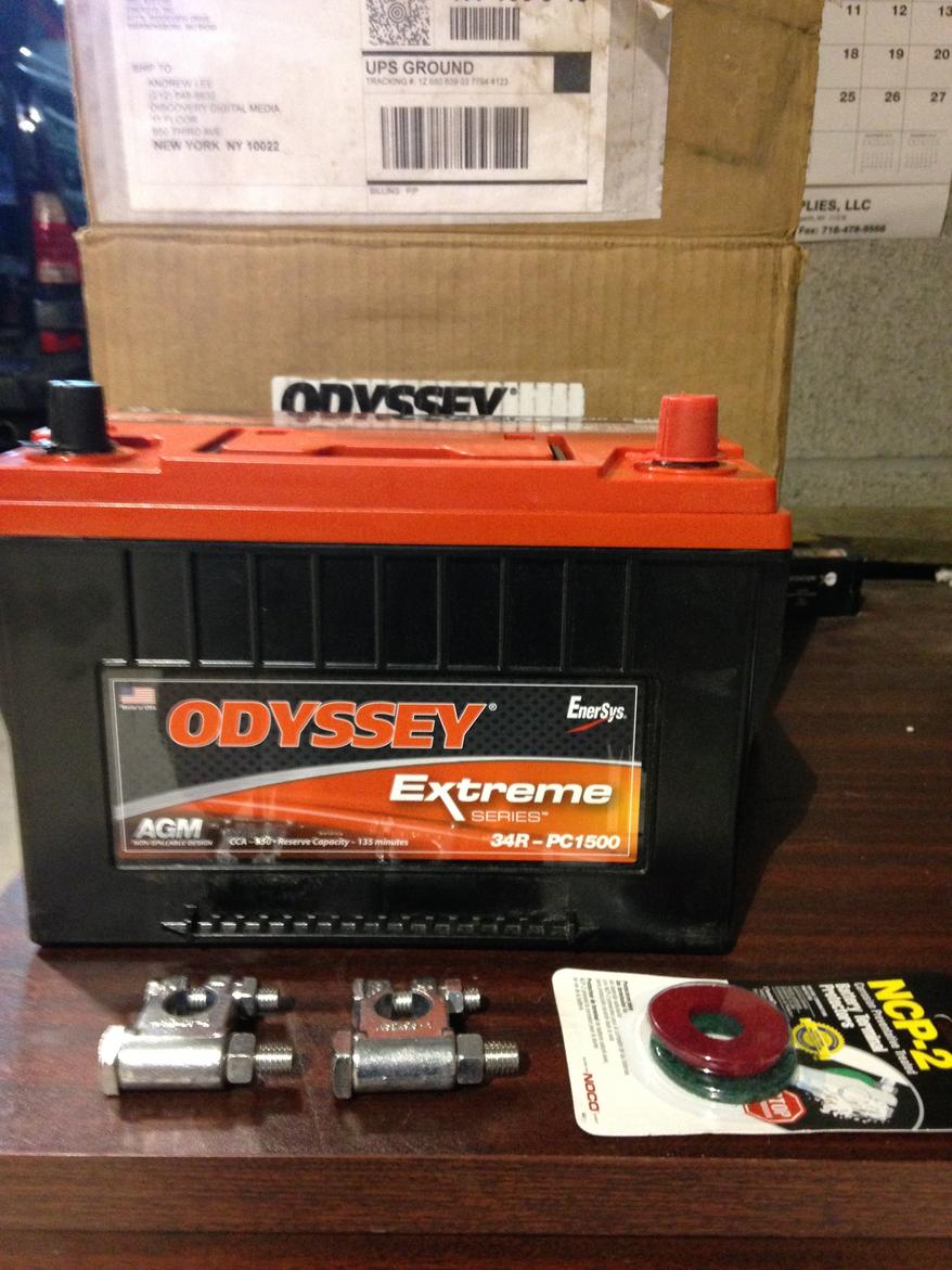

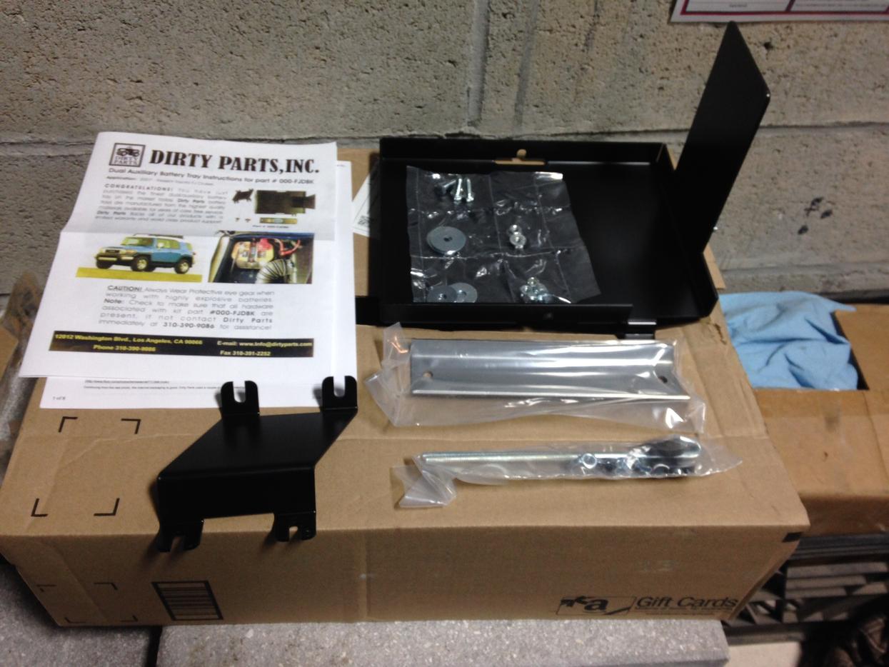

Dirty Parts Dual Battery Tray
Finally got my Dirty Parts Dual Battery Tray in for 03-09 4runners. It is incredible well made and fits like a glove. For instructions I found someone who did the install online and printed out their directions to go along with the ones that come with the kit.
Couple of quick notes
The tray fits up to a group 34/78 battery. Originally I was going to install a Odyssey PC1500 in that spot but once installed I could not close the hood without the hood strut contacting the battery. I could have moved the tray over another 3/4" but then it was dangerously close to the AC hard lines and the dipstick for the oil. If you do move it over you can screw down the front mounting tab to the bolt that holds the stock air box assembly. Using that bolt will get you a bit more clearance than the stock M6 threaded hole that the kit calls for.
Install is super easy, you have to drill 3 holes total and then use the M6 threaded hole that is there from the factory. Once its all installed dropping the battery in becomes a breeze. I did not remove the air box or anything. Now I just have to go buy my battery and put it in. I believe an Odyssey PC1400 will fit just fine as would optima's

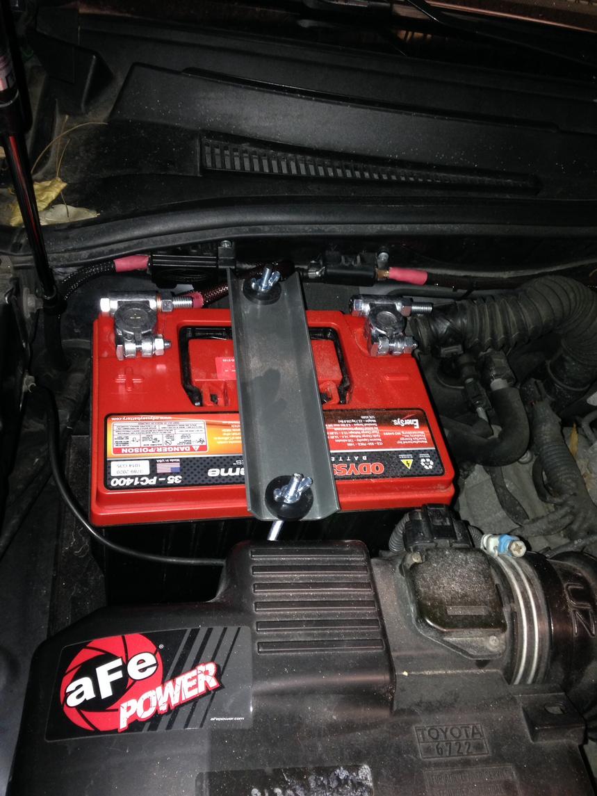

Dual battery tray mounted. Odyssey pc1400 fit perfectly. Taller than a 1500 but but not as wide. Allows clearance for hood and hood strut.

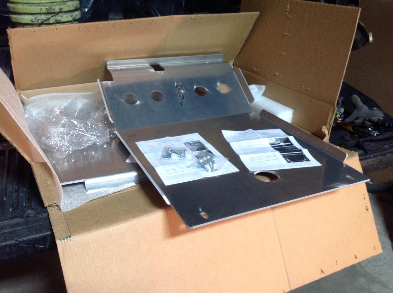

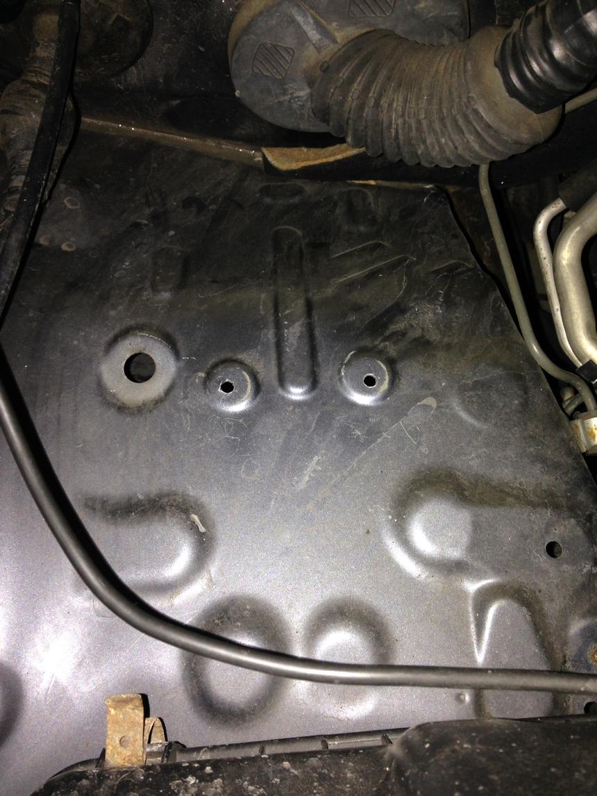

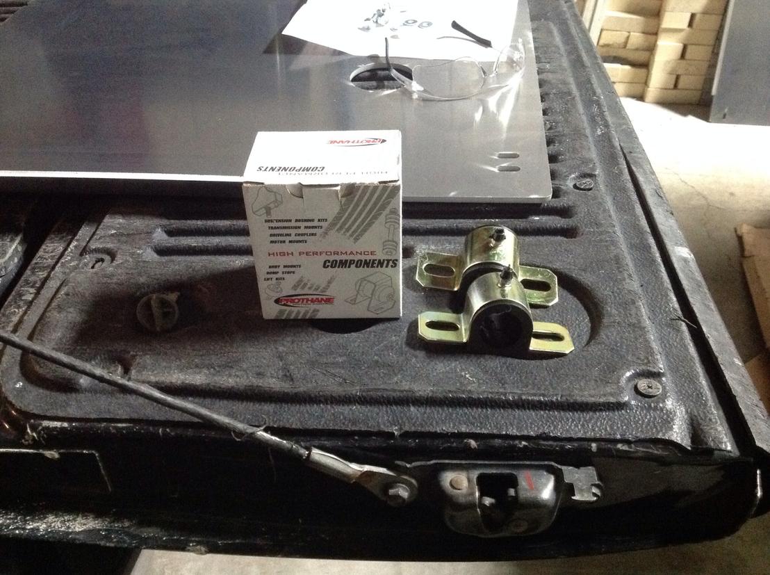

Finally got around to installing my RCI skid plates that have been sitting in my warehouse for the past 2 months. I got the aluminum versions to save weight and not deal with rust issues going forward.
Front skid and transmission skid went together super smooth. No issues at all. Still have to put the transfer case skid in
Also went ahead and did some maintenance while the skids were going in. Oil change, greased zerks, and instLled new front swaybar bushings. Went with grease-able ones from prothane. V8 front takes a 29mm version of the bushing.
thought about flipping the second battery around? i never like the idea of the positive side being so close to the body.
