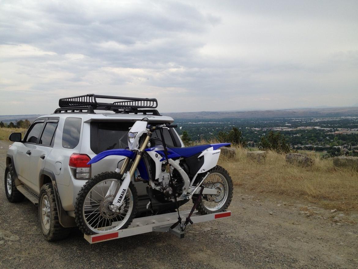

Just picked up this bike the other day. It's a 2012 WR450f and got a AMC-400 carrier from discount ramps. Only $130+30shipping.
Drove it over 500+ miles just to get back home through all types of roads and i didn't notice a difference in handling. Didn't sag much either as my suspension is factory. Very secure for an aluminum ramp.
I have this same ramp and load a KTM 450 EXC on it. Very impressed with build etc. I don't bother with the anti sway bolt down thing and just load and go. My poor bike has been sitting all summer. Anyone looking for a 09 450 EXC with left hand rear brake, rekluse, oversized tank, soft seat, steering damper, LED tails, trial tire on the rear, street legal....etc. $5500. 40 hours and 1250 miles IIRC.
