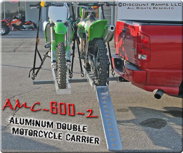

The two carriers I'm thinking about are the Aluminum Rage powersports AMC 600-2 or the Versahaul double carrier. I dont want a trailer due to the room it would take up in my garage. My 2011 Tacoma that i sold to get the 4runner had a much smaller engine, but a class IV hitch and higher towing capacity (I'm assuming this has something to do with the frame and not the vehicle?)

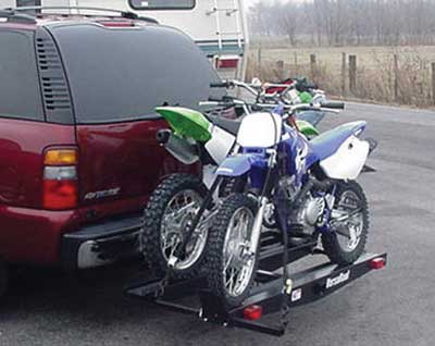

I'm sure what's pictured in the above pics would work but you really would need to install some airbags for added support. I don't know much about dirt bikes but those pictured to me look awful small. I'm wondering if there would be a problem (depending on the size of the bikes) with blocking your tail lights once the bikes are up there. The one downside of this is that you definitely need 2 people to get the bike(s) on an and off. This may sound crazy but I know that I once saw a Titan with a dirt bike mounted on the front of the vehicle. I wonder how legal that is.

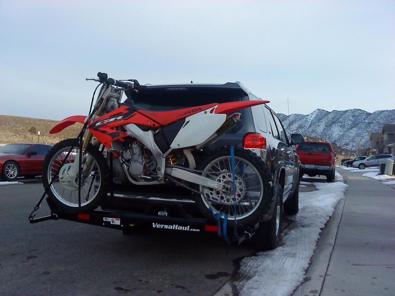

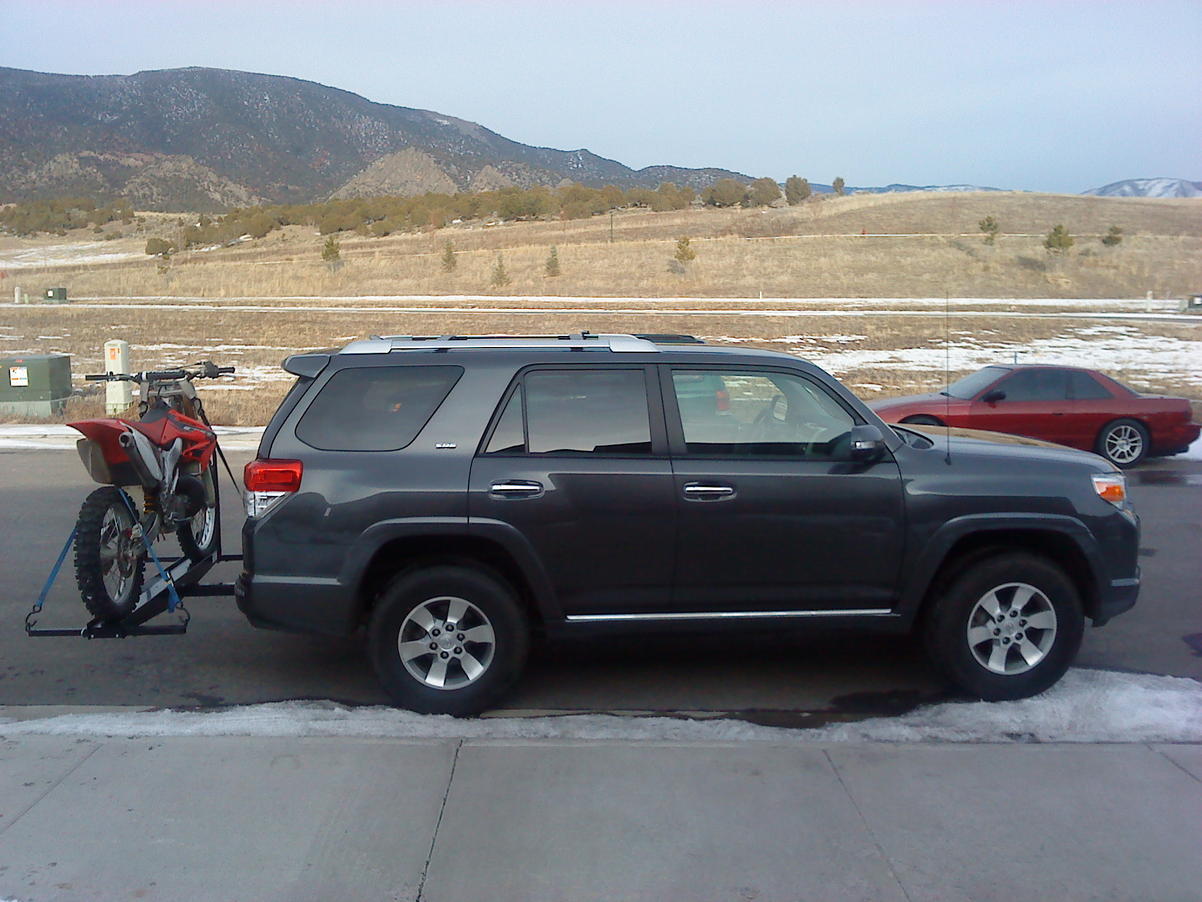

After several months of reasearch, I finally decided on the steel Versahaul. These pics are w/out airbags. Havent driven it on the hwy yet though. Looks kinda of scary, but I havent found any review of where the carrier and or bike fell off. Has anyone else used a hitch carrier?

Nope never used a hitch carrier, always either put em in the truck bed or trailered my bikes.
Honestly that doesn't look scary to me, looks like the Runner is holding up the weight just fine. Speaking of weight what'd you get for a total? Airbags are pretty cheap so if your looking for piece of mind they are probably a good idea.
Glad to see you ditched the idea of a double carrier that would have definitely been scary!
Seen a bunch of these at the tracks around Houston, look like they work fine. Several were toting 450s.
