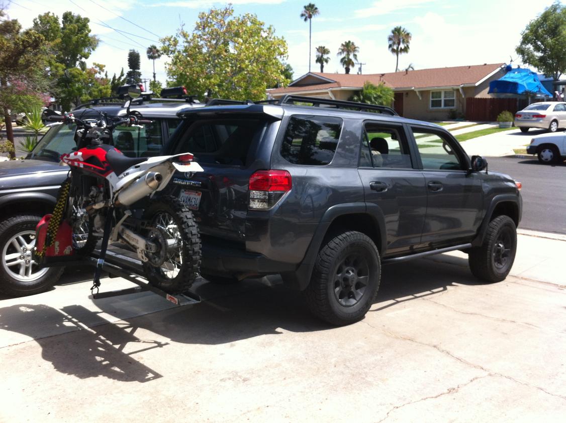

I haul my 09 Husky TE310 with my Joe Hauler Econo Single Hauler. A little pricey at $300 plus, but all steel and welded construction. I feel more secure with it than the bolt together type from Harbor Freight etc. Joe Hauler is a local company here in the San Diego but they have a website www.joehauler.com, I would definitely recommend them.
My 10 TE does fine with the 236 lbs bike and ~ 50 lbs hauler. Even with the toytec ultimate lift, the rear does sag a little, especially after I load the rest of the gear. I do notice the steering in the front is a little less precise with all the weight in the rear. As well the VSC does seem to act up a little bit more when the bike is loaded.
-bh
NOTE: Please disregard the 4Runner setup, it's an old pic that doesn't match the mods in the sig.

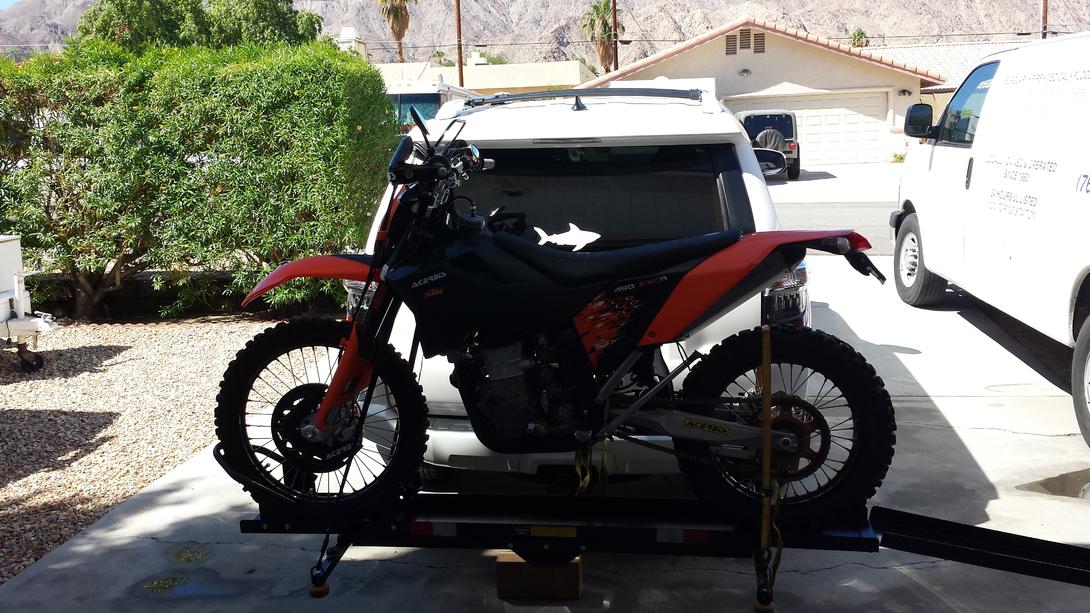

Here the $125 Black Widow hitch carrier from Discount Ramp.
I say it is very stable and does it job. Stable when driving on freeway.
The negative would be the ramp that a bit short making it a bit steep when push the bike up on level ground. I walk it up with engine on 1st gear. It would be easier to use side walk or slope up drive way so the ramp level up a bit to the rail.
I'm 5'7" and trying not to drop the bike made it a real work out. It would be even harder if my truck is lifted. I would get the ultimate MX hauler, I can just jack it right up from the ground.
